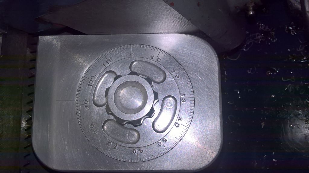

                                        wp_20200619_15_01_09_pro.jpgSome years ago i made a traverse dial for my Harrison L5 , i used the drive gear from the unused thread indicator , then I made a housing to bolt into the same hole as the thread indicator , it can pivot to give the desired mesh with the leadscrew , I see no need for a DRO now as this is pretty accurate and easy to get within 0.05mm and if greater accuracy is needed then i,ll get the depth mic out.
                                        regards Geoff

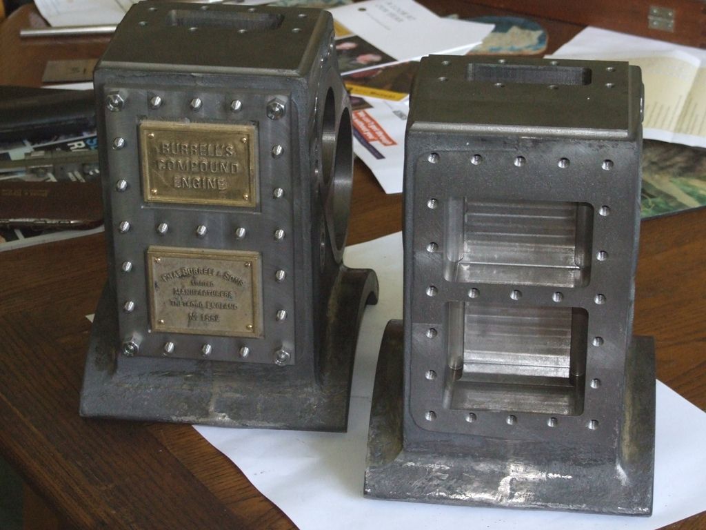

                                          Clive: Thanks for the exposition. When I was looking for a DRO I considered a 3rd axis. But I ended up buying a professional DRO (Newall) and the 3rd axis was a significant increase in cost. That's important when spending ones redundancy payment!
                                          I must do simple machining as I don't miss a 3rd axis readout or a quill scale. I've never needed to drill a blind hole to an accuracy better than that obtainable by visually setting the quill stop. Likewise it's fairly rare that I need to pocket out or mill down to a specific depth with any degree of accuracy. When milling the quill is fully up, locked and never moved. These valve chests were milled to a specific depth (although not strictly necessary as the valve floats vertically):
                                          The valve chest cover face was already machined and set parallel to the table in X and Y. I then touched the tool on the cover surface, as indicated by a fag paper. Set the Z dial to zero and job done. The cylinder is being machined imperial but my Bridgeport is metric. On the drawing it is simple to dual dimension and a few seconds with a calculator gives the number of complete turns and remainder. I machined down in steps, keeping count of turns. Before the last full pass I extracted the cutter and did a sanity check on the number of full turns, as well as blowing the swarf away with a bendy straw. Easy then to do the final full pass and partial pass, leaving about 4 thou for a slow finishing pass. Endmills with radiused corners give a really nice finish. I can't get into measure it but probably better than a micron Ra.
                                          Andrew
                                          Dunno quite how we got here from an M300. My only excuse is that my Bridgeport and M300 are next to each other.
