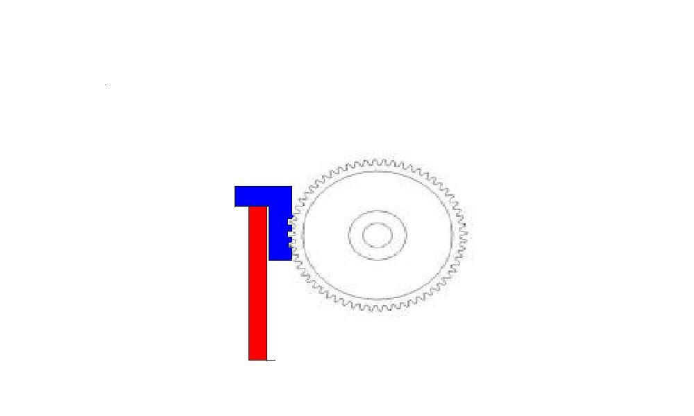

        hth
          @hth
          Oldskool
          It is a common problem with lathes that have been left unused for years . I have had this problem myself .
          The solution I found worked for me . I remove the lid of the headstock, I then use a jaw that I have taken out of a chuck, I use the jaw as a brake, I slide the jaw between the headstock casing and the large bull gear – doing this locks the spindle . The jaw has teeth, the teeth will slide into the large gear , locking it
          #242458
          hth
            @hth
            My bad drawing but you get the idea

                          Thanks everyone for your help, I did what hth suggested and used one of the jaws off the chuck as a brake, the chuck popped off no bother

                              Have you checked the manual for the approved method? I doubt they would recommend removing the lid and wedging gears inside the gearbox. Should be dificult to really jam it on in normal use anyway unless you are doing some unauthorised blacksmith work on it. You could make a sort of c spanner that fits in the square tightening holes and give it a smart tap if you don't like using the chuck key.
