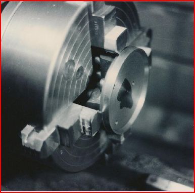

                    #90428
                    Nicholas Farr
                      @nicholasfarr14254
                      Hi Jason, I like the way you improvised, made a much safer and more positive way of holding without too much extra work.
                      Nice looking job, by the way.
                      Regards Nick.
                      #90436
                        Nick this shows the suggested setup, not much grip on the rough cast surface and to get an idea of the chuck dia needed the head is 4.5" dia.
                        Edited By JasonB on 09/05/2012 07:31:50
