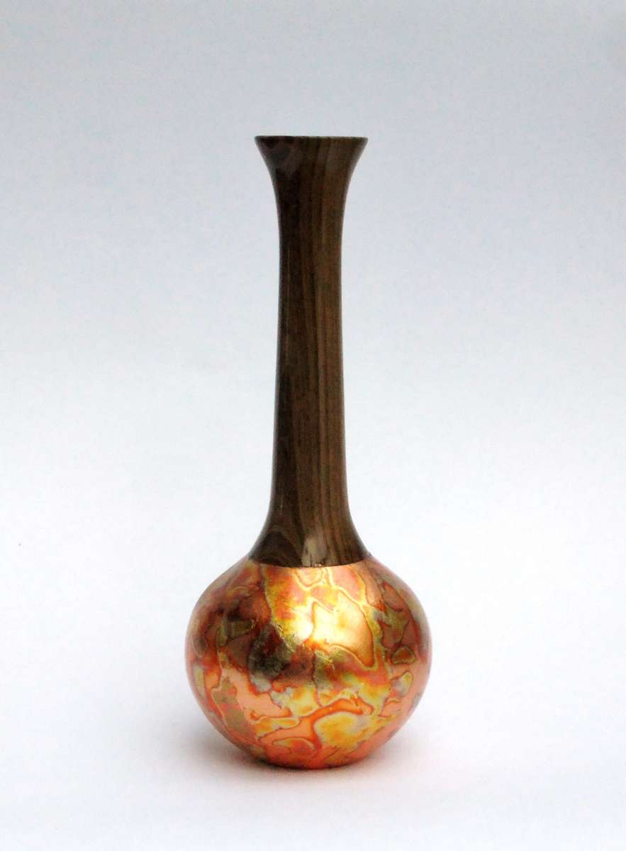

                    #815968
                    Dalboy
                      @dalboy
                      This is a vase I turned back in July 2019, and it is still in this condition now the leaf on this is chemically treated brass effect.
                      I know this has not lived outside but has lasted well.

                        #815979
                        Danni Burns
                          @danniburns84841
                          Dalboy – that is stunning.
                          Is there a guide available for the process for that type of thing?
                          cheers

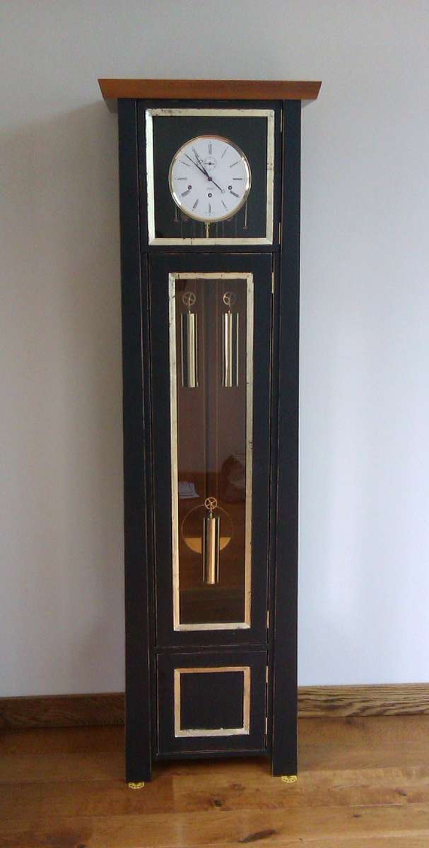

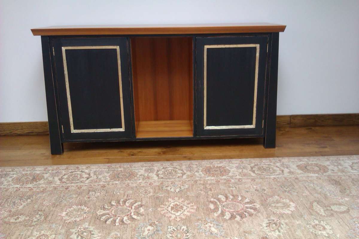

                                If you have not applied leaf before then the “transfer” type is likely to be less wasteful than loose. It has a carrier paper so won’t disappear if you sneeze.
                                This clock and cabinet I made about 12yrs ago still looks as good as the day I made then when I visited teh client recently. The panel mouldings are leafed to give an older distressed look.
                                IMAG1529
                                IMAG1526
                                #816009
                                Danni Burns
                                  @danniburns84841
                                  Thanks Jason
                                  That work is very impressive.
                                  Do you remember how many sheets you used on that work?
                                  #816023

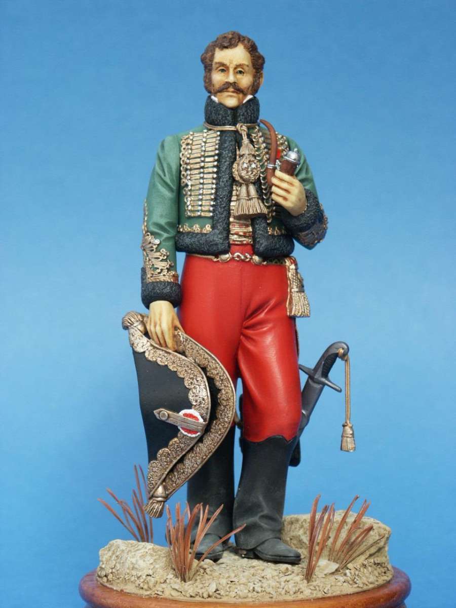

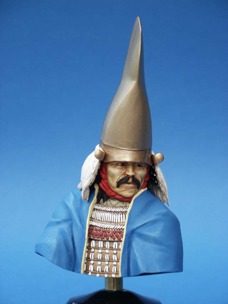

                                    I think I got away with a single book. the beads are about 15mm wide so 6 x 100 per sheet, 25 sheets in a book would be enough for 50ft. The sides of the clock have two similar glazed panels and the ends of the cabinet are also panelled.
                                    You could also consider the metalic gold signwriters paints they tend to have a finer pigment than Liquidleaf. This company is where the leaf and size came from and they do the paints. They also have some how to info.
                                    I also have a liking for printers ink mixed with copal varnish as it is too thick straight out teh tin. very finely ground but not tried it outside, just used it a lot on model figures.
