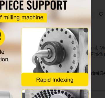

      I’ve just picked up a second-hand, unused Vevor dividing head (this is it listed on my local site, but afaik these things are available from all over the place from Amazon and so on)
      This is the dumbest of dumb question, but: how on earth can I remove the chuck? As far as I can tell it’s screwed into the spindle nose, but if that’s the case it must have been torqued on by an elephant jumping up and down on a 10m bar. Is there a way of getting this off that isn’t going to destroy the entire thing in the process…?

          From the pictures in the advertisement to which you linked, I would say that it is simply a matter of loosening the screws that secure the chuck to the backplate and freeing it from the register.  It might need al little gentle persuasion with a dead-blow hammer to free it off if it’s been standing for a while.  I would be surprised if it was screwed onto the spindle.  I have had a number of rotary tables/dividing heads over the years and I can’t recall any of them having a threaded spindle. (Myford owners will now round on me for suggesting that.)

            Sorry John H my dividing head and indeed the one shown in the link have a threaded back plate [mine has a Myford 7 thread] so it’s just a matter of unscrewing said chuck/backplate assembly. Not an ideal method of attachment for milling! The black grooved collar shown below covers the thread.

              Sorry John H my dividing head and indeed the one shown in the link have a threaded back plate….
              As does my 5″ Elliott universal dividing head. The nose thread is 2″-10 UNS.

                  That’ll teach me to buy cheap, then. Should’ve kept quiet.  As it’s said, “better to stay silent and look a fool, than speak up and confirm it!”
                  In my defence, the OP did ask how to get the chuck off, not the backplate!

                            Thanks, all – there’s a short sequence in one of the linked videos where the chuck is “persuaded” to unscrew that was the source of inspiration.
                            The solution turned out to be warming the spindle nose area up with a propane torch to just-too-hot-to-touch, then cranking down as hard as possible on a right-angled piece of rebar in the jaws and walloping it until it finally gave way.
