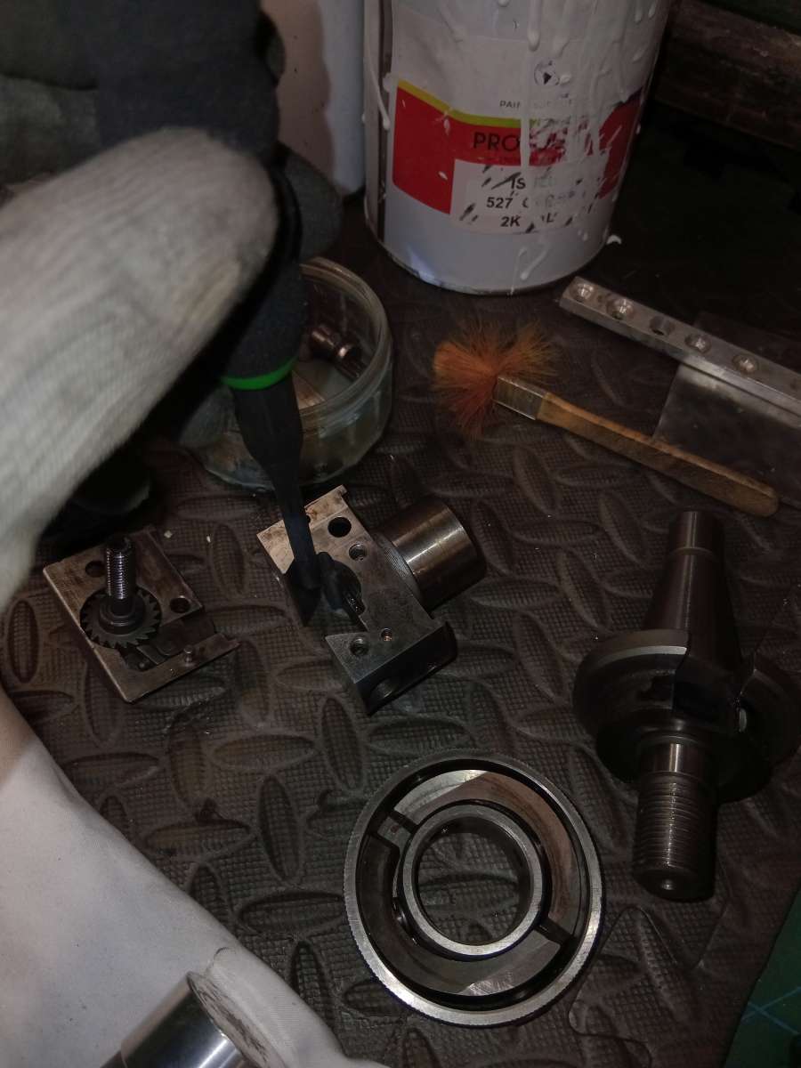

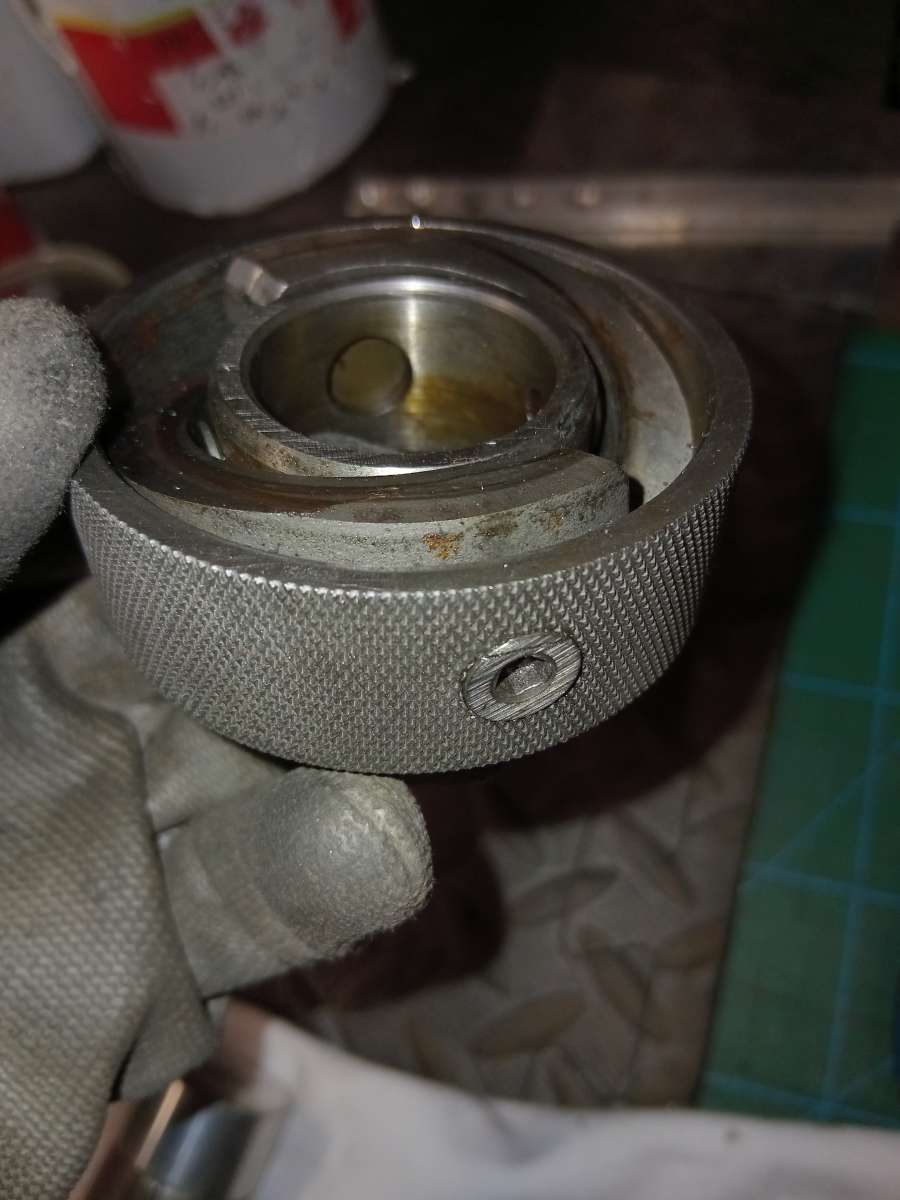

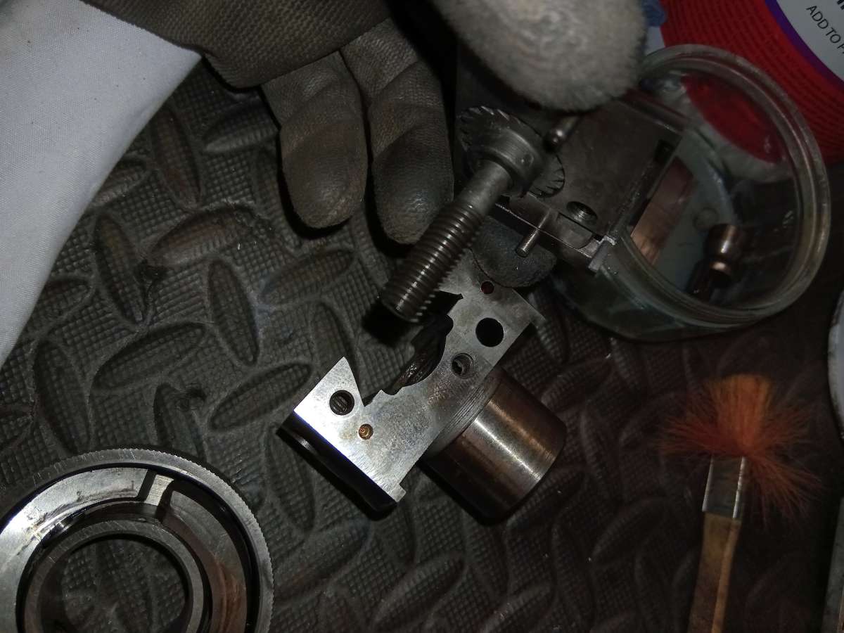

                      @pete-2

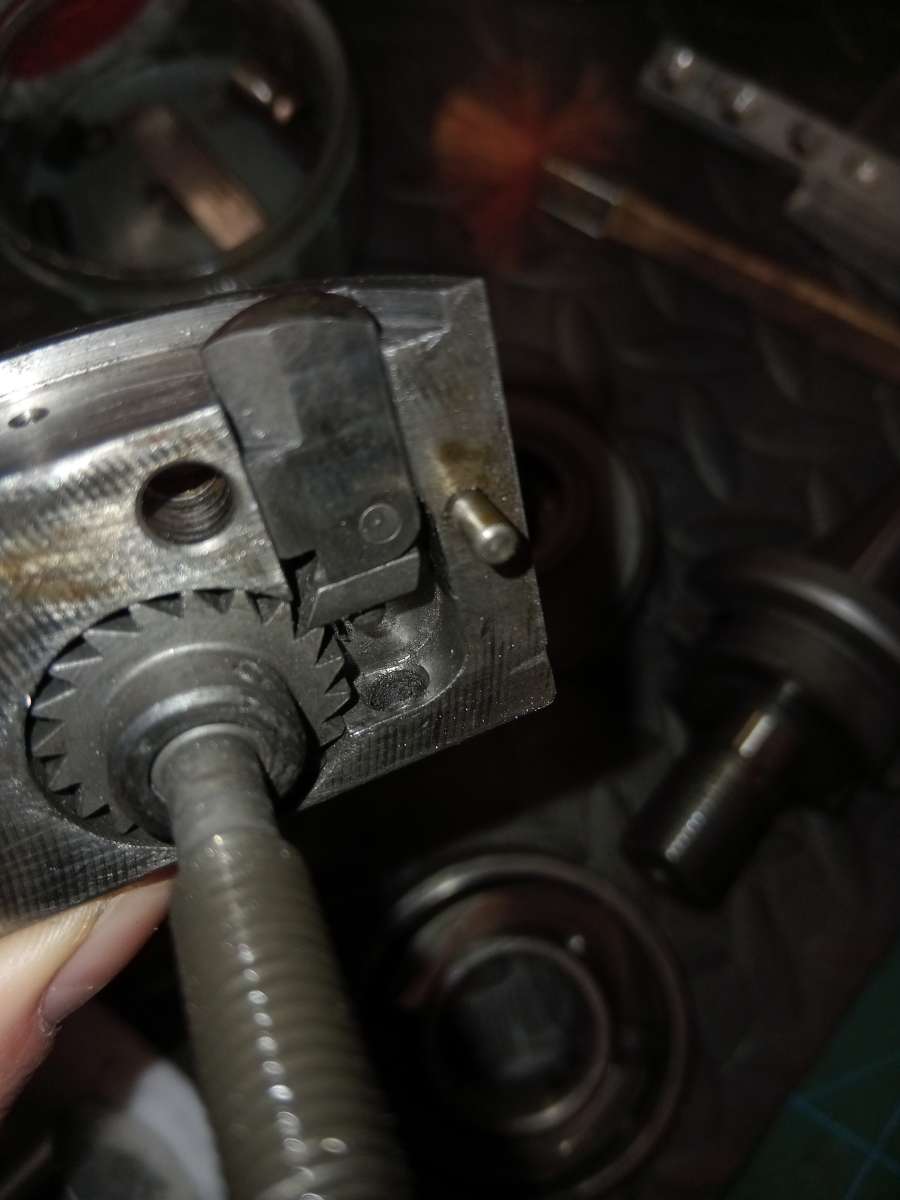

                      I took a look at mine earlier as the auto feed never worked and after not being able to loosen the arbor I just left it but this thread sparked my interest in trying to sort it out.
                      After dismantling it I noticed a small spring at the base of the pawl missing,  about 5mm diameter maybe 15~20mm long, pushing the pawl up manually it worked while rotating although I did come across something I’m not sure about.
                      20251228_20531120251228_20483120251228_20534220251228_20535120251228_20540020251228_20542120251228_210240
                      20251228_210345
                      #830307

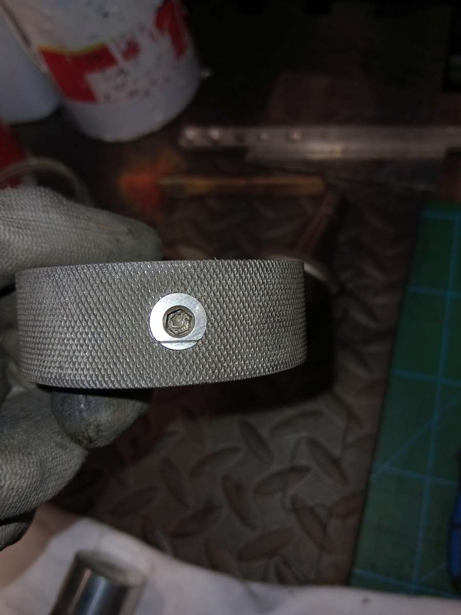

                      Pete.
                        @pete-2

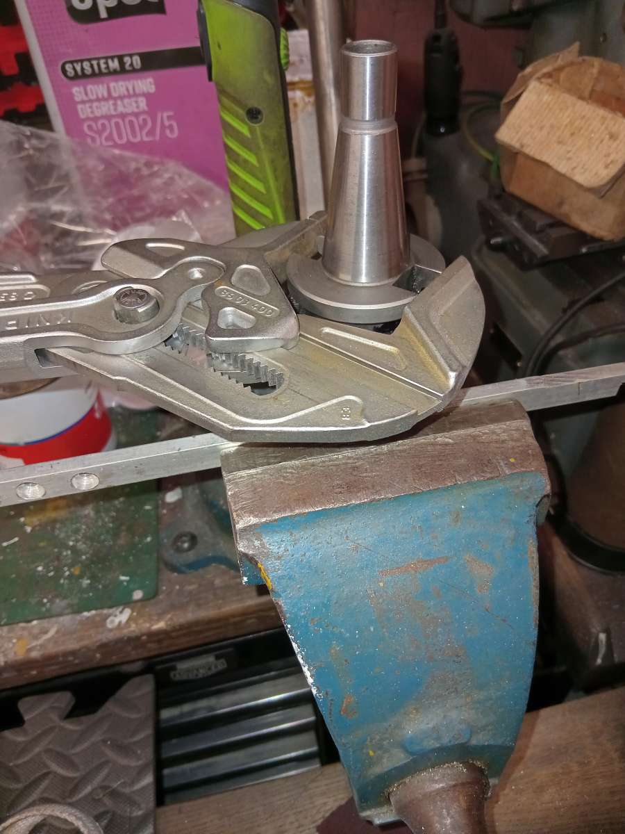

                        If you dismantle the body, it gives you a flat side so you can hold it pretty securely in the vice, luckily I’ve got a large set of pliers wrench which fit across the flats of the cut outs for the drive dogs on the arbor.
                        After removing all the screws the side the body is held on by two dowls,  if you hold a pin punch where sliding ways are (bottom photo) and gently tap it by hand a little each side slowly that comes off pretty easily.

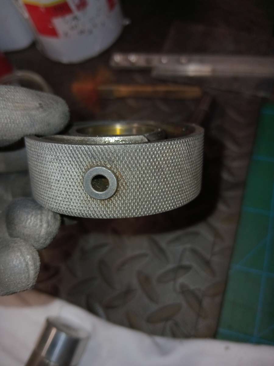

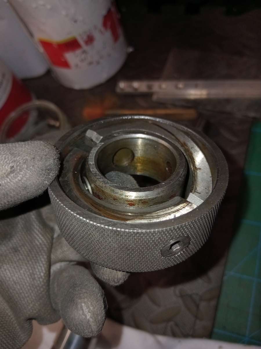

                        One thing that puzzled me was the ‘ramp’ turning the Allen screw on the knurled part raises and lowers the ramp turning the auto feed on and off from what I understand,  but directly opposite there another fixed pin holding the opposite ramp up permanently and seemed to make the auto feed work whether the feed on/off screw opposite was adjusted with the ramp up or down? Is yours like this?
                        #830329
                        Hollowpoint
                          @hollowpoint
                          Yes it’s the same. I believe that the pin with the hole is for use with a long tommy bar which rests against the column of your mill, so you don’t have to hold it.
                          The “on off screw” isn’t actually on and off. It’s 2 feed rates. On mine the first position is 1 click per revolution (0.05) and position two is 2 clicks per revolution (0.1).
                          So the ramp in the permanent up position must be 1 click and then adjusting the screw lifts the second ramp to give 2 clicks.
                          Hope that makes sense.

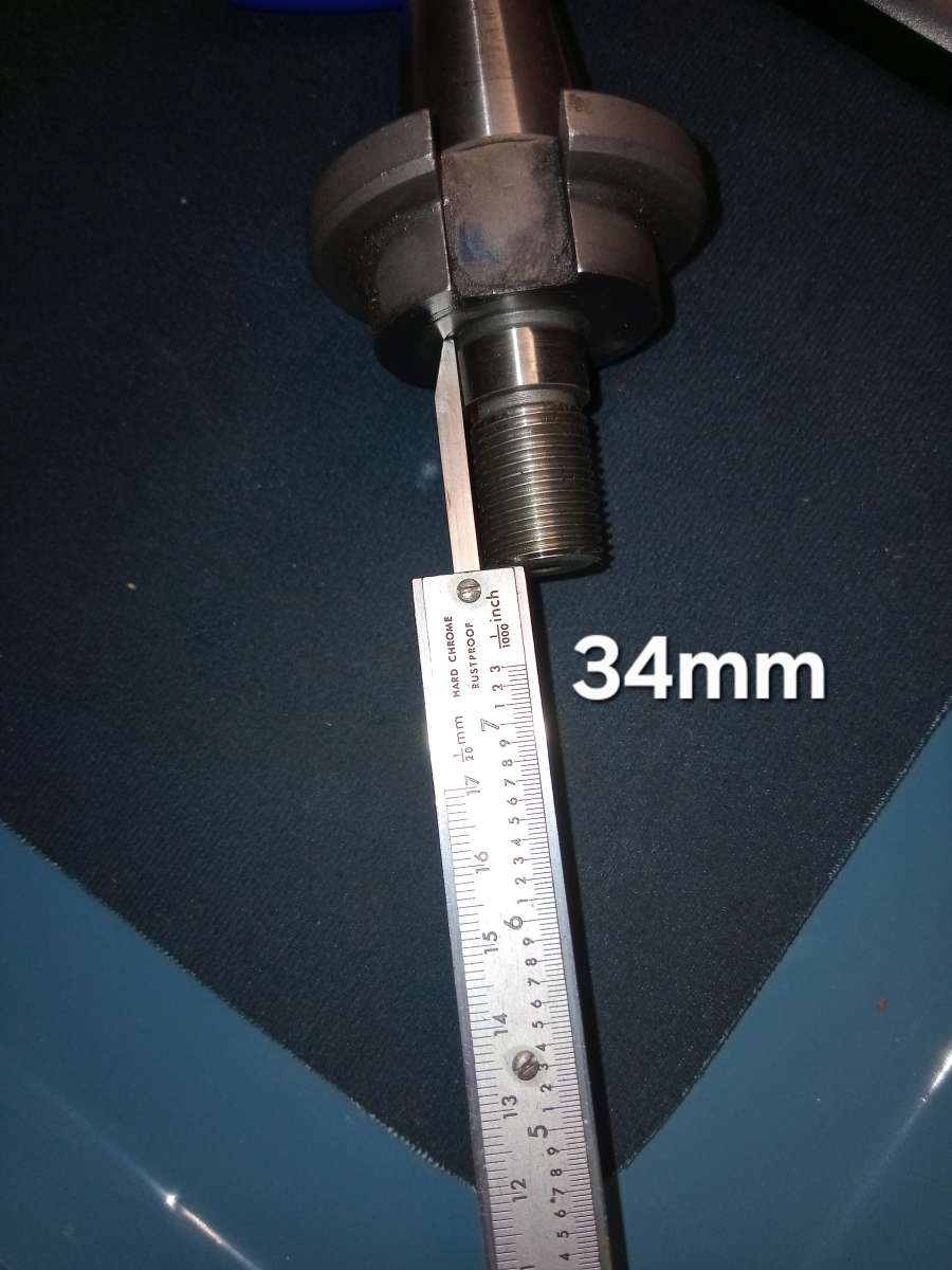

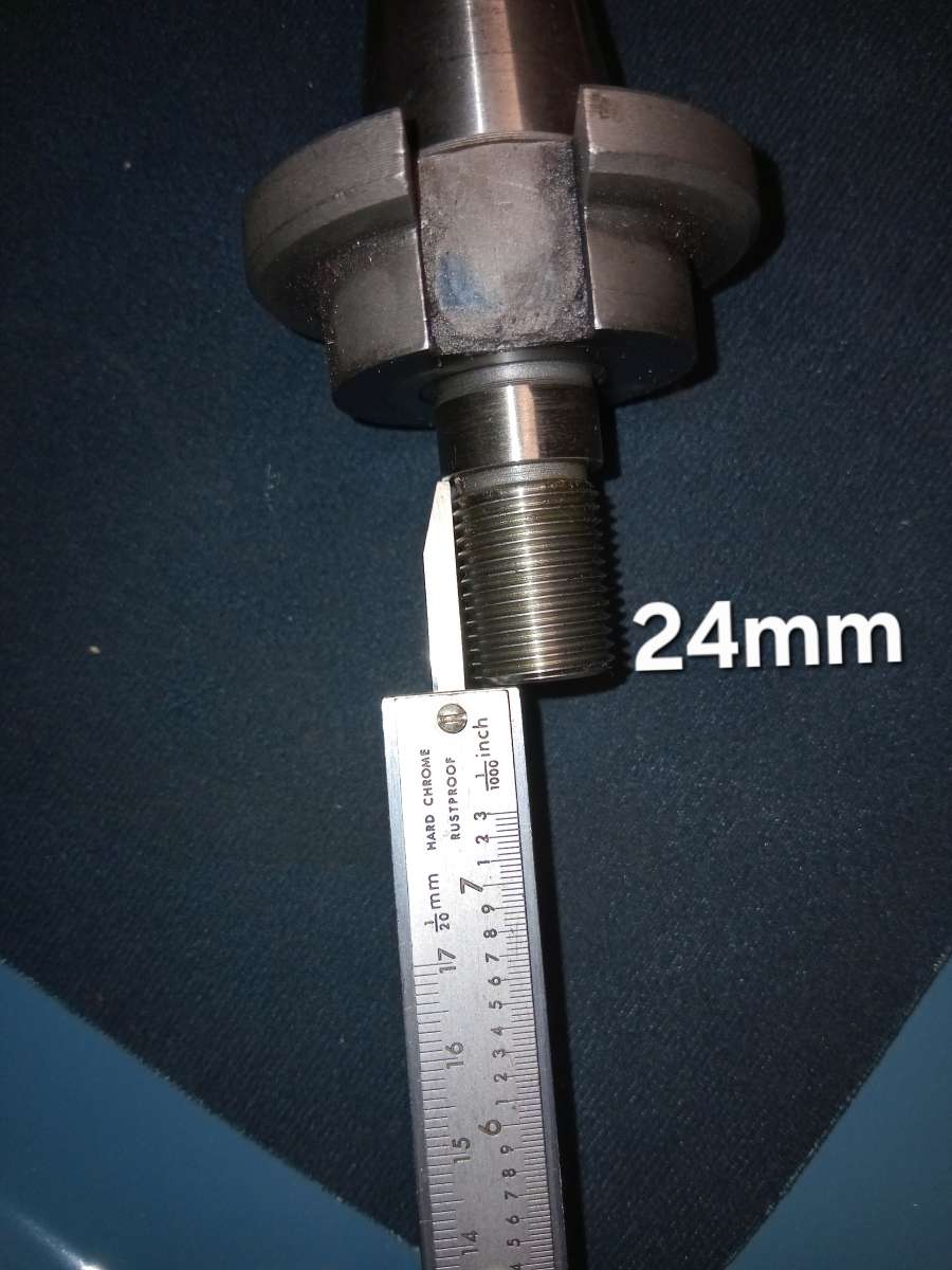

                            While it’s appart, could you measure the thread for me please? Just the length from the end to the shoulder will do.
                            I want to know if the soft arbor chronos sells has enough “meat” at the end.

                              Ye sure I’ll check the length later.
                              I did wonder about that but thanks for confirming the ramp switch just changes it from one pawl movement per rotation to two, before I took the arbor off I looked in and wondered if it’d been crashed and jammed one ramp up or something,  I’m glad it hasn’t been.

                                20251229_16272220251229_162637

                                  Perfect! Thank you. Much appreciated. 🙂👍
