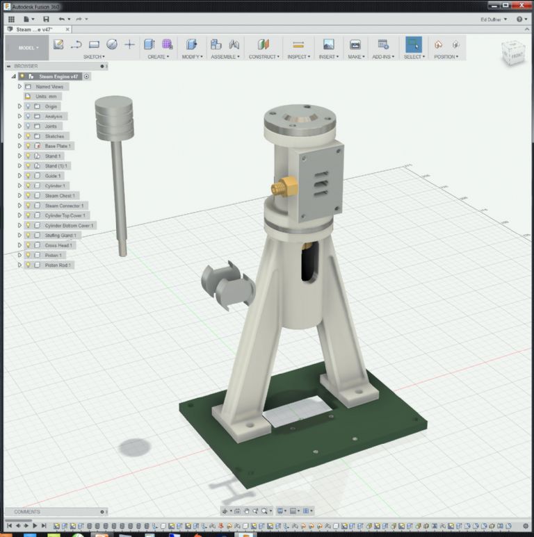

                    I've been using it for a while now and in the past few days to build a 3D model of a stationary engine, although there do seem to be errors in the original plans (I'm not complaining, they are free after all). Still some way to go.
                    Ed.
