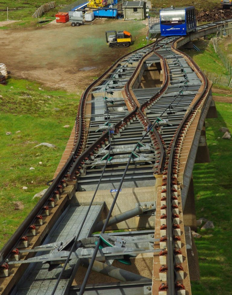

      I was intrigued by the passing loop on the Cairn Gorm funicular railway. The passing loop has fixed points at each end – an advantage to have no moving parts in icy conditions. But how on earth do they work? If the wheels on the vehicles are flanged, then surely they'll derail, and if they're not flanged, they'll fall off! Anybody know?

            This type of funicular carriage has double flanged wheels on the outside rail, and unflanged wheels on the inside, point-side, of the loop, and so are guided by the continuous outer rail of the loop. So, the two carriages are (obviously) mirror images in this respect.

                It's a funicular: there are only two carriages. One goes up pulled by the cable, as the other comes down, in balance. They have double flanged wheels on the outer side of the loop, one carriage on the left, the other one on the right. They don't need to be turned, as they never come off the end of the cable The track is constructed to feed the cable around the correct side of the loop as the carriage comes down to it., as the photo shows.

                  P.S. There is a trailing cable running down beyond the carriage, but as you can see in the photo, this is much thinner than the one which carries the load.

                      Cheers, guys! It's obvious when it's explained! Like Richard, I assumed that the cars would use one side of the loop going up, and t'other one going down, as per normal railway practice. I had done an Internet search before submitting the question, but for some reason I never found the Wikepedia entry Martin Millener shows.
