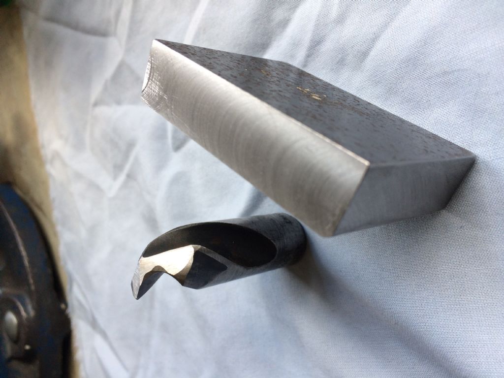

      Having made a fly cutter some time ago I put it to use squaring off the edges of some 5/8” thick mild steel. The cutting edge of the 1/4” round tool soon needed sharpening and it was tricky to grind an effective edge on it. It was then that I found an old 17mm drill which had been butchered at the point and the shank. I cut it short with about a 45 degree angle I then ground a shallower angle and some rake to give a cutting edge. I also cut the shank end short. It looked very crude after this attack with the angle grinder but I thought it was worth a try in the lathe. I was amazed how well it cut, it seemed to have a shearing action rather than chipping the surface like my old fly cutter. I will try to post a picture of my “Tatty tool” and the surface it produced. The lathe was running at approx. 230 rpm and I was taking about a .012” cut, although I did a couple of .020” cuts which went just as well. I am always surprised by the quality of the surface produced by fly cutters anyway, but I was well chuffed with this little bodge up!b39d64ca-a326-42ca-b9a4-294b22064c7a.jpeg

          That's good use of an old drill. Broken HSS drills make useful tooolbits. I made a couple of boring bars that work well, a bit smaller than yours though.
