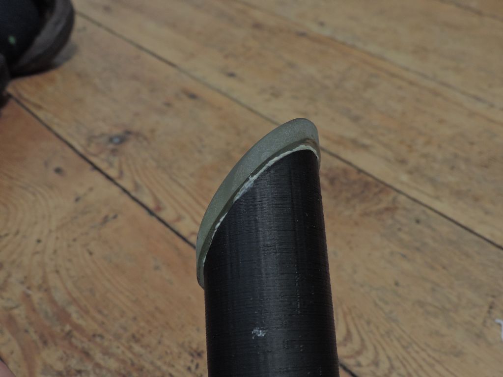

                                            Aquarium silicone which is free from nasties is popular for telescope mirrors but I have used EvoStik mirror adhesive, that includes a 10" diameter by over an inch thick mirror, and secondaries comparable to your flats.
                                            I would do something to ensure a good mechanical bond to the aluminium, such as multiple holes.
