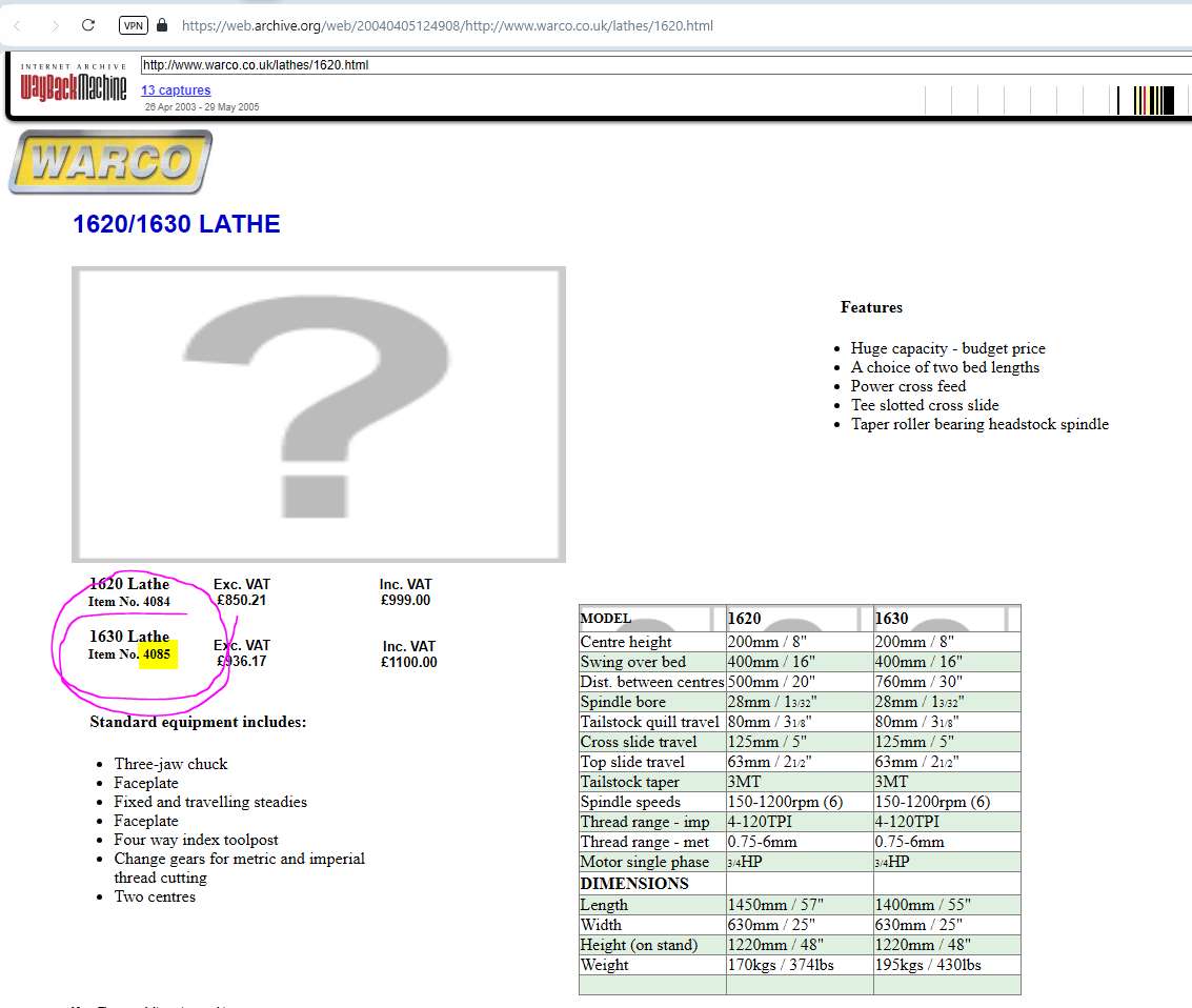

          peak4
            @peak4
            You’re looking for a lathe Warco listed about 20 years ago, and stopped selling in 2005 by the looks of it.
            Internet archive doesn’t have a photo from their web site; I’ve tried all dates
            It seems to be different to the 1640ZX by more than just bed length.

                peak4
                  @peak4
                  Sorry Howard, I’m not convinced it’s that easy, unless Warco are able to assist in some way.
                  No search engine I’ve tried comes up with either a manual, nor a photo of the lathe under either of the numbers, just the page screenshot I posted above.
                  Internet Archive of Warco’s site(s) seems to give the years of sale; about 2004-5.
                  A appreciate that Warco advertised in more than the Model Engineering press, and this is a larger lathe, likely 8″ centre height, but I didn’t spot an advert for it in ME, MEW or EIM for a 3 year period centred around then; maybe there was and ad in the motorcycle or classic car press.
                  If someone can come up with a photo, one might be able to compare with Grizzly manuals, though even that is more difficult than it used to be without a model number.
                  Is it a full gear head, or a changewheel machine?
                  Bill

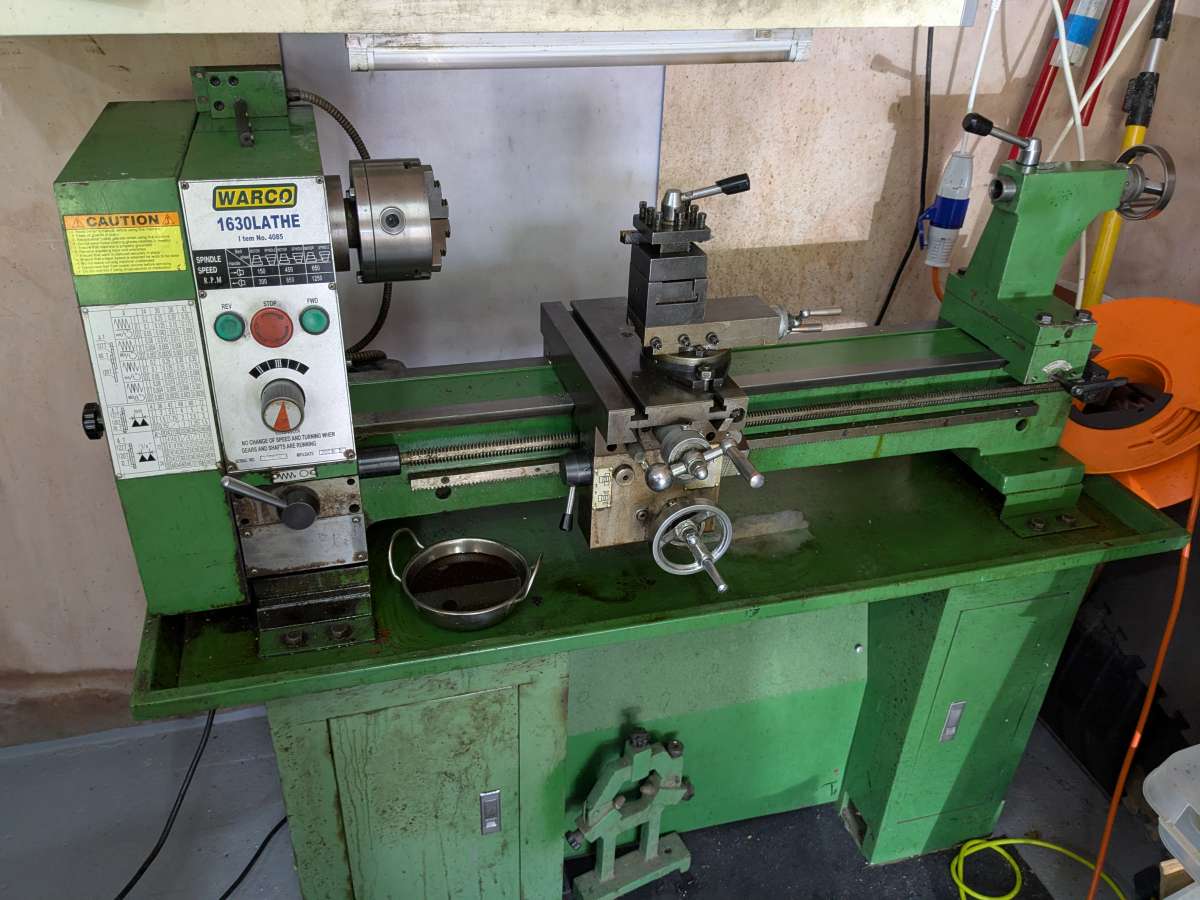

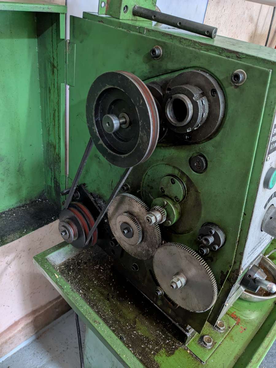

                    john fletcher 1
                      @johnfletcher1
                      I have recently received the enclosed pictures., I hope they will be of help to identify the problem. Sorry for the delay and please note that Item 4085 is part of the lathe description NOT a component part. Many thanks to all respondents.  John
                      Adams Warco latheAdams Warco  lathe 2

                          Howard Lewis
                            @howardlewis46836
                            The motor pulley has three sheaves, so you would expect the smallest sheave to run the belt onto the largest sheave on the driven pulley, and the largest sheave on the motor pulley to run the belt onto the smallest sheave of the driven pulley.
                            Has the “pull out” knob got a keyway? If it has, maybe the driven pulley is expected to float, and to be aligned by the belt on the sheave of the motor pulley.
                            A copy of the relevant page from the operator manual would clarify matters.
                            Howard
                            #800149
                            Howard Lewis
                              @howardlewis46836
                              If the pull out knob is expected to move a gear or gears within the Headstock, then something is broken,  or loose within the Headstock, and the only way to be sure, and to rectify this, is to open up and investigate.
                              Rectification will involve a certain amount of stripping, which might mean either using the machine as it is to make a replacement part, or stripping, measuring, reassembly and then making the replacement part.
                              Only opening up will answer those questions.
                              Without the full range of speeds, the machine will be rather limited, having only three (belt) speeds instead of the two speed High/Low range provided by the gears within the Headstock
                              Have a look and tell us what you find, (preferably with pictures / dimensions) and then you are likely to get advice and help on how to cure the fault

                              Peter Cook 6
                                @petercook6
                                Looking at the speed plate on the front panel, it looks as if the three sheaves on the pulley set give a set of input speeds ( the belt is currently on the middle set). The pull out knob seems to select the ratio in a a two speed gearbox that drives the spindle (currently pulled out to give the higher set of speeds(?).
                                It would be interesting to know what happens when the knob is pushed in. Is there no drive to the spindle, the speed doesn’t change, lots of nasty noises or will the knob not move?

                                  @peak4
                                  The more I looks at this lathe, the more it reminds me of the combination Lathe/Mill machines; Clarke amongst others still sell something similar.
                                  As I recall, some were available as a lathe only; Compare with one of the combos, as regards over-height tailstock, and spacer on the top slide, bed shape, lever or knob in the middle of the headstock, etc.
                                  I’m not sure what’s being referred to here as a pull out knob, but the three position rotary knob on the front of the headstock, might be related to doubling the feed speed, rather than the spindle speed.
                                  Have a look at this Grizzly manual, and you get the general idea; Page 22
                                  https://cdn0.grizzly.com/manuals/g4015z_m.pdf
                                  I’m guessing that the push/pull lever, is that gizmo on the centre of the V belt pulley.
                                  Could it be something as simple as needing to position the knob on the from to the headstock on the correct place, and rotating the chuck by hand, to get some drive dogs to align?
                                  Unlike the manual above, this only seems to have 2 pulleys, which don’t themselves slide, as per fig 15

                                    Dave Halford
                                      @davehalford22513
                                      Looks too me like three  speeds via a belt and 3 sheave pullies + a high / low back gear for the 3 lower speeds.
                                      Best result will be caused not turning the chuck by hand whilst moving the knob.
                                      Worst result will be failure caused by engaging high / low with the motor running.
