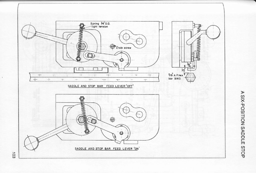

              Chris
              Multi-position stops are very useful in their own right, my own six position one gets a lot of use, but when it comes to screw-cutting the dog clutch is far better than any half-nut opening device.
              Grahams version is well engineered and known to be effective. It just works. Time to roll up your sleeve and build one.

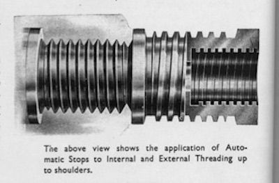

                  Incidentally, Millhill Supplies stock Ainjest units for Colchester and Harrison (only) lathes, but judging by MS' web-site photos, whether suitable for early L5s like mine is another matter. Probably at prices that make the virtues of patience and care in manual operation rather more valuable – and virtues are free! The publicity gives as example, large BSP internal and external threads on an aluminium-alloy fitting; 5 passes each, >1000rpm.
                  However, their illustrations usefully show that the Ainjest uses only the lower half-nut, of bronze, apparently controlled by vertical guides and snapped clear of the lead-screw by a pair of springs. So making an attachment on those lines, but simpler and designed to fit a Myford, may be feasible. Though I'd make the half-nut move upwards, to help avoid it clogging with swarf.

                    I cherish the ambition of making the Graham Meek version.

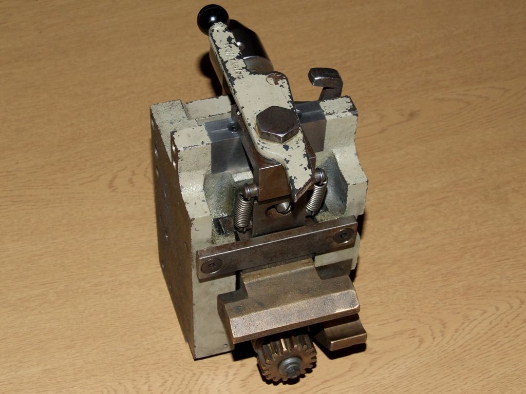

                      The Ainjest has this repeatability built-in, but is for threading only, on lathes with separate feed-shafts.
                      As it happens my lathe has a separate feedshaft, but I don't see why an Ainjest unit wouldn't work as a fine feed with trip on a lathe with only a leadscrew.
                      This shows the internals of an imperial Ainjest unit, looking from the back and with the unit upside down:
                      As stated it uses one half nut, working against a plain guide to counteract the radial forces inherent in Acme threads. Being an imperial unit it has a single gear meshing with the leadscrew – metric units have a cluster of gears which need to be changed according to the thread pitch. Here is the unit installed, with the trip bar annotated:
                      The unit was dead easy to fit as all the holes in the bed and saddle were pre-drilled and tapped at manufacture. A little known advantage of secondhand industrial over new far eastern. smile
                      The trip mechanism is very repeatable, for internal threading I let the unit trip, move the tool into the hole to be threaded until it bottoms, only using the topslide, and then back off 4-5 thou and lock the topslide. Fingers crossed I haven't had a crash yet.
