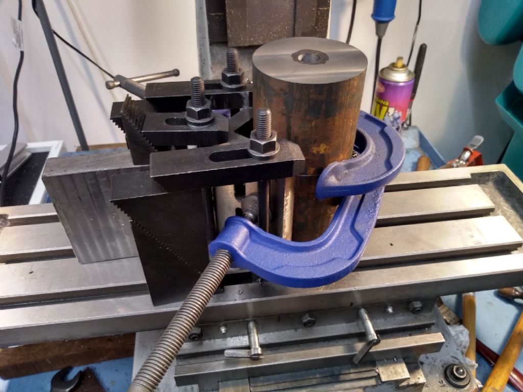

      This arises because I got involved with a project to make a riser for a VMC mill as detailed in another thread . It got me thinking. How does one turn the faces of a bar parallel?
      The inimitable doubleboost just turned the piece end-for-end in the 3-jaw. I tried that with with a 4" diameter billet, making sure the workpiece was referenced to the flats on the jaws rather than the grippy bits. It turned out about 0.03mm out of parallel across 100mm. Not good!
      I'm wondering if it can be done better by bolting to a faceplate which could be skimmed before attaching the work?
      Robin

          No need to skim your faceplate unless there is something measurably wrong with it. You could ruin a good plate.
          But yes it's more reliable to bolt to faceplate to get faces parallel. Holding in the 3 jaw by a relatively small area can allow movement under load. Or bits of swarf or even duff chuck jaws can throw it out too. And always tap the the job home carefully with a brass hammer to make sure job is seated on all jaws. A 4 jaw would give better grip than a 3.
          #489562
          Hopper
            @hopper
            PS. But the faceplate method can mean you end up with the two ends parallel to each other but out of square with the outer diameter. This happens if the first unmachined face bolted to the faceplate is not square to the OD to start with — as is common with power hacksaw cuts on stock. Probably for a riser, the OD is non-functional so won't matter if it is not square to the faces.
            If you want to get the OD square to both ends and both ends parallel, the best way would be careful set up in the four jaw. Get OD running true at both ends and job seated firmly on all four jaw steps with a brass hammer. Then carefully machine one end. Then either flip it around and do the same again or use the faceplate to do the second face.

                1st to check, is the cross slide actually square to the run of the lathe. Some are not and are not adjustable in any way to make them square. Which is why on some older machines, you need to set the compound to get a flat face.

                    As you were using the outside jaws and the work was not back against the chuck it would be easy enough to get a dti onto the previously faced now back face of the work to check it for true running. Only tap the work back against the jaws if you know they are totally true.
                    Regarding hoppers point about ends not parallel that is easily solved by taking a cut off the OD at the same setting when facing the first end.

                                      Turn it between centres and both faces will be parallel with each other.
                                      Face the tailstock end first, remove part from lathe, refit back between centres with faced end now located at headstock. Face the tailstock end. Job done.

                                        I would simply rough out somewhere near size and centre each end with a protected, or recessed centre. Drill and tap at one of the mounting holes on each face for a driver peg. Then mount the work between centres to take a light skim down each face and over the O/D if desired.
                                        This does assume that the lathe is already set-up correctly.

                                                Thanks for replies. I understand that milling is the 'natural' technique for making the ends of a bar parallel, but for various reasons it's not an option here.
                                                Several good ideas for doing it on the lathe though – I'll experiment. I think Martin's / Gray's suggestions of turning between centres will be the first experiment – it's a technique I've never used, so it'll be fun and seems to be guaranteed to work – provided the lathe's set up correctly of course!
                                                Good to hear that 0.03mm isn't too bad given that it's a Chinese lathe/chuck. The chap I'm working with has suggested referencing off the chuck face using parallels, which is another avenue to explore. I guess that's going to be more accurate than referencing from the flats on the jaws.
                                                Hopper – I dug out the face plate, there was a weird contrivance bolted to it, what's that I thought, then it came to me – it's the gizmo! That's from a while back!
