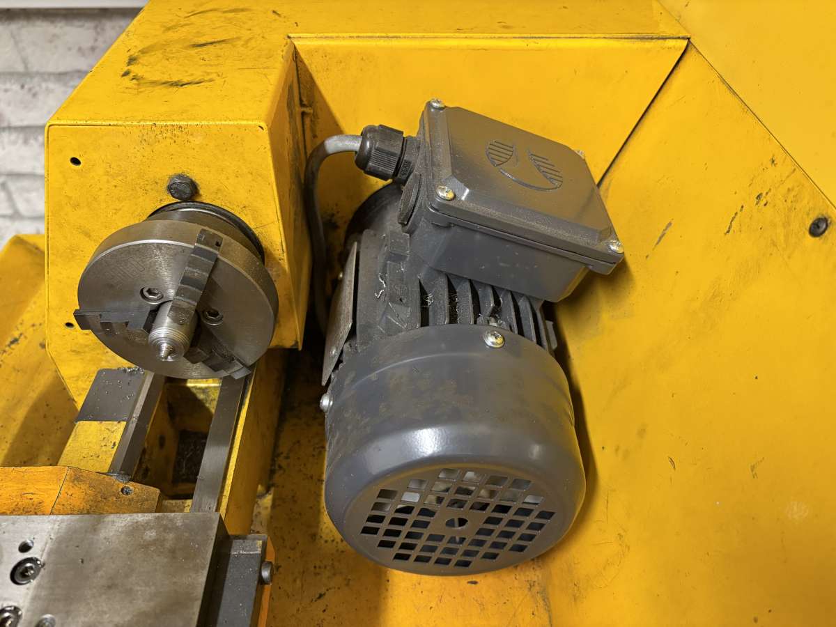

              I took a different approach when the motor on my Emco 5 cnc died: I have replaced it with a 3 phase motor.  The controller for the motor is fitted inside the cabinet (I replaced the old Emco boards with a newer controller, which created a lot of room for this).  The new cnc board (Acorn) has a voltage output that allows the motor speed to be controlled.
              I suspect that the maximum speed of the new motor is less than the original DC unit, but I weighed the lower speed against having no motor!  I hope that this helps.
              IMG_5419
