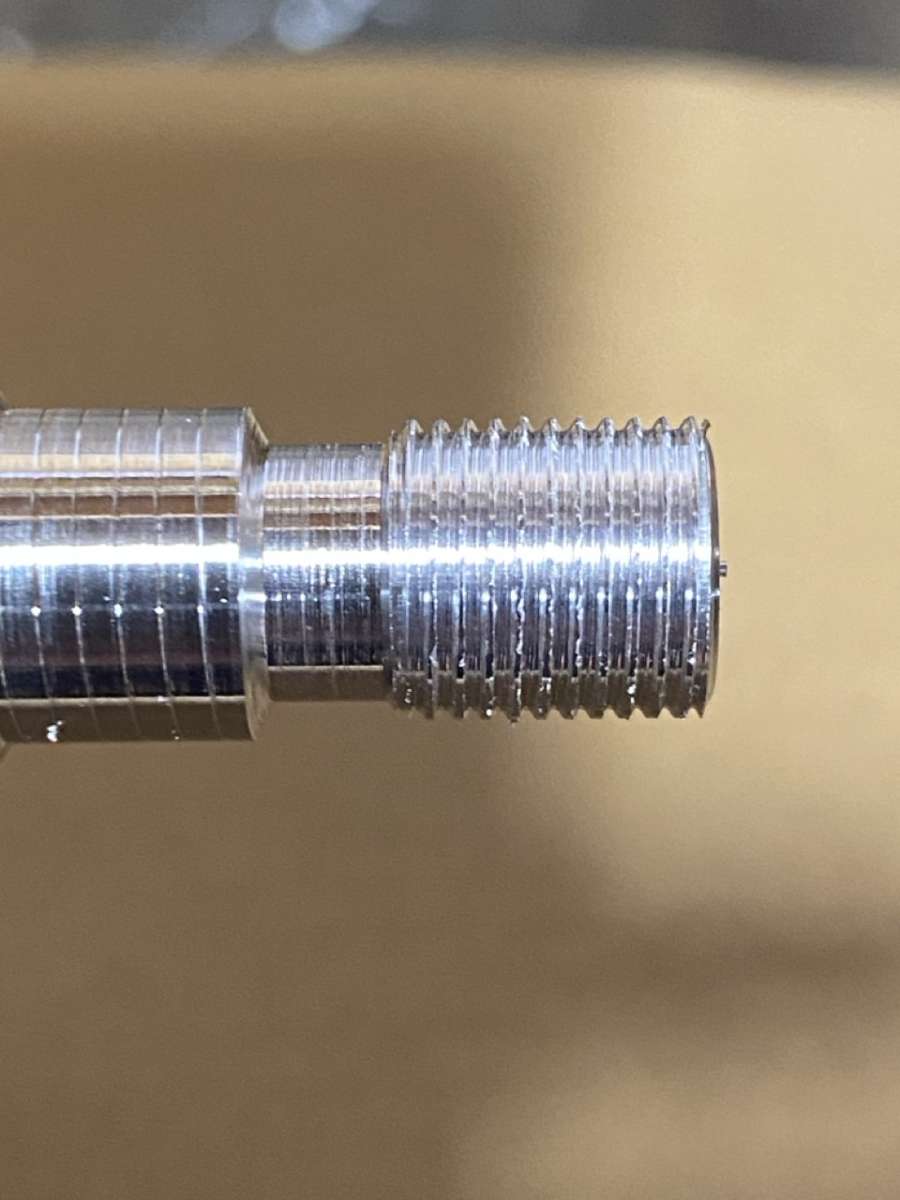

                    LH threading with normal chuck rotation is just a matter of selecting the opposite rotation of the Boxford tumbler gears (could also be done in the config of the ELS).  The main problem is allowing a start groove of 5mm for the backlash makeup which is non adjustable.
                    28tpi LH 840RPM
                    28tpi at 840 rpm (auto threading) single point tool. The finish could be better if I was using some cutting oil.

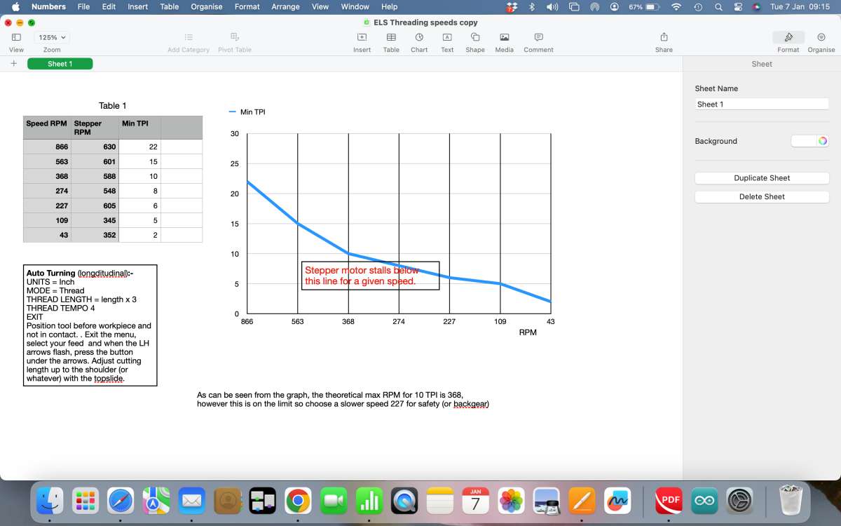

                        I have an update on my installation.
                        Installed new PSU from Stepper-online which made no difference.
                        I installed a USB PSU for the controller so that any interference from the stepper PSU was eliminated – no difference.
                        I selected an option on the controller to show stepper RPM and here is the problem.  The Nema 23, 3Nm has a max RPM of 1000, but a recommended speed of 100 – 500rpm. When I repeated my tests, it was obvious that motor stalling occurred at stepper speeds in excess of 500RPM.
                        Although the supplier recommends stepper / leadscrew pulley ratios between 1:2 and 1:3 IF the torque is available from the stepper, then by  getting the pulley ratio nearer to 1:1 or less would solve my problem.  This is eluded to by Nigel B (Thanks Nigel).

                          So, I am thinking of changing the current Stepper/Leadscrew pulleys from 20:40,  to 32:40.  I believe that this would allow me to cut a 1/2″ 16 BSF thread at 563RPM giving a surface cutting speed of 73ft/min and keeping the stepper motor sub 500RPM.

                              I have now fitted different pulleys for the stepper / leadscrew  32:40 and this has made quite a useful difference.  For example:- 12 tpi at 560 RPM which is quite scary  or 19tpi at 860RPM, even more so!
                              It almost makes turning threads in wood possible (8TPI at 360RPM).
                              When threading, there is no need to turn a groove where you want the end of the thread to stop as the system stops exactly in the same place each time and thus turns its own groove as the depth of thread increases.
