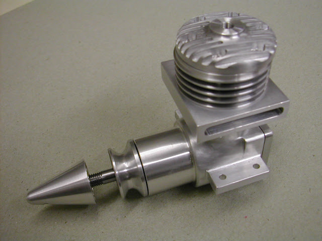

      Hi,

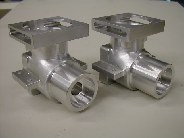

      Following on from experiencing the Nova bursting into life I thought it would be interesting to have a go a designing a diesel based around the 2.46 ED Racer of the 50’s/60’s.
      I borrowed an old Mk4 from a friend and scaled it up by a factor of 1.266 which brings the capacity to approximately 5cc.
      The drawings were laid out on copier paper in the traditional way – with a pencil using a piece of Contiboard as a drawing surface – ‘CAD’ drawing (Contib’d Aided Design!)
      Two blocks of ally were obtained and the chipping began – 221/4 ozs. per block to start, 31/2 to finish. Quite a bit of swarf!.
      I did two to hedge my bets incase of a mistake – and yes, if you are wondering -the keen eyed may spot a subtle difference but ostensibly they are both suitable for use so now the next stage can begin – Crank shafts – two piece as in The Nova as so far this has stood up well to the torque swinging a fairly large prop. These of course will rev much harder but with a smaller prop.
      Some asked for some pics so here are a couple,

          @robmanley79788
          Very impressed with the quality of work so far.  Its always fun to cut a complex shape out of a boring solid block,  It looks like a very pretty engine.  Please keep us informed of progress.

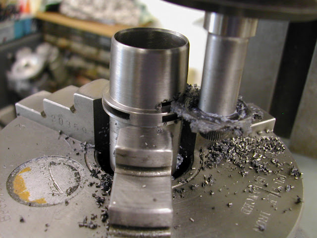

                      As suggested I thought some might like to see the latest bits tackled – the crankshafts and backplates.
                      The crankshafts are ‘two piece’ – the smaller 1/4″ inner shaft, turned from an 8mm caphead bolt which is Loctited into the outer. The outer, which includes the web and crankpin, is from EN24T left in the soft state. All turned between centres after Loctiting
                      The backplates are machined from solid and proved an interesting part to make. I’m planning on getting all the ally parts made before tackling the internals.

                                      Had a good session on my friend Lee’s bead blaster today and finally got the cases and backplates done along with parts from a couple of other rebuilds.
                                      Heres how they look now
                                      I can now build the bottom ends up though I think I will wait a bit until all the parts are made. Liners and pistons next and an attempt at that anodising.

                                          Spent an interesting couple of days making the pistons and liners. As said elswhere it was decided to make one from cast iron and the other from a ‘tough steel’. The cast iron was an offcut and has an exceptionally close grain – much finer than the continuous cast bar I have. Shame there wasn’t more for the pistons. I have no idea of the steel – it came from a largish stud – 1-1/4 dia by a foot – ‘surplus to requirements’ from offshore days. Probably of American manufacture the end of the stud was neatlly marked ie engraved not punched – ‘CR 8 S  7’ Whether that relates to the grade I have no idea.
                                          It turned reasonably well and gave a good finish just have to see how it stands up to the task now.
                                          The cutter(s) for the ports – three were made just incase (just as well) –  came from 2mm thick GFS. Heat treated and tempered light straw the first two did not stand up to the steel liner both wearing quite quickly despite low speed. This was put down more to insufficient backing off so ensured this was better on the last one and left it hard and untempered as well. Slowest possible speed and ‘Bingo’ – sailed through !
                                          Piston material came from a slab of continuous cast bar – this was rather than waste the larger diameter round bar ‘in store’. Hit a ‘snag’ tonight when lapping the first piston to go into the liner. Just realised in time as I was beginning to think I had left rather too much on for lapping that I was trying to fit it to the wrong (and tight) end of the liner! I think I may have caught it in time, it is still quite tight at the very top of the bore but won’t really be able to tell if the compression is good enough until it’s assembled If one bore had been made slightly larger and that done first then it could have been used for the smaller – must keep that in mind ???.
