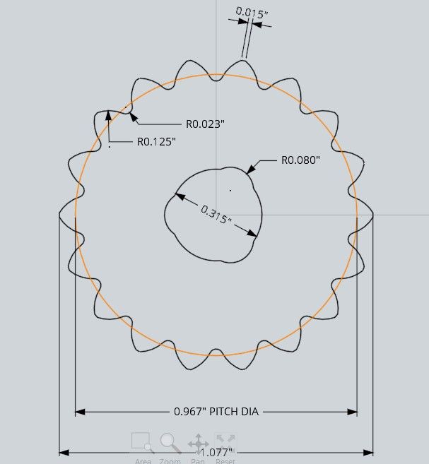

            #503242
              If you have CAD then you could draw them up from this

                #503249
                  Posted by JasonB on 24/10/2020 18:26:56:
                  Nicely drawn, that yes
                  Lessons could should be learned

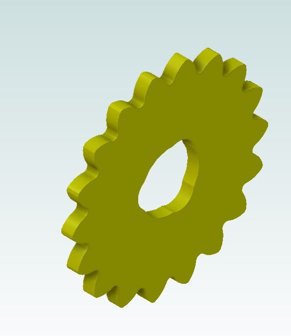

                            #503300
                              Posted by JasonB on 24/10/2020 19:02:45:
                              I just learnt thiswink 2
                              I didn’t mean you, Jason … I was thinking more of a recent ‘reworking’ fiasco
                              The Meccano drawing is a model of clarity, and remains useable
                              #503321
                                Yes everything is on the drawing *, the only thing I had to make a call on was whether the 0.015" was a straight line between where the two arcs meet the OD or if it were the length of the small arc, though it would not make much difference on such a small dimension. I did learn a little as it made me think how best to draw it and did use one option that I don't use often. I'm just waiting for Dave's pencil drawn on nowsmile p
                                * :Looking again I see it was steel and I coloured it for brassblush

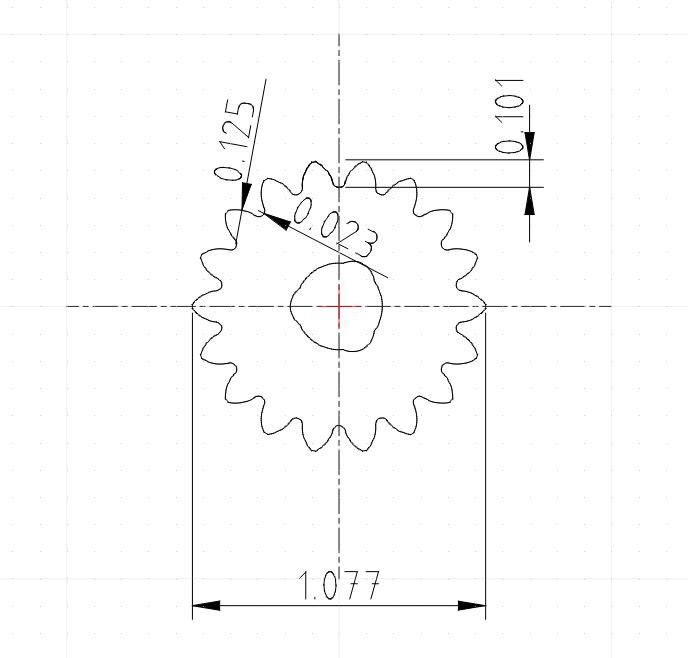

                                #503403
                                  Posted by JasonB on 25/10/2020 06:28:26:
                                  I learned from this one too. My attempt in Qcad:
                                  It's wrong! Right at the beginning I misplaced the tooth valley by centring its radius on the pitch radius circle, which is not what Meccano Ltd drew.
                                  I looked 'Pummel' up in my big dictionary. Must have been old-fashioned in 1944 because it's an archaic spelling of 'Pommel', which includes the meaning 'boss'. Pommel and pummel are interesting. To pummel is to beat, and the pommel of a medieval sword (the round ball on the end of the handle),  is used to balance the blade and hammer people.

                                  #503409
                                    Was the boss fixed to the sprocket by expanding the end Pummel "beat" may be appropriate
                                    #503414
                                    blowlamp
                                      @blowlamp
                                      Here's mine in MoI.
                                      Martin.

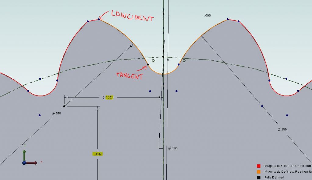

                                          #503717
                                          Steve Withnell
                                            @stevewithnell34426
                                            Started drawing my version – thing I can't work out is how to establish the centre for the 0.125inch radius? The valley and 'flat' on the tooth I can work out, but finding the centre is defeating me!
                                            Regards
                                            Steve
                                            #503719
                                              I did not find it but could measure from my drawing. I drew a 0.250dia circle and made it tangental to the 0.046" one for the valley and then also made it pass through (coincident) one end of the 0.015" arc.
                                              Edited By JasonB on 27/10/2020 12:21:12

                                                  #503732
                                                  blowlamp
                                                    @blowlamp
                                                    A way to find the centre for the tooth flank radius of 0.125".
                                                    Martin.
                                                    #503734
                                                    Steve Withnell
                                                      @stevewithnell34426
                                                      Posted by JasonB on 27/10/2020 12:17:12:
                                                      Thank you!
