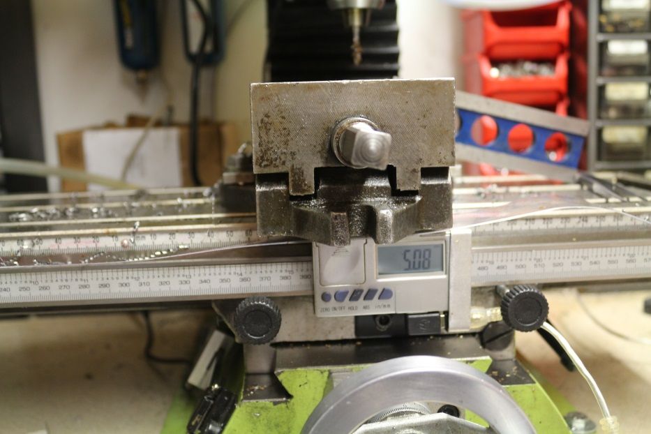

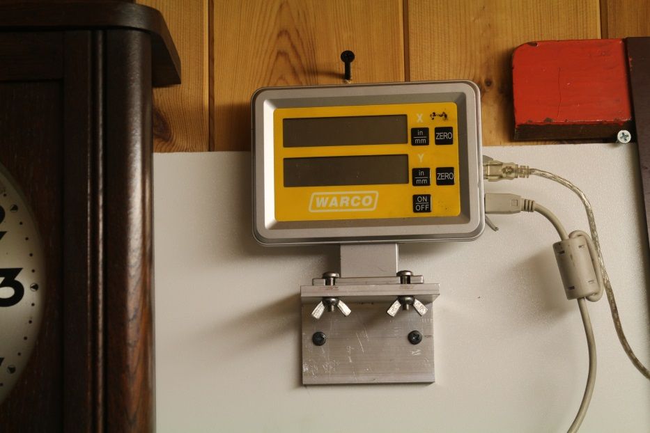

      I have always had problems with the cheap WARCO two axis DRO on my WM 16 mill but of late it has become much worse – like unusable! Setting a datum point using x0 – y0 and without even moving the x and y axis I can – with the machine plugged in – press "ON" and "OFF" repeatedly while watching the readout. Invariably and within the space of six cycles either X or Y will loose its zero reading and display a random measurement up to 30mm or so out of kilter. Sometimes BOTH axis change at the same time. One thing remains constant though, the problem only manifests itself when pressing the "OFF" button – never the "ON".
      I suspected some sort of "noise" problem so I have dispensed with the original USB mini B leads and fitted heavier duty shielded leads keeping them as short as possible but the problem persists. The scales are squeaky clean and the calliper readouts, unlike the main display, remain accurate. I tried connecting an earth lead to the central screw on the control panel marked with an earth symbol and the other end to the mill casting and that makes no difference either. Finally I relocated the readout a couple of feet away from the machine – still the problem is there. Having googled at length I can see that this is quite a common problem with these budget systems but I appreciate that with all the variables a common fix is probably not possible. However, I live in hope! I would add that the electrical installation in my workshop was carried out by a pro electrician this year and is certificated.
      That is as far as I can go with my very limited electrical knowledge unless some kind soul can advise me. In the meantime I am back to using the graduated hand wheels.

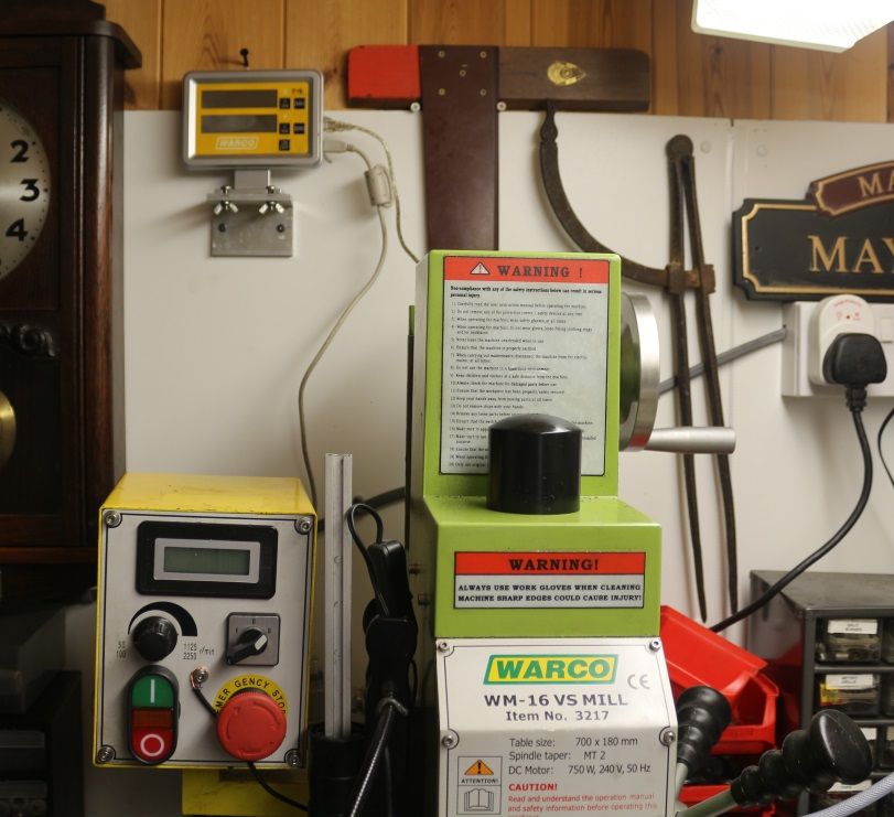

              Neil – Its the "ON" and "OFF" button on the milling machine I am switching on and of.
              "do you mean the displays on the read heads keep the correct reading?"
              Exactly so.
              To limit spike problems the milling machine takes its juice through a surge protector.

                    Disconnect USB leads from read heads but NOT from main display and motor start/stop produces nil errors.
                    Reconnect USB leads and errors resume.
                    Rik

                            One thing I would try is to temporarily unmount the display box and put it on the swarf tray near the tailstock end of the bed with the leads to the scales kept away from the lathe mains wiring. Its possible that the existing route and layout of the DRO wiring form a 'loop' that picks up the mains spikes.
                            If the power to the DRO scale readers are derived from the display box (which in turn gets its supply from a 'wallwart&#39 than as suggested use a different mains outlet or if possible power it temporarily from a battery.

                              Hi Rik,
                              I had the same symptoms and assumed it was an electrical problem. It was actually mechanical.
                              My display was mounted on top of the control unit. Switching off causes the contactor inside the box to drop out with a healthy thump. The vibration shook the usb cables sufficient to cause an intermittent connection. I found my plugs & sockets to be slightly loose at the display end, but not obviously so.
                              Your set-up looks to be less vulnerable to vibration than mine but it might be worth adding some form of strain relief to the cables to ensure that the plugs can't wobble.
                              Hope it's as easy as that!

                                          I think the source of the problem is electrical noise generated when the NVR switch opens. (The NVR switch is the unit with the start and top buttons.) I would first try fitting a spark quencher across the contacts of the NVR switch. Such as this item My next step would be to fit a mains filter (such as this but with a suitable current rating for your machine.) if possible inside the control box of the mill or if there is not room then in a box very close to where the mains cable goes into the control box. There will probably be an earth loop formed by the fact the metalwork of the scales is connected together via the metalwork of the machine and the other end connected in the display unit. You could try just connecting one scale at a time to the display and see if the fault still occurs. If the fault does not occur with just one scale connected then make insulated mountings for one scale so it's metalwork is not connected to the machine. Although the connection to the scales uses USB cables the signals do not use USB protocol. They probably use a protocol called BIN6 which is a serial protocol. the data is on one wire in the usb cable and the clock signal on the other. I do not think the problem is caused by corruption of the data on the link. I think it is the dislplay unit electronics that is being effected.
                                          Les.

                                                  Hi Rik, I think John is right. By connecting both scales to your mill you create a ground loop via the cables and the readout unit. This makes the readout sensitieve for spikes generated by the motor driver unit. Electrical insulating one or both scales from the mill meigt help solving the problem. You can easily try it by using some electrical tape. Regards, Johan.

                                                    I have a similar setup to you save that I have mounted my reader on top of the switch/control box and have noticed that if I do not reduce the speed to the lowest setting before switching off the reading sometimes becomes corrupted. I just reduce the speed to zero and all seems to be fine.
                                                    Hope this helps.
