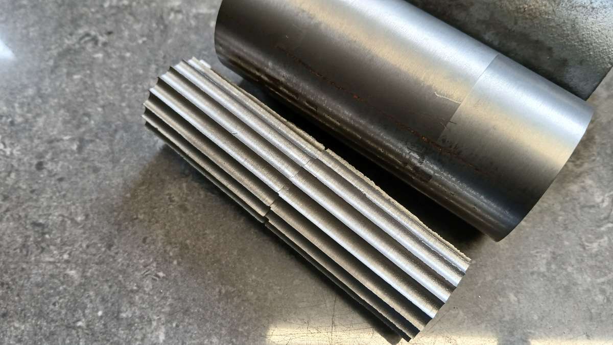

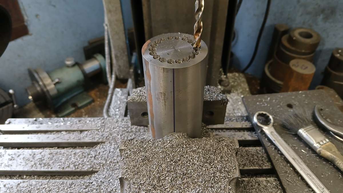

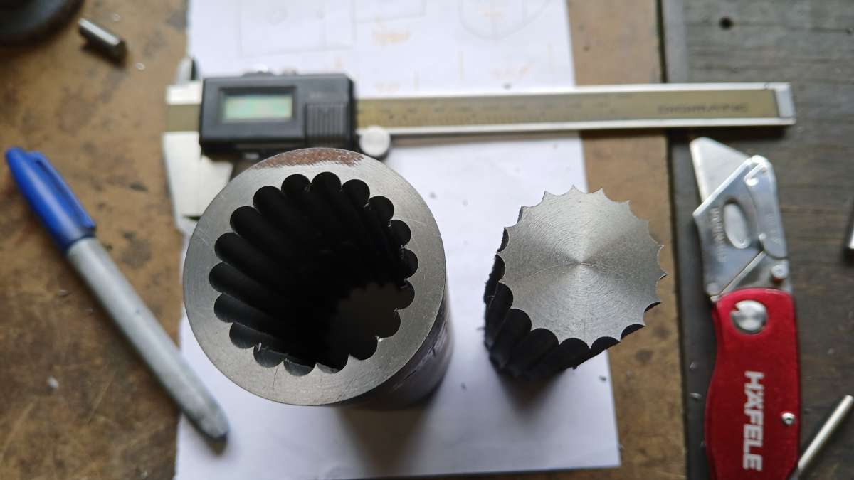

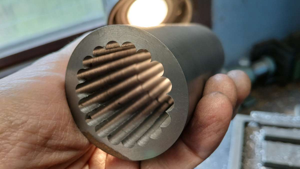

                                            #819178
                                              Well having just drilled a little over 2000mm in length I was quite happy with the lack of drill wander.
                                              6mm drills, stub and Jobber Dormer A002 & A022 (Neither new) no spot drill to start. Nothing more than a sharpie line to get the radial position and holes spaced at approx 5.9mm cts  (18 holes on a 34mm PCD) so one just overlapps the next. Came in from both ends of the 112mm long bit of CI bar. No pecking just steady pressure with a feed counted at 70-80mm/min and speed what sounded right. Once the swarf was knocked out the bit in the middle dropped out too.
                                              20251007_114053
                                              20251007_121510
                                              20251007_121629
                                              20251007_121735
                                              #819187
                                              renardiere7
                                                @renardiere7
                                                That’s just showing off!  Well done!
                                                #819214
                                                gerry madden
                                                  @gerrymadden53711
                                                  Excellent work, and very encouraging!
                                                  #819227
                                                    Fabulous work, Jason
                                                    … ‘though presumably two hundred millimetres
                                                    #819232
                                                      No 18 holes at 112mm long = 2016mm TOTAL
