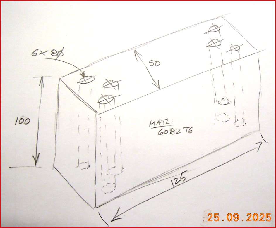

      I will soon want to drill 6 holes in the aluminium block as shown below. A key requirement is to achieve hole positioning on the lower side where the drill exits, as close to the pattern that I start with on the top side.
      Over such a depth a drill may wander, so I will start with buying a good quality one. I will start each hole with a spotting drill. The block will be squared up as best I can.
      But what else could I do to reduce the pattern ‘scatter’ on the base surface. I did wonder about perhaps rotating the workpiece 90 degs after say each inch of depth to cancel out tramming/misalignment errors in the mill, but don’t think I have ever seen such a thing done before. Would this be sensible, and/or is there anything else I can do to keep these holes parallel?
      The hole will be a clearance hole for a 5/16″ AN bolt so I’m not looking for GD&T precision (whatever that’s all about 🙂 )  I’m more just wanting to the best ‘home workshop’ job I can do, so that when I go to hang a correctly drilled plate/bracket on the bottom face, I don’t have to resort to modifications of the bracket.  Also I also don’t really want to drill from both sides and end up with six internal dog-legs and steps!
      (Sorry distortion by the camera makes the block look trapezoidal! It will be rectangular, to good home-workshop standards.)

        So why don’t you drill from the bottom face?

          Rotating the block introduces the risk of slight lateral errors, albeit very small ones, potentially enough to set the drill a-wandering.
          Taking only shallow bites with frequent clearing of the flutes will help keep the drill going straight.
          Do the bolts need go all the way through the block?
          Can you modify the design so that you can screw the bracket on from its own side, using tapped holes and set-screws or studs and nuts, that don’t need penetrate ever so deeply?
          Do the fasteners also hold something on top, as if the block is just a big spacer? If so, can you use the same principle but when inverting the block to drill the opposing face, being careful to set off from the same datum faces?
          Would it greatly matter if you do drill from both sides but perhaps 0.3mm over-diameter for about 30mm depth from both faces, so even if the holes have drifted slightly their centre portion is still very close to your intended centres?

              Apologies, I could have added that the block will be sandwiched between two plates (as a big spacer) and through-bolts will go through all three parts. I can really change this design with internal tapping etc. Similarly, oversizing some or all of the holes on either side would compromise some of the structures integrity.
              Martin, …?! I’m tempted to say ‘cos i dont have an upside down drill’ but I might be missing something in your response 🙂  The hole pattern is important on both sides. I know I can control one.

                DC31k, yes you are absolutely right. I couldn’t remember my target size so just rounded it off for the post. So it would actually be about 8.2. But on 100mm depth I fear drill wander, could be more…. but I may be wrong.

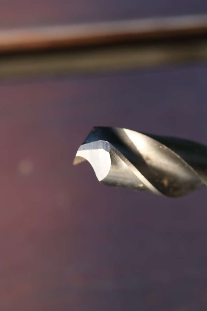

                                you could try a drill with a secondary point angle they are supposed to help with long hole drillingS11A7251

                                                  No need to apologise for the sketch, it shows everything perfectly well.
                                                  Drilling from the bottom would ensure the holes come out accurately where it matters as already mentioned
