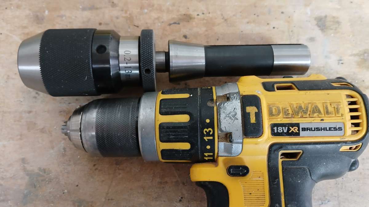

                                            Looks like that Supra only comes with B16 mount so not going to work with cordless drills being discussed here.
                                            The other thing to consider with cordless chucks is they tend to be a lot smaller than a similar capacity chuck intended for drilling machines, mills, etc. This means you have less leverage due to the smaller OD and chuck jaws are quite probably shorter too. So unlikely to have the same holding capacity.
                                            Far easier to get a grip of teh 13mm ARC one than the smaller DW particularly when the knurl starts to wear.

                                              The Supra SK has a separate ring to engage/free the locking ratchet. It certainly comes with 1/2inch 20 thread mounting, not sure which taper(s).
                                              https://www.roehm.biz/en/products/drill-chucks/supra-series/
                                              #839810
                                                Sorry, I did looked at the Spiro SK. But at over 50% longer for teh Supra SK than my DW would defeat the object of buying a Compact Combi though depends on what sort of work you do as to how big a drill suits.

                                                  Yes, the Spiro chucks are intended for fixed machine use, and are really what I should be using. But they are rather too long for a small mill, and in any case it is very difficult to find any one in the UK selling them. There is also an Albrecht chuck series with a similar locking ring, but that costs much the same as a hobby mill!
