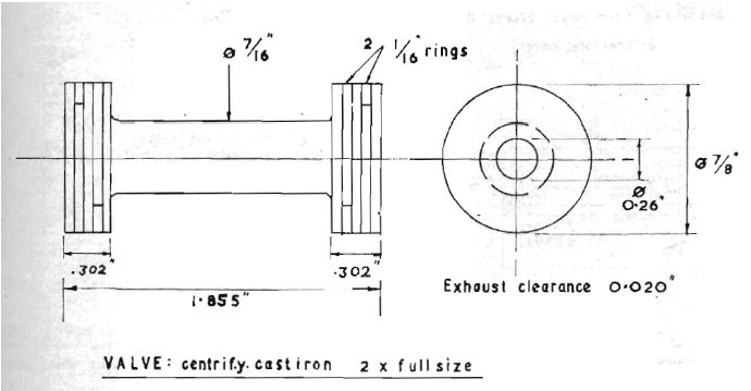

      In a Martin Evans series from back in 1975, he appears to have pasted, as an after-thought, a drawing of the inside valve "bobbin" of a 3 cylinder loco.
      It's clear enough except for his comment "Exhaust clearance 0.020". (Elsewhere he specified exactly where the exhaust ports should be positioned within the valve chamber. Furthermore, he shows the ends of the bobbin (not the rings) at mid posn. exactly in line with the outer edges of the transfer passages to the main cylinder).
      I'd welcome info please on what this comment might mean in terms of the bobbin.

        #548990
          What is the actual distance between the passages, best not to assume the two lines are lined up in which case 1 7/8" (1.875) seems likely.

          Martin Kyte
            @martinkyte99762
            The exaust clearance is the amount by which the valve is open to exaust at mid point of travel. This is the INNER edge of the valve bobbin. So on your drawing the gap between the inner edges of the bobbin is 1.855 -2 x 0.302 = 1.251" To give 20' exaust clearance the distance between the INNER faces of the tranfer ports in the valve cylinder would be 2 x 0.020 less than this or 1.211" apart.

            J Hancock
              @jhancock95746
              Is he not referring to the clearance of the spool on the valve shaft ?
              #548994
              Martin Kyte
                @martinkyte99762
                Actually that would be for outside steam admission.
                regards Martin

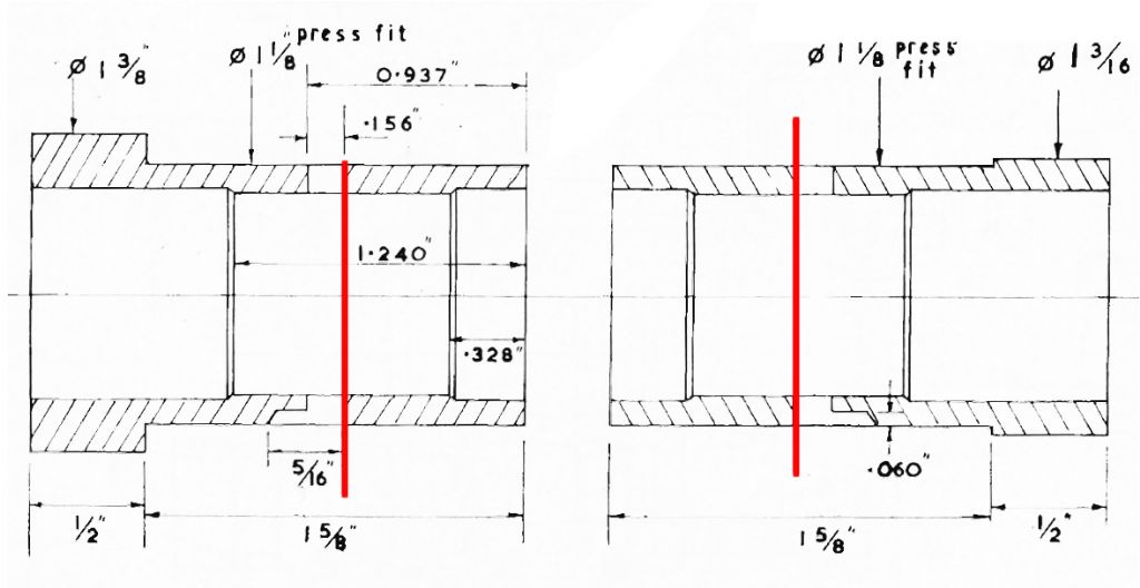

                Fowlers Fury
                  @fowlersfury
                  Very grateful to Jason B and Martin K.
                  The Evans dwg of the valve chamber is reproduced below.
                  In answer to Jason ~ yes, his distance is 1.874"
                  I made one attempt to machine the valve chamber i.e. liner, in 2 parts but found particular difficulties with the varying bore and especially producing square holes for the ports in precise locations. So – next, the valve liner was made in 3 parts (see red lines below) which proved a much better method for maintaining accuracy.
                  However for months now, I've been unable to get the valve timing to make sense. Martin Evans did not make any reference to setting the eccentric etc. All my dimensions are within about 0.004" of Evans' dwg (checked innumerable times). I've tried the old LBSC methodology of equalising air bubbles from the drain cocks at F&BDCs but cannot get equivalent air flow. I've tried exactly centralising the bobbin within the chamber again though there's no logic to air emerging from the drain cocks as the wheels are rotated by hand. All done with the main piston at precisely mid point.
                  I've read ad nauseam articles by such luminaries as Dons Young & Ashton etc but found no references to this "exhaust clearance" or at least, nothing I could understand.
                  In desperation, I've spent many hours producing a CAD dwg of the entire valve chamber and bobbin in order to "move" the bobbin along the X axis and see how the ports were (theoretically) uncovered. It was checking Evans' dwg for the nth time that I noticed this "Exhaust clearance 0.020" which prompted the plea for help.
                  I think Martin however has identified the problem (and my naivety) .
                  Now though, machining the bobbin to create that "0,020" is easy enough so renewed thanks !

                  #549040
                    Well the way I goy my 1 7/8" was to add the length of the bobbin 1.855" and the 0.020" Exhaust Clearance. Not read any of the above mentioned people but assume it ensures the exhaust is open before the inlet on the opposite end of the cylinder

                    Martin Kyte
                      @martinkyte99762
                      Jason is correct for inside steam admission. I had the thing 'inside out'

                      duncan webster 1
                        @duncanwebster1
                        Excuse me for throwing in more confusion, but I think exhaust clearance is the amount the exhaust is open when the valve is central. So does Mr Wikipedia ex clear . The drawings give 0.01" each end, so exhaust clearance is 0.01", not 0.02"
                        I wouldn't have thought exhaust clearance was needed on a 5"g model, all it achieves is letting the exhaust out sooner, ie reducing the cylinder power output. Piston speed is very low in models, so unless the ports are badly designed there shouldn't be a problem with pressure drops. I know of some 15"g locos which have exhaust lap, this might be going a bit far!. If cut off is 25% for example exhaust will open at 75% stroke, opening sooner doesn't seem like a good idea
