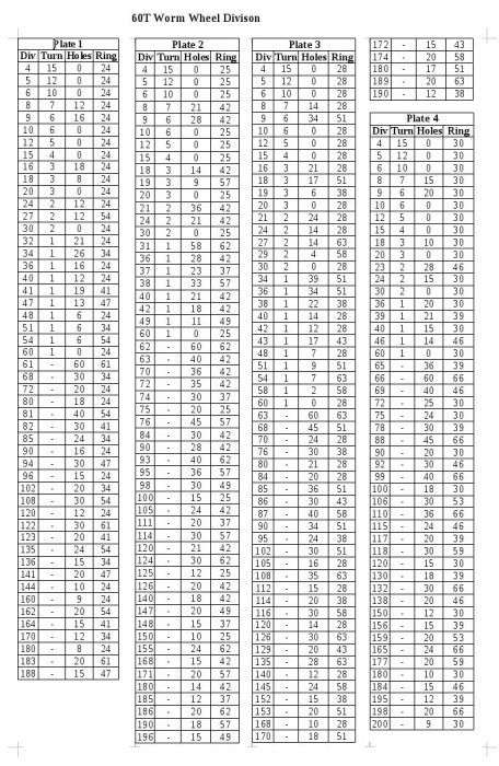

                There’s a whole thread on here from which this is a set of tables for 60T.

                        Here’s the Postbag letter from Vol235, Issue4773, Feb2026.  Sorry about the blur, I wobbled! Just about readable, and the title typo made me smile.  Diving Head, eh!
                        IMG_5438
                        Don wants a Divider Plate Chart for a 60:1 rotary table built to an ME article that Neil couldn’t find, and Neil says he only has a 90:1 chart.   He asks if readers are able to help.
                        Gray describes the maths needed to calculate a chart, and John Haine provides a link to AJohnW 2016 post, #239133, which published this chart:
                        60ratiotable
                        I’ve reposted AJohnW’s chart here in hope Don will see it directly and PM’d a link to Neil so he can pass the info to Don or put it in the mag, whatever.
                        Now the team (not me) have solved the problem, the hard part seems to be getting the answer to Don!

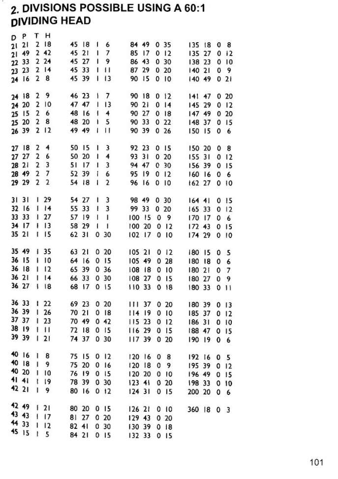

                                      Harold Hall posted a chart for 60:1 dividing head in his book: “Dividing” Workshop Practice series number 37, page 101
                                      Harold_Hall_Dividing_37_p101

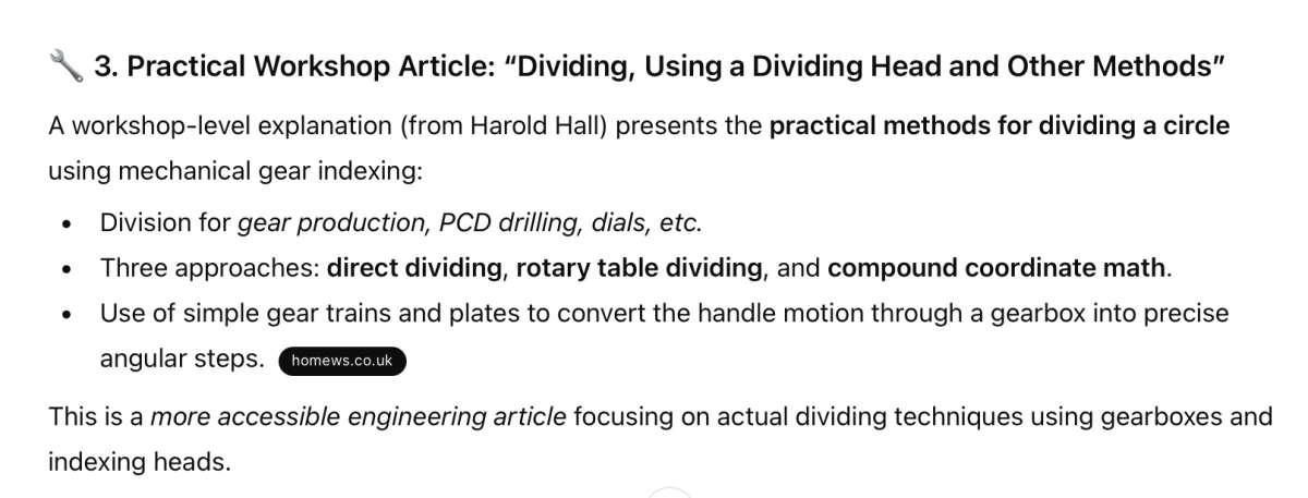

                                              I’ve just asked a broader question
                                              Q. engineering article on dividing, using an available gearbox … please identify
                                              … and this is part of its answer:
                                              IMG_1381
                                              But Safari considered the linked site unsafe … Grrr!!
                                              Update: https://www.homews.co.uk/page425.html?utm_source=chatgpt.com
