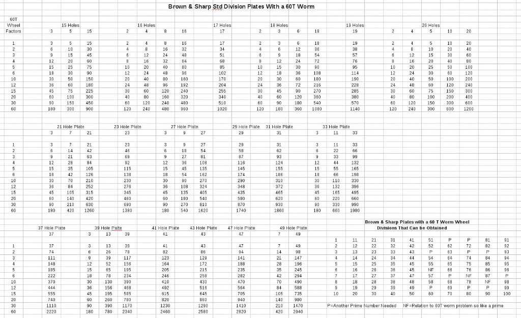

                    I doubt if anyone is interested in the chart I posted BUT do notice that it's only correct for fractional turns of the handle. For divisions of less than 60 it isn't correct. It's just another way of doing it but needs repeating for 2, 3 etc turns of the handle for the lower number divisions.
                    Andy's spreadsheet is the best one I have come across and I doubt if working in decimal will go wrong in this case but in some similar areas it can. I'm reminded of the early days of banking software when some people became rich by sticking rounding errors in their own accounts, also me trying to compute zero slope in a function. It seemed to take a long time. When I looked I found a number with several hundred zero before it and the decimal point.

                                    I used the application I linked to and produced this via a word processor. I copy pasted the apps output into it and used find replace to change it to a coma separated list and then used a wp utility to put these into tables.
                                    I've checked several out manually and all have been ok so then did another page from 200 divisions that went up to the max divisions the plates can give – a bit short of 4,000.
                                    Later when I have time I'll do a spread sheet as a check but using fractional arithmetic or maybe some variant of pure integers that does the same thing and can't have rounding errors and use this to check the application.

                                              You could upload it to filebin.net Timothy but it will only stay on there for a few months. I'd like a copy to use to compare with others. No nags or anything else from filebin. I've used it a number of times.
                                              Your plates look like the ones to Brown and Sharp standard. They were aimed at 40T worm wheels the idea being to be able to obtain low division ratios closely and higher ones to a standard that allowed a lot of gear pair type ratio's to be obtained pretty closely. Cincinnati used a different standard, sort of B&S with bells on so more divisions but aimed at 40T again. That 4 plate table I posted is the plates from Maidstone Engineering. The divisions they give with 60T look pretty good to me so I am going to convert them to fit my dividing head.
                                              I had hoped some one would download and virus check the app I linked to. No one has but that's forums for you. Well some of them.
                                              Using that I had a play with various worm wheel tooth counts out of curiosity. A dividing head based on lathe change wheels has some interesting possibilities. Other than the plates and decent sector arms they are not that difficult to make. Screw cutting a worm to suit the change wheels may be a problem but it just needs to be very close rather than exact.
