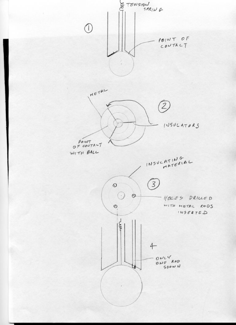

                          Here is an idea for a variation on this design. A ball on the end of the probe sits in a conical depression on the end of a rod. It is held in contact with the depression with an insulaing fibre passing through a hole in the rod and attached to a tension spring. The origin idea was that the rod was made of three 120 Deg segments with thin insulators between them. If the ball was not displaced it would make contact with all three segments. If it was diplaced from any direction it would no longer make contact with all three segments. I could not see an easy way to make the rod in three segments so a possible alternative would be to make the rod of insulating material and drill three holes down it spaced at 120 Deg. Three thin metal rods would then be glued into these holes. When the glue had set the end of the rods would be machined so they formed part of a conical depression. The ball could sit in contact with the end of these rods. Here is a sketch of the idea.
                          I have not yet tried to make one of these to test if the idea will work.

                          John Stevenson 1
                            @johnstevenson1
                            Les.
                            It will work but not very accurately due to the size of the ball and length of the probe.
                            Now if you made the ball 2" diameter…………………..
