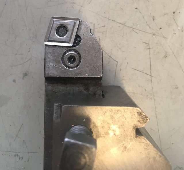

        I normally use HSS lathe tooling, but I have some of Arc's indexable tooling that takes the above inserts. I use them for hard spots in castings and similar nasties.
        Using Arc's.holders, you only use 2 out of the possible 4 cutting points. Being a cheapskate, can anyone recommend an alternative holder that would use the other two cutting points?

                I have a similar, albeit larger, holder for the inserts I (sometimes) use.
                Gets very little use because I can't be bothered turning the tool-post to 75° so the leading edge is almost perpendicular to the cut allowing the insert to come close to steps. As is it's only really useful for facing a full face One day I shall chop the end off and weld it back on at the right angle. But frankyl its a cumbersome lump.
                In my view angles belong on the tools not on the tool-post or top-slide. My Dickson QC styles stay locked at 90° to the bed and the top-slides at 25° angle off perpendicular unless the job is totally weird. If you don't have a rear tool-post the tool-post needs to be put back to 90° for parting off anyway. Switching back and forth between 75° to use the other corners and 90° to part off will get old real fast. Even if, like me, you have a very fast method of re-setting alignment.

                  #510776
                    Clive, Like Rod, I've got a right hand but also a Left hand one from JB Cutting tools no need to turn the toolpost it stays square on. If using the R/H to turn a diameter then it works fine on through cuts and if upto a shoulder then use it to rough out before changing to th eusual SCLCR type to finish.
                    Good for roughing out and also attacking castings where the obtuse corner is a bit more durable
                    As Rod says they work

                            This is an industrial size version. Albeit pin retained rather than screw.
                            Picture shows right hand rough turning configuration, which leaves a 70° ish shoulder, in a Dickson style holder. Flip the tool and mount parallel to the bed for facing.
                            Possibly the most generally useful single tool holder for using up the obtuse corners. I always have plenty of obtuse edges to use up so no qualms about showing it to a horrible piece of material or heavily skinned cast iron.
                            That said there is a very strong case for suggesting that CCMT inserts and the normal right hand holder and left hand obtuse corner exploiting holder shown in Jasons video are an ideal "introduction to carbide" starter set. Indeed, like Diogenes, I'd advise that this pair be pretty much at the top of the shopping list, along with a carbide parting off blade, for any beginner wishing to start out with modern tooling from the get go.
