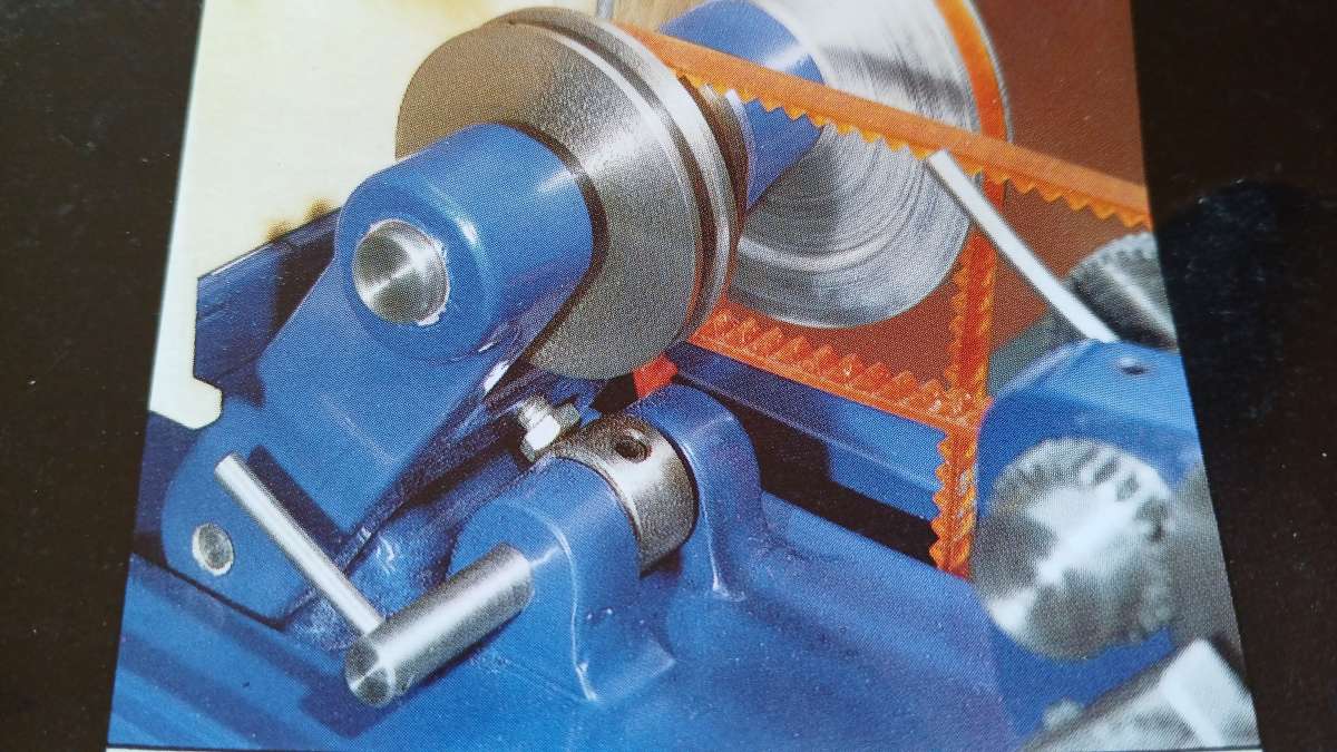

            Jason is quite correct: the Cowells ‘manual’ confirms this, and refers to a locknut on the screw, although I think this may not always have been fitted. The headstock drive belt does need to be ‘twanging’ tight.

                  Thanks for confirming my thoughts on the adjuster. Below is a photo from a Cowells promotional flyer when the ME version was launched which shows what I correctly thought is an adjuster.  Th ehead of the screw rides on teh cam and if it were not there then the tension lever would not work as the cam has nothing to bear against.

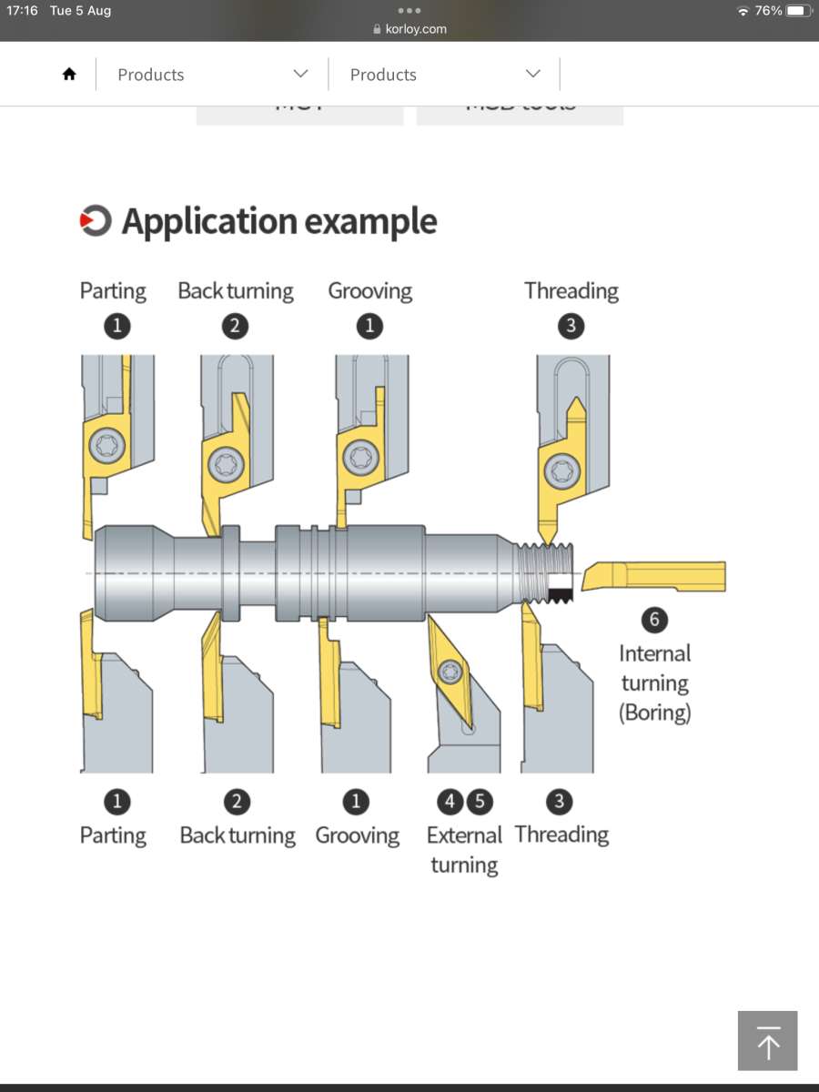

                        I certainly have experienced one way or another most of the issues that kreep in with this scale …. I just wanted to add a tool that I’ve found that I will buy this week !
                        I spent ages working towards more rigid set up as you had to and adjust/replace any worn parts , Thing is parting and process of steel bites you ! After all the tweaks I think this 1mm indexable’  multi tool’
                        It’s possible to buy in 12mm and 10mm shank
                        and buy the inserts below for one shank 😁
                        I think it will help ppl with the smaller less rigid machines
                        IMG_0096
                        #811043
                          I did try one like that on the Emco, a modified 1mm cutter to get teh height down low enough. Failed on the silver steel, would just about work on 22mm mild steel. OK on smaller stuff.
                          However as the part the OP wanted to part was 18mm it would not have been long enough anyway as 6mm is the deepest it will go. I have a number of different width insert sfrom 0.5mm to 1mm and also rounded ones.
                          I use the Mini-Thin

                                The tension  adjuster bolt threads right through the casting and a lock nut is provided where the threaded end exits. I have not had much need to adjust it when set.
