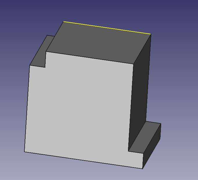

                      #759354
                        On Robert Bowen-Cattry Said:…
                        I’ve been calculating RPM on a slightly different basis which suggested around 540 for a 16mm cutter, I will try your method (for mild steel) which would be 625 RPM. 25% of cutter diameter is 4mm though, I would never have expected my machine to manage that DOC!
                        540 and 625 rpm are in the same ball-park, so don’t worry about that.
                        I should have said that the depth of cut also depends on how much cutting edge is cutting.  In this example a lot less metal is removed to cut the step on the left.   Full DOC might do it one go.
                        docsense
                        Much more metal has to be removed to make the step on the right, so the DOC and/or feed-rate have to reduced.   Rules of thumb help get the machine set about right, but it’s the actual cutting load that matters.  Don’t flog the mill:  if it sounds heavily loaded, back off.    As Jason puts it ‘fast and light’.
                        With experience, one gets a feel for what suits a particular machine best: the sweet spot is a balance between motor/drive capability, cutter type & diameter, DOC & Feed, rigidity, how the work is held, and the material.  Take practice, more the better,  Initially, I spent a couple of months experimenting, trying various combinations to see what worked best.  Though rules of thumb are a good start, don’t be afraid to tweak ’em.
