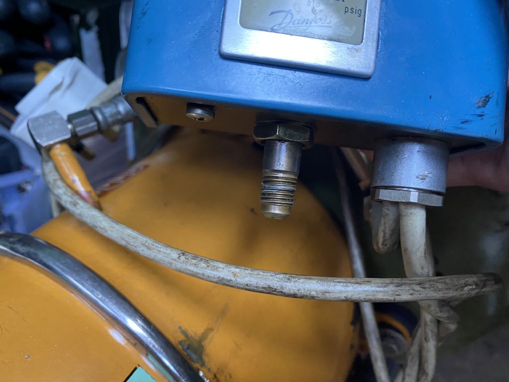

        Hello,
        I'm having difficulty trying to attach a Danfoss pressure switch. It is attached to a compressor I bought for my project restoration. It was badly attached to the tank via a flexible hose with clamps at the end. This is not the original attachment. I thought it was an easy fix with a coupler until I found out that all my swivel coupler won't fit. I was a bit puzzled by the pressure switch attachment. I measured the outside thread with a micrometer and it reads .430 of an inch. Is this a standard size thread/attachment? Hope somebody here will shed some light on this. Thanks in advance.

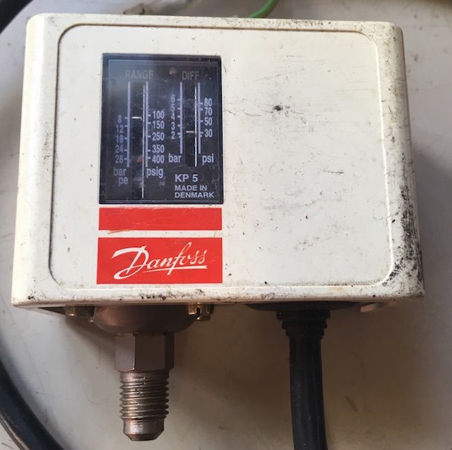

                  Quick rummage in the workshop turned up this Danfoss pressure switch which has a 7/16 x 20 UNF male connector
                  That is an industrial one made in Denmark. Lower end  Danfoss branded ones made in Poland or Far East tend to be BSP.
                  SIP and many of the other hobby compressors often use M12 x 1 for the regulator connections even when the switch is BSP.
                  Clive

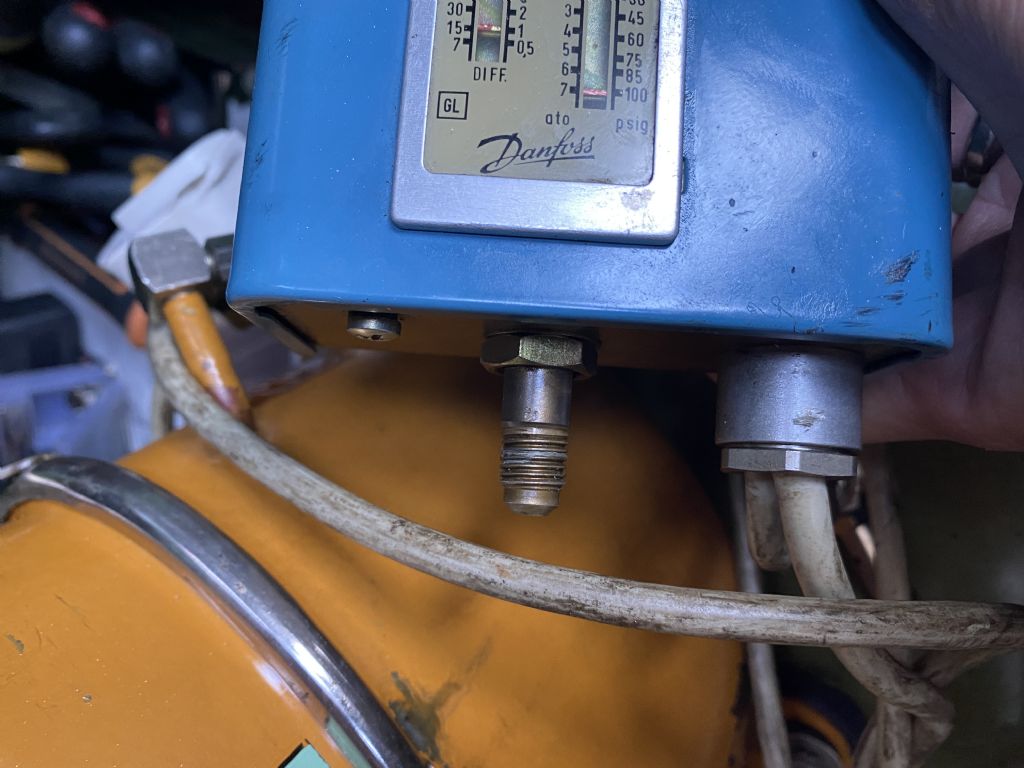

                      Thanks for the input gents. Here is the said thread. I looked at the NPT chart and the 1/4 had 18TPI, 7/16 drill size and a decimal equivalent to 0.4375. Its closer to the OD mic measures I made at .430 but im still confused Noel mentioned that it is unlikely NPT. Also Clive mentioned UNF 7/16. Im sure 1/4 BSP is to big as I tested it already. So is this 1/4 NPT or UNF?

                        Looks the same as Clive posted.

                          That one is 7/16 – 20 UNF thread for a flared fitting. Most likely SAE 45°. Parallel thread adapater with tape was used on whatever I salvaged mine from.
                          But need to be careful with SAE threaded flare fittings.
                          Brake pipes can use 7/16 – 24 tpi. JIC and SAE flare fittings are 7/16 – 20.

                            Clive, the one I have looks very similar to your Danfoss connector. Is it likely 1/4 UNF?
                            #540026
                            Oven Man
                              @ovenman
                              It looks like a flare fitting as used in refrigeration systems, so probably SAE 1/4".

                                Found the specification for my Danfoss switch on line which says the connection is 1/4" DIN 8906.
                                **LINK** , https://store.danfoss.com/en/Climate-Solutions-for-cooling/Switches/Pressure-Switches/Pressure-switch%2C-KP5/p/060-117166 . Maybe yours is somewhere on same site.
                                A bit more searching confirmed that DIN 8906 is 7/16" – 20 with a 45° degree angle. Common on refrigeration fittings although they seem to specify the full 90° cone angle rather than the half angle 45° flare.

                                  Thanks Clive. I was looking at the chart. So its UNF 1/4 with 20 TPI? I plan to just get an adaptor so the end angle will not be needed. I plan to get an adaptor for the 1/4 UNF to 1/4 BSP then the rest is straightforward, hope this is ok i guess?

                                            Hi Clive, got the pressure switch connected. It is indeed 1/4 UNF – 20. Fully tested all pressure and air is holding without any leaks on the UNF-BSP adaptor. Really works a treat this small JUN Air silent compressor. I have done a full oil change with the specific compressor oil, cleaned all rubber seal and checked, changed air filter, checked all electrical and capacitor. Solid small silent compressor and the best thing is I bought the compressor in Ebay for .99 p as the owner said its for spare and its easier for him to just buy a new one than to try to fix it himself. Thanks for the help Clive!
