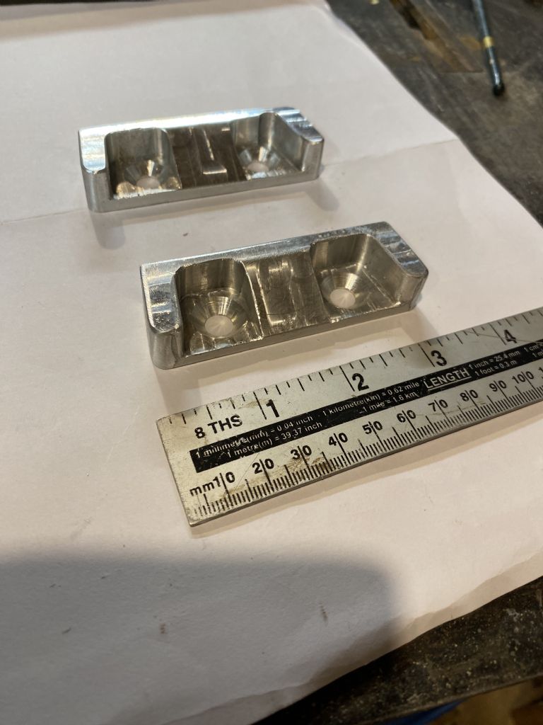

                    Hi Jon, I did two, one about 11mm wide and one about 6mm wide, in a 500mm long piece of 50 x 50mm square block of steel. I just clamped the block down into a couple of Vee blocks, and used an end mill. This is used for folding sheet metal.
                    Regards Nick.

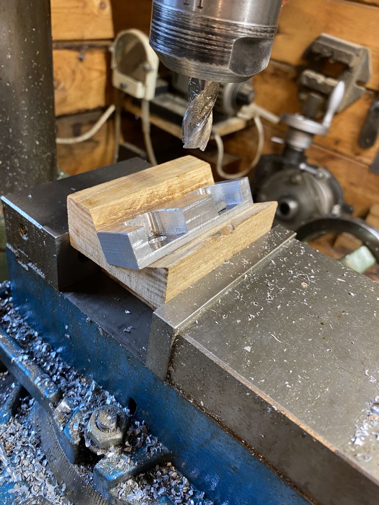

                        Sometimes a simple wooden jig will suffice. Choose a hard wood like oak or ash. These are a couple of door stops I made for an older Toyota jeep where I had to mill out a section on the slant. To stop things moving about, I put a bolt through one of the holes and a tool makers clamp to stop the component lifting off of the jig
                        Edited By Speedy Builder5 on 20/06/2023 08:29:35
