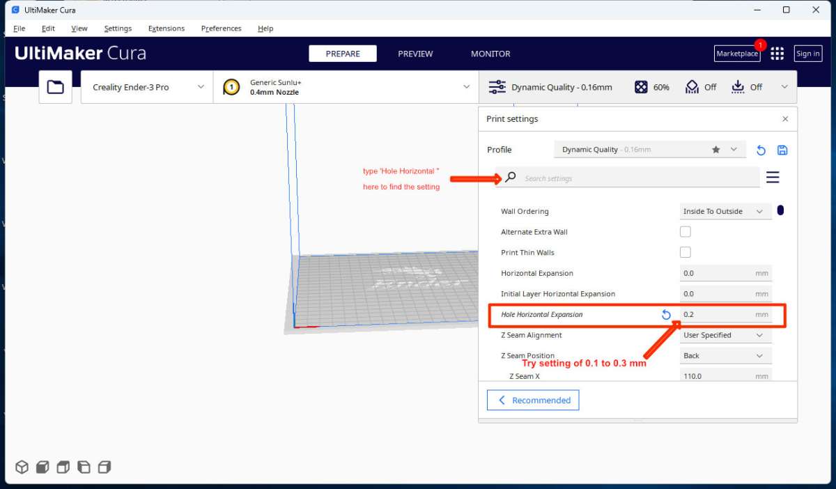

                    Follow John Journeyman’s advice and change the setting for Hole Horizontal Expansion in Cura.
                    Here is a screenshot from Cura 5.3.0 with the relevant setting highlighted in red. I had adjusted holes and internal threads to fit using this setting without any problems. Although you might need to reset it for each material you use.
                    CuraSetting_HoleExpansionS

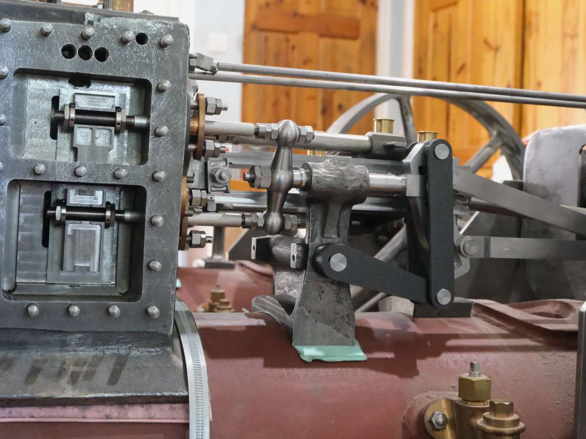

                      Generally the 1% increase suggested by DC31k is too large, 0.3% to 0.4% is nearer the mark. Even with that increase holes are still on the small side. Generally I just make the holes a little bigger in CAD. I no longer use Cura, having retired my Ultimaker printer, so can’t comment on any commands. I now use the Prusa slicer. The holes are still a little undersize, but not by as much. That suits me as most of what I am currently printing are parts for my engines to check form and fit before cutting metal. I prefer to leave the holes as designed and open up with reamer so that parts are a tight running fit when installed on the engine. Like this trial for the valve gear:
                      Valve Gear - 3D Printing
