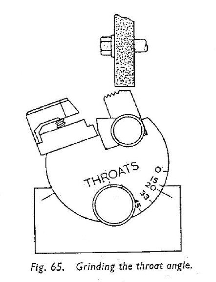

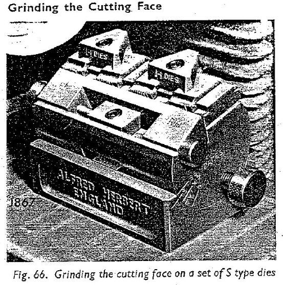

                    I have a pdf of The Book of the Coventry Diehead (25th Ed). It mentions UNC and UNF, so is post-1949, perhaps late-50s to 1960s. I don't know where I downloaded it, so can't post a link.
                    It mentions several jig types, including one for 12 degrees rake angle. It also mentions M-type dies are ground parallel to their back. I enclose a couple of pics from the book for a type which allows different rake angles.
                    It shows the clamps on the left for grinding top rake, and on the right for grinding the 'throat' or lead-in of the die.
                    My recollection from long ago (unreliable) is that the die rake angle was zero degrees, and that there was a simple jig, perhaps shop-made, not a branded one, for use on a cutter grinder or surface grinder.
                    Larger copies are my album.

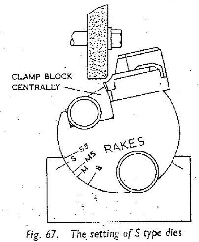

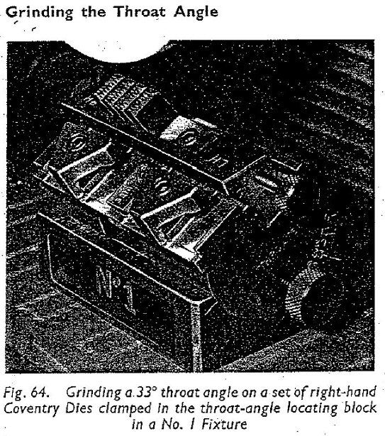

                      A couple of more images from the book, showing the grinding of the die rake angles.
                      Bill
