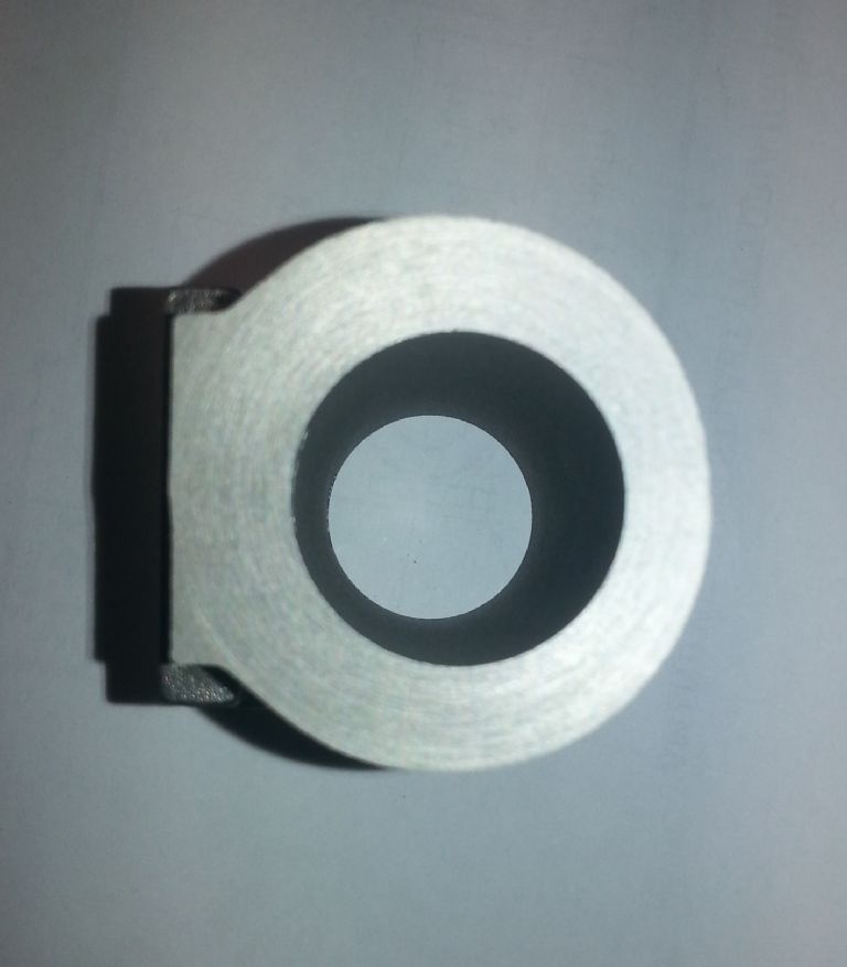

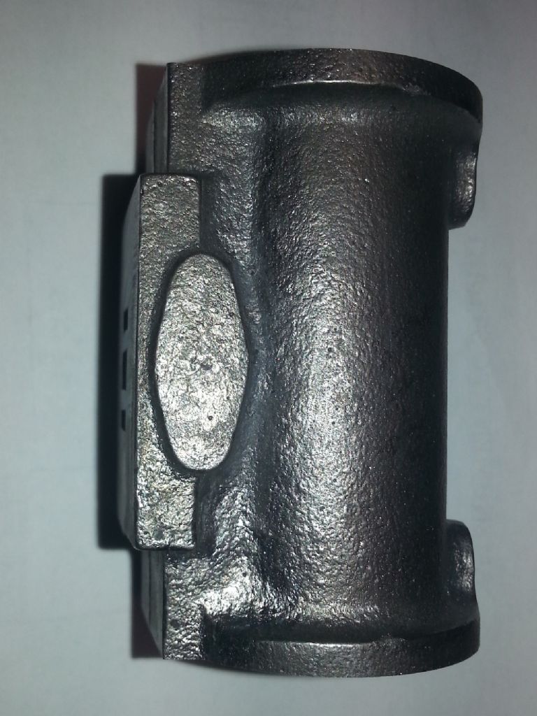

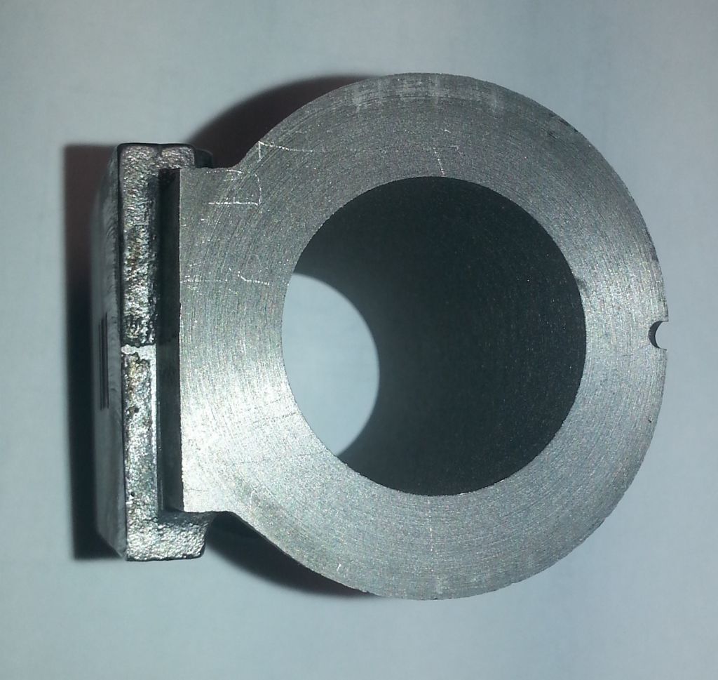

      Hi All,
      I have a Stuart Victoria cylinder that i bored off center and the end flanges are faced to match….i want to correct it and i think there just about enough meat to bore out bigger and increase the piston size.
      Question is – how best to set it up in the 4-jaw squarely in order to make the correction….i effectively have no reference face.
      Thanks
      Matt

          20180322_182130.jpg20180322_182116.jpg20180322_182058.jpgHere are a few photos….

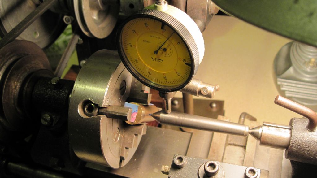

                              Matt, assuming that the end faces are square to the slide face – then I'd super-glue a piece of brass to one end of the cylinder and then find the cylinder centre from the external edge. This can be done on a surface plate using a height gauge (or even a simple scriber). 'Pop' it gently and then centre the casting in the 4-jaw as before (using two lathe centres – I'll post a photo of a similar set-up). Then gently knock the brass off sideways without disturbing the setting.
                              As IanP says – you can simply then just re-bore it, using a washer or some such to allow end clearance for the boring bit. If your current eccentric hole isn't 'true' (e.g. runs at a slight angle) you may find the new hole may need to be larger than you think – worth checking carefully before you start.
                              Regards,
                              IanT

                                    I can see there is not machined valve side.. common new beginner fault.. embarrassed

                                      David and Speedy, look at the photos and you will see that the bole is concentric to one flange which was no doubt the end facing out and was clocked true but the other end of the cylinder the hole is eccentric due to the part not being lined up along the lathe axis when bored.
                                      So you can't adjust the structure unless you want a sloping rather than horizontal engine and if not set up correctly the second time with a flat port face you will still get an out of line bore

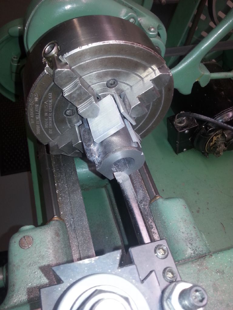

                                              I think many of the suggestions are over complicated, just set it up in the 4 jaw with the outsides of both flanges running something like, then bore it out until it cleans up and face off the end which is accessible. The other end can be done on a manderl, but as long as it is the end away from the crankshaft squareness doesn't realy matter. Before starting you need to check there will be enough metal left on the end flange, as the bore will be oversize. Once you've achieved this put a bolt through the bore to hold the casting face down on your topslide and flycut the valve face, provided the face of the topslide is true it can't be wrong.
                                              In your original photo ~4 you have hold of far too much in the chuck. You need to be able to set up both ends true, only grip about 5mm max, and dump the packing. Unless you are very patient it will keep falling out as you adjust the jaws. Use the biggest boring bar you can find to avoid it springing with the interrupted cut.
