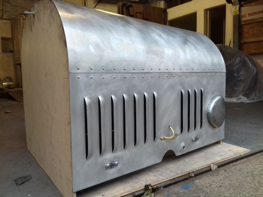

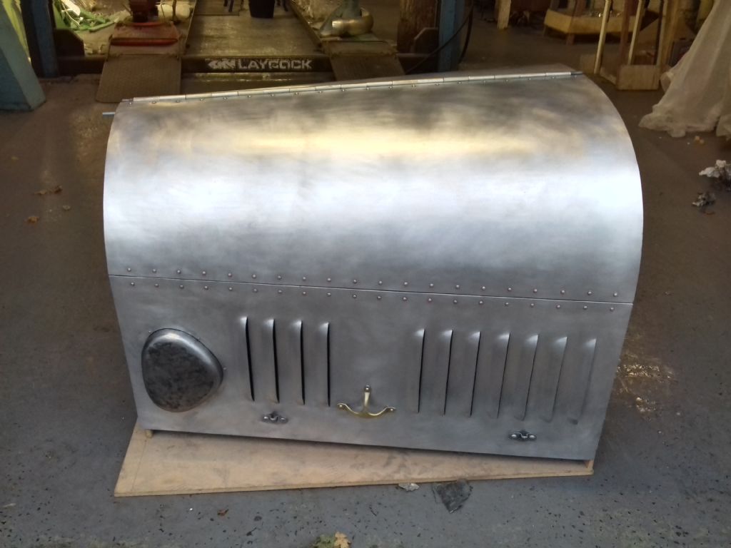

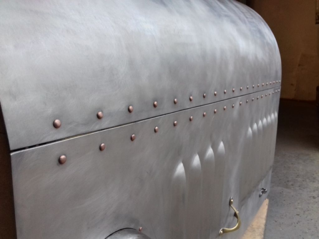

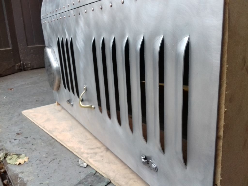

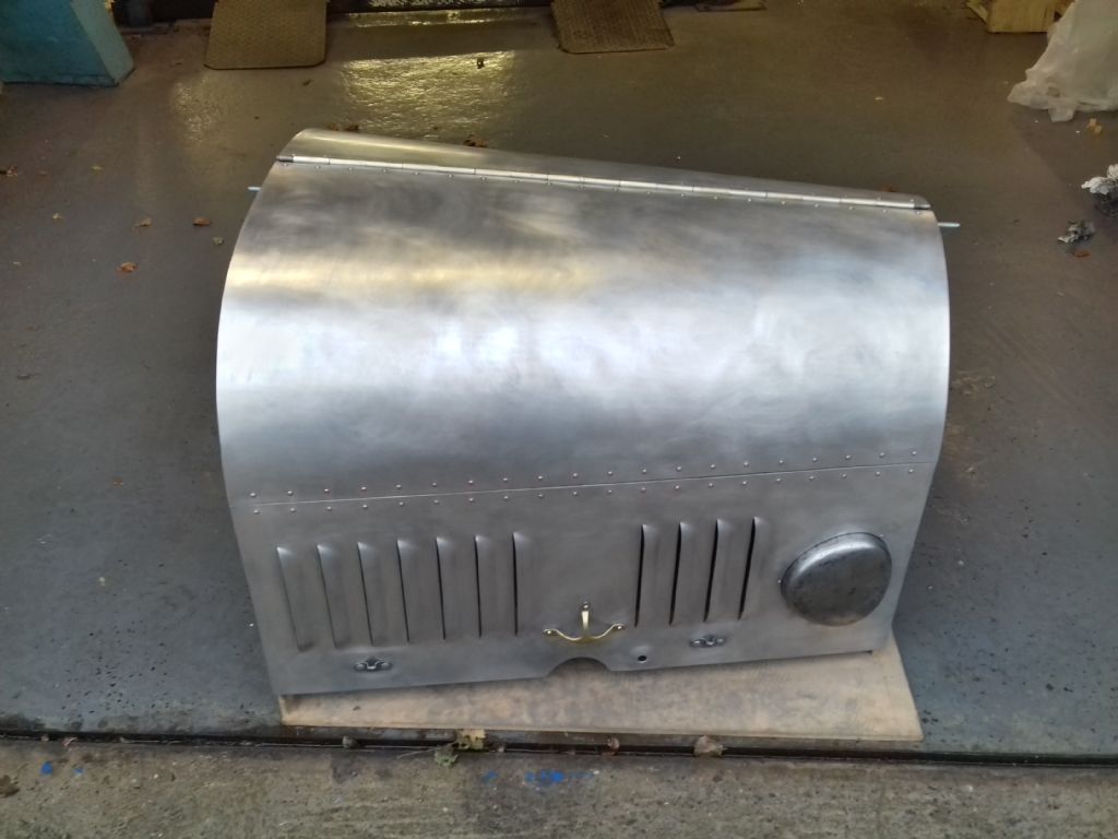

                                    #380459
                                    Stirring Moose
                                      @stirringmoose
                                      Apologies for not finishing this tale before now. Below are some pictures of the completed bonnet, complete with copper rivets. Thanks to all those on here who chipped in with bits of info yes
                                      For those of an automotive bent, the vehicle for which the bonnet is ultimately destined is a 1924/28 3/4.5 litre Bentley.
                                      S.M.
