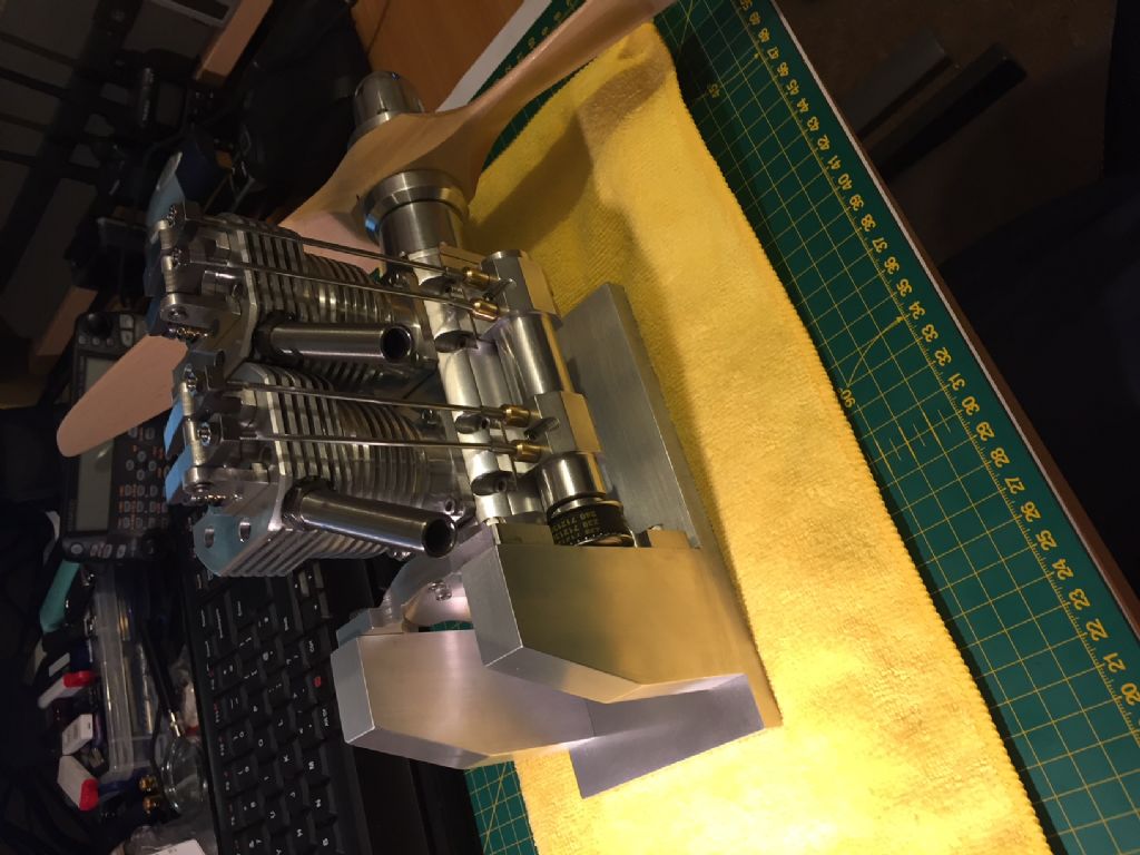

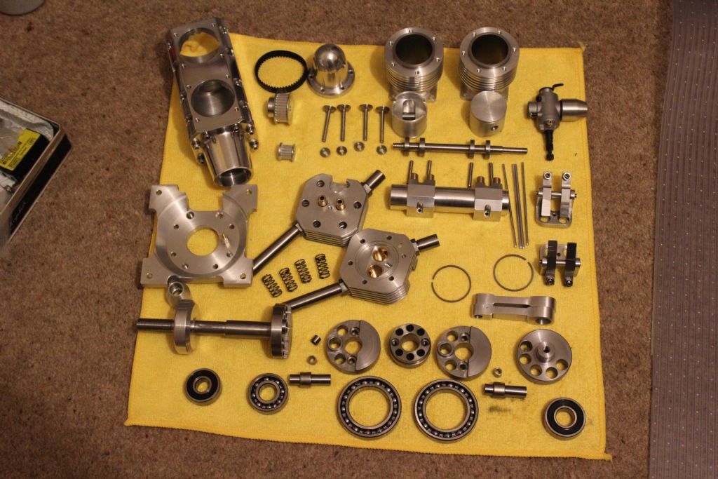

        Twin Inline Engine.jpgtwin parts.jpgHi All,
        I have machined, completed an IC twin Inline Engine that might be of interest to those something doing similar.
        I have run the engine but not too impressed with the glow plug ignition system, I think spark ignition would be better.
        Engine running here https://youtu.be/JS3N3v8eq5I
        Steve

                      Niels Abildgaard
                        @nielsabildgaard33719
                        Lovely engine
                        Can you describe how crankshaft is made?
                        I have tried to make normal ,pressed up two stroke cranks and failed miserably.
                        More than once

                                        Steve G
                                          @steveg24616
                                          Hi All,
                                          I am stunned at the interest for this engine and very humbled by it – I work alone from time to time in my garage and no-one here, at home that is, seems in the slightest interest!
                                          I will try and answer some questions;
                                          Niels; The crankshaft is made up in sections as illustrated and a press fit of the crankpins (with some bearing loctite) was used. The mail problem was, on first assembly, is ending up with a lot of run-out (a banana). The remedy is to try and maintain concentricity during the removal and replacement of the same component during machining operations. It took a while getting that right and I fear is the main downfall of many of these types of engine cranks. I used 12L14 for the main crank parts with two ground silver steel rods for the crank pins.
                                          Craig: Contact me any time, glad to support you – I have cheated in some areas and more than happy to share. I am also building the 4 cylinder boxer engine and happy to report that the crank is turning with no binding (with some tweaking) – no small feat with built up cranks. I used the same cast iron Meehanite for both liners and rings, seems to work fine. I see no reason for using steel liners, they should work fine and be less messy around the lathe although take longer to hone. I put a You tube video out on my 'Heath Robertson' cam grinder, it is a real hotch potch but works which is the main thing. Finally the heads require some thought working out what the drawings say.
                                          John: The engine has a lot of compression, and is difficult to start due to this, but I believe that spark ignition is the way to go. I think I left too much material in the head, for fear of drilling through too much, leaving long glow plug holes – thereby leaving the business end of the glow plug a bit far up the hole. I think spark plugs would work better as this is a large engine – and finding 1.2 volts at 5 Amps is a pain, read 10 Amps for the 4 cylinder!
                                          My cam grinder, for those interested is here – https://youtu.be/jQpSARubxKY
                                          Steve.

                                            Steve, you might find it easier to start if you splash out for an electric starter unit. Saves a bit of wear and tear on the hands too. You do have to make sure you don't flood the engine and then force it over with the starter, that will bend things.
                                            I can't remember how thick the shim is under the Saito cylinder, maybe 15 or 20 thou or so. There was some info in RCM&E a few years back, not sure if I can find those issues now. The cdi unit I used is the RCEXL unit. They are available from places like Hobby King or on Ebay. (No connection, just a satisfied user.) There is a twin cylinder unit, but I think that is meant for twins that fire 360 degrees apart, eg a waste spark will occur on the exhaust stroke. I don't know if Steves engine above is 180 or 260 degrees. If it is 180 you would want two single cylinder cdi units and two sensors. You can also get an optically isolated switch to let the RC side of things turn the ignition off, a handy feature.
                                            Or you could try the Minimag people…I don't think they have any kits in stock currently but I am hoping they will put one together for me shortly, and maybe if a few other people show interest they would make some more.

                                              I'm familiar with 4-stroke parallel twins from motorbikes a long time ago, and this has a similar configuration, but what about ongoing lubrication? The parallel twins I remember had oil pumps, internal oilways to crank- and camshafts, dry sump systems and separate tanks.
                                              #389292
                                              Steve G
                                                @steveg24616
                                                Hi Mick,
                                                That' a great question. I have assumed that with only one compression ring, the lubricating oil in the fuel would pass the ring on the cylinder wall and disseminate in the crank case. This would then form a fine mist that would 'wet' all of the roller type bearings in the engine. Note that there are no plain bush type bearings, On the rear of the engine is a breather that emits black oil deposits so that may be indicative of lubrication occurring.
                                                To confirm how well this is accomplishing adequate lubrication I will have to disassemble the engine but I ask those here on the forum whether my theory above is correct or they have a better explanation than I do.
                                                Steve
