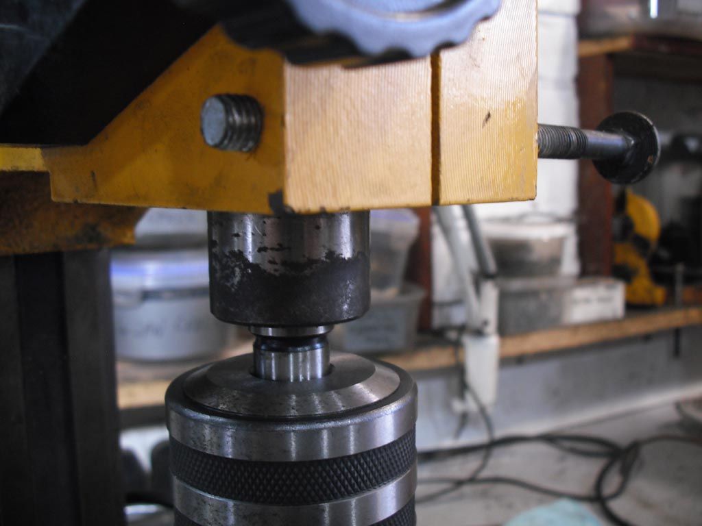

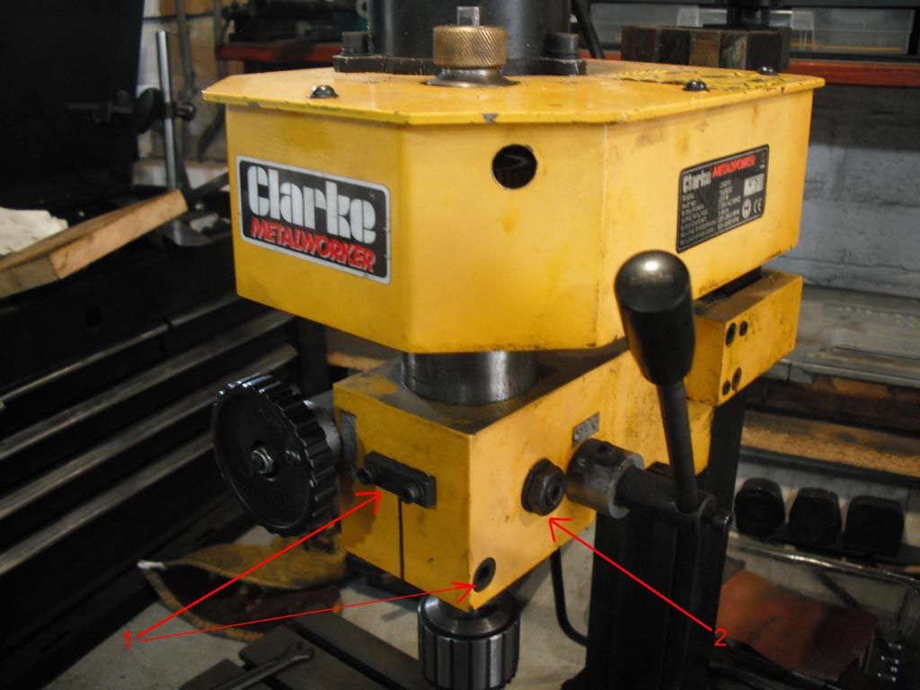

        In the photo, I have marked two sets of adjustments and am curious to know if either of them is the proper lock for the downfeed.
        No1 is a plate with slotted holes and an adjuster screw which would open/close the slit. I adjusted this once when the machine was quite new, to remove a slight bit of play in the quill. I have seen some modification sites where a lever has been added to the screw to use as a lock. This seems wrong to me.
        No2 is a 10mm hex socket screw with a washer and locknut. When the lock nut is released it is possible to turn the screw almost 1/2 a turn in either direction before it stops. at this point the down feed is locked. The screw is not even shown in the manual that came from Clarke. An on-line manual shows it as an adjuster screw in the exploded diagram, but there is no mention of it in the user instructions. I would just like to know if it's OK to use this as a lock or would I likely to cause some damage. Hopefully someone will know.

          Anthony,
          I don't have the Clarke, but do have an Axminster Micromill, which is basically the same machine.
          Mine doesn't have the plate with slotted holes, but does have the allen screw screw you have labelled "1" and it is this which is definitely the quill lock! I replaced the allen screw with a handle, on mine.
          The other socket screw, with locknut, is set to minimise the play on the quill I believe – the screw bears in a slot which runs down the length of the quill, hence why it locks the quill when tightened. I'd use the other one as a lock, if I were you.

            Number 2 is probably a peg in the slot to stop rotation of the spindle sleeve and everything attached to it. A small amount of peg rotation may act as an adjuster to minimise rotation but still allow movement up and down. Plate item 1 looks to be a spacer for mounting the chuck guard on judging by the photo on the Machinemart web site. Screw item 1 as Tom said.
            Martin C
            Ps on parts list item 2 is 144, 145, 146. Badly drawn assembly diagram.

              No 1 is used to mount the rather annoying guard on my SX-1 mill – there was a mod by Meek? to add a lever to No2 to easily lock the quill

                I recently purchased one of these and it's still shiny & new but yours looks as if it's seen a bit of service. Working on the premis that both our machines are identical and there haven't been any upgrades/changes, number 1 is actually two seperate things.
                As Frances notes, the flat plate held with 2 small setscrews, is a load spreading plate for the annoying plastic guard. It serves no other purpose other than to prevent the screws digging in to, and weakening, the plastic guard.
                The other part (the recessed M8) is I believe, a very primitive method of taking up play in the main spindle sleeve. I had a go at nipping it up to try and get rid of a slight wobble in the spindle box but it very quickly locked up the whole head assy! As I said, very primitive.
                I believe number 2 is supposed to be the quill lock but again, it's another very primitive effort that would benefit from a lever or handle so searching for the mod that Frances refers to might be worth a go. To date though, I haven't found a need for it.

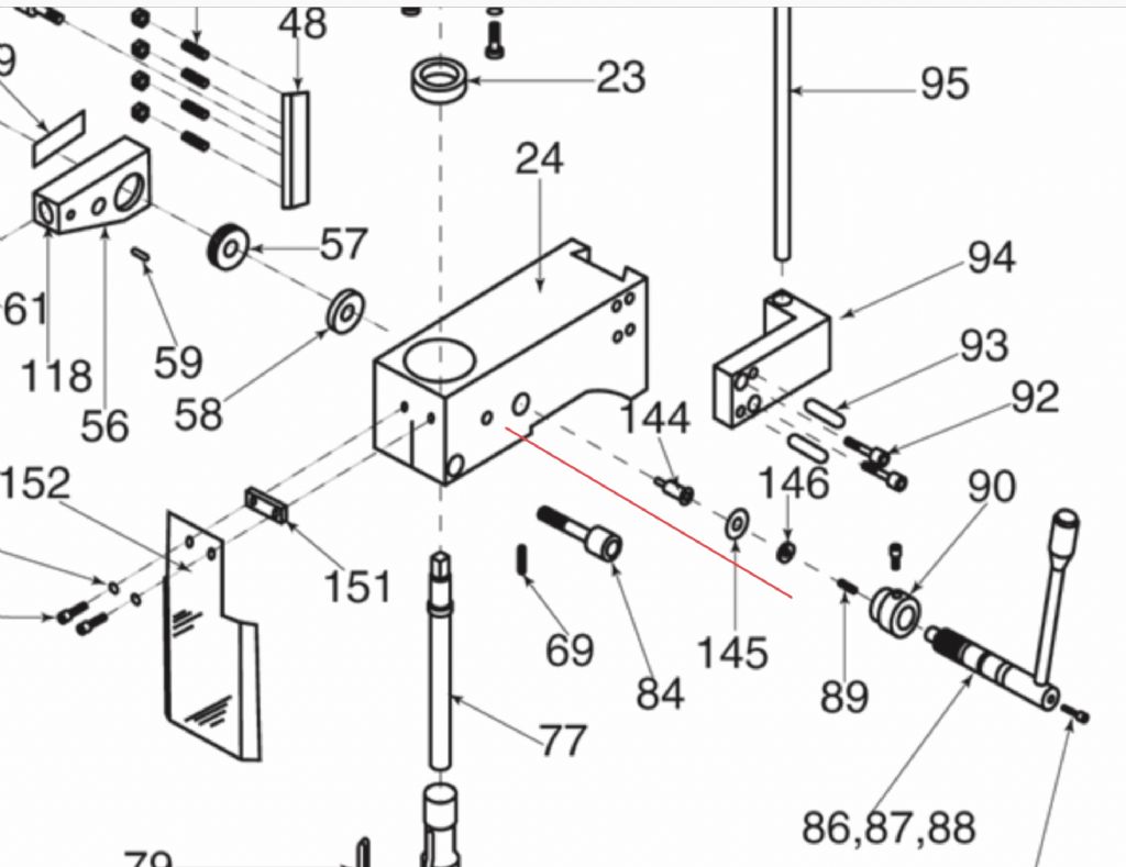

                      I have just looked at the exploded diagram in the manual: **LINK**
                      https://www.clarkeservice.co.uk/manuals/metalworking/CMD10_Milling-Drilling_Machine_Rev_3.pdf
                      Martin Connelly is quite correct … 144, 145, 146 are misplaced
                      That group should be shown where I have drawn the red line.
                      Note: This is not a locking mechanism
                      There appears to be no independent lock, so [short of making one] you will need to use 84 for the dual purpose of adjustment and locking.

                        The equivalent manual from Axminster has a better illustration
                        [albeit with different numbering] **LINK**
                        https://discourse.southlondonmakerspace.org/uploads/default/original/2X/8/847b6cb747dff1f9a57ef30bef34b92ba9fa1d59.pdf
                        Edit: It also includes these magic words [stated twice, at the wrong locations] on p19
                        Ensure that the quill is locked in position before milling is commenced.

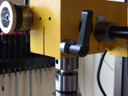

                                      Found the ref to Meek's locking handle – was in a now deleted thread (think Meek had some contretemps with the forum + deleted his posts including the image I hope it is ok to post this smaller version
                                      He commented "
                                      I have also added the the spindle lever lock with a combined thrust race to make the adjustment easier as well as a Belleville washer to make the lever stay put when the spindle is un-locked."

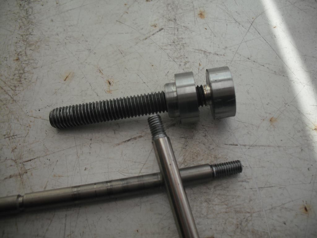

                                              Sorry guys. the screw has definitely NOT bottomed out in the hole, because it goes ALL THE WAY THROUGH. I've only had this machine since 2008 so I can't understand why I've never noticed it before.
                                              I'm really getting peed off with this now as I spent some time this morning making some potential levers (spindle and lock nut) before I tried the hex wrench in the supposed locking screw. Doh!

                                                  I have come up with another idea. Make and fit a collar to go round the quill, under the casting. There looks to be plenty of room. Fix the collar up to the casting. If the collar was fitted with a cotter, locking the quill would be easy. The hard part is fitting it as it looks like a major dis-mantle plus knowing where it's safe to drill and tap the casting. I will have a look and see if I have a suitable sized piece of steel for the collar. I must admit I have never liked the split casting way of clamping things.
