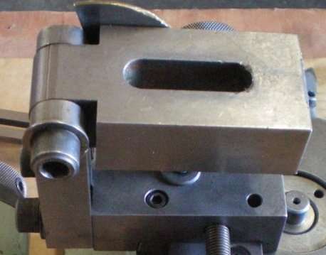

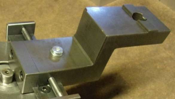

            For the Radius attachment I need the measurements of the “Z” piece that attaches to the dovetail and the workhead attaches to, the dimensions of the workhead for the radius attachment I found on the Bedroom Workshop
            Is the workhead for the radius attachment made of cast iron or aluminum
            This is the MKI
            MK1
            Or alternatively the dimensions of the MKII, all three pieces

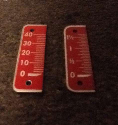

            Does anyone have this scale that measures grinding head rise and fall?
            Just wondering if the scale is actual size ie 1/2″ = 1/2″ or it is scaled so that 1/2 on the scale = 1/2″ rise/fall of the spindle measured at the spindle shaft.

                    Hi Ian, I’ve done a couple of drawings of the Swan Neck from a Mk11 radius attachment which I think is what you require. I’m struggling to load them onto this site even though I have converted them to JPEGs from PDFs
                    Not sure if there is a facility to Direct message on this site but possibly best if I email you the documents directly?
                    I’ve taken some photos too but struggling to attach them also.

                        I have my Mk 1 to hand. The Z piece is an iron casting. It is 1.75″ wide, The the bit with dovetail is 0.950 thick and 2.90″ long. it is 2.215 tall in the middle and .715″ thick, the top is 0.562″thick and the key is 0.090″ on top, 3.08″ long. length overall is aprox 5.25″. Hope this makes sense. Noel.

                          Renardiere7 is sending me the drawings of the MkII “Z” piece.
                          Looking at photos of the MkI and MkII Radius attachment it looks like the only change was the articulated “Z” piece and the workhead, all the base “looks” the same for both. Is this correct??
