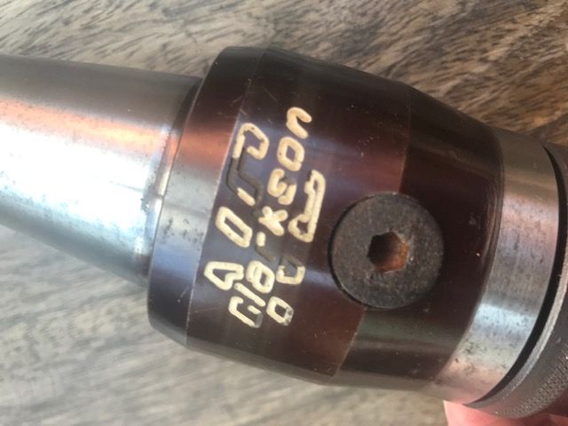

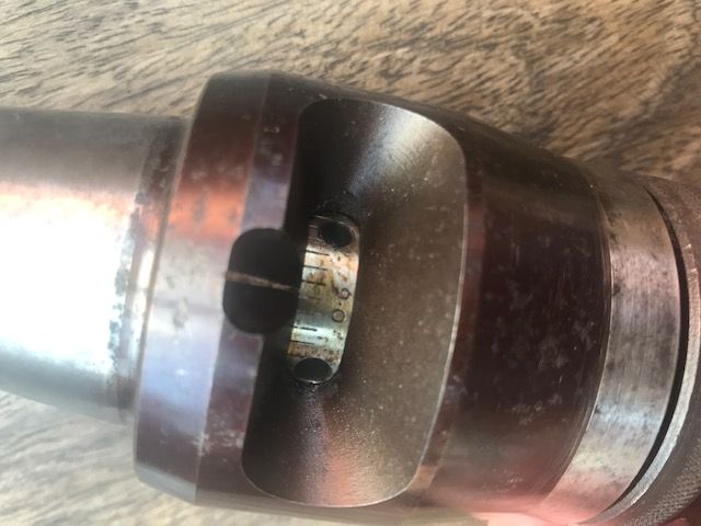

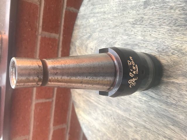

      img_2885.jpgimg_2884.jpgHi Guys, Hope everyone is staying safe.
      As we all seem to be doing a little 'housekeeping' in the enforced lockdown I have discovered a long lost item that was given to me by a retired engineer from the Clarkson Factory in Nuneaton.
      The problem is that I don't know what it is – other than an Autolock 40 Int chuck. But it has an adjuster which is calibrated by 0.02mm divisions. I suspect that the adjuster alters the centre pin, which engages in the back of the normal Clarkson type threaded cutter, to set the tool protrusion from the chuck. This would probably mean it is Clarksons attempt to emulate 'qualified' tooling for emerging CNC machines with minimal change to their stock list. Just a guess that, anyone got any other ideas?
      There are some markings faintly etched on the straight potion of the shank which states:-
      40 INT
      BRPAT
      30371 /69
      England
      I take it the BRPat means British Patent 30371 / 69 with the 69 signifying 1969 year. I've done a patent search but so far not been succesful in turning anything up for this number.

        #469435
          30371 /69 may be an Application Number, rather than a granted Patent Number
          Finding those is much more difficult … but I will have a go

            #469450
            Kiwi Bloke
              @kiwibloke62605
              'I suspect that the adjuster alters the centre pin, which engages in the back of the normal Clarkson type threaded cutter, to set the tool protrusion from the chuck.'
              Yes, that's it. They were originally used on NC machines, with tool automatic changers.

                    Oily Rag
                      @oilyrag
                      Thank you Kiwi and Dick,
                      Thought that it was something to do with qualified tooling given the date assumption of 1969. Dick, the patent document is helpful as I'm trying to work out how to disassemble the sleeve (21) – it is pretty tight in the body and needs to come out to insert the 'normal' Clarkson split collet (22)
                      Must be quite rare as I've never seen one of these before.

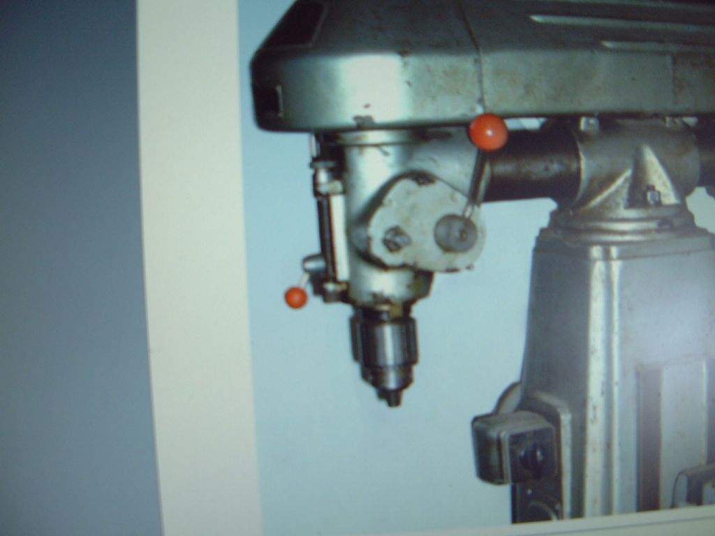

                              Good Morning Gents,
                              Hope you are all well and keeping busy!
                              Sorry to change the topic here, but you are all chatting about Clarkson fittings, and I wondered if any of you could assist me here. This is a photo (I just took from my PC screen as it had to be Jpeg!) of a Beaver Mill, which I have, with a drill chuck. which I assume is the standard Clarkson 30 Int taper. I usually use the Myford drill chuck, set into a Clarkson 2 MT fitting, but this then becomes quite long and limits the size of the drill I can use.
                              My question is, are these drill chucks available/obtainable anywhere? Obviously I'd like to get hold of one.
                              Thanks for reading this and apologies again for butting in here.
                              Geoff

                                DC31k
                                  @dc31k
                                  Posted by Geoffrey Wright on 06/05/2020 12:18:55:
                                  …a Beaver Mill, which I have, with a drill chuck. which I assume is the standard Clarkson 30 Int taper. I usually use the Myford drill chuck, set into a Clarkson 2 MT fitting, but this then becomes quite long and limits the size of the drill I can use.
                                  Geoff,
                                  It is a little difficult to answer your question as you are using terminolgy in a non-standard way.
                                  The taper in the mill is 30 INT, also known as NMTB 30, ISO 30 and most generically as '30 taper'. It has nothing whatsoever to do with Clarkson, who were a manufacturer of tooling. Clarkson-made tooling is available in many different tapers.
                                  Your description of using the Myford chuck sounds like you have a 30 taper (male) to 2 Morse taper (female) adaptor.
                                  Your drill chuck itself will have a female Jacobs taper in it, known as a JT (possibly, if it is quite modern, it may have a B-series taper). So the Myford chuck you have has a 2 Morse to xx JT arbor poked in the back of it.
                                  To mount a drill chuck into the 30 taper spindle, you need a 30 taper (male) to appropriate Jacobs taper (male) adaptor. It is not normal to swap drill chucks between arbors, so if you want to use a drill chuck in both the Myford and the mill, you need two chucks and two arbors.
                                  As an example of the breed, have a look at:
                                  https://www.arceurotrade.co.uk/Catalogue/Chucks/Drill-Chuck-Arbors/ISO30-Drill-Chuck-Arbors
