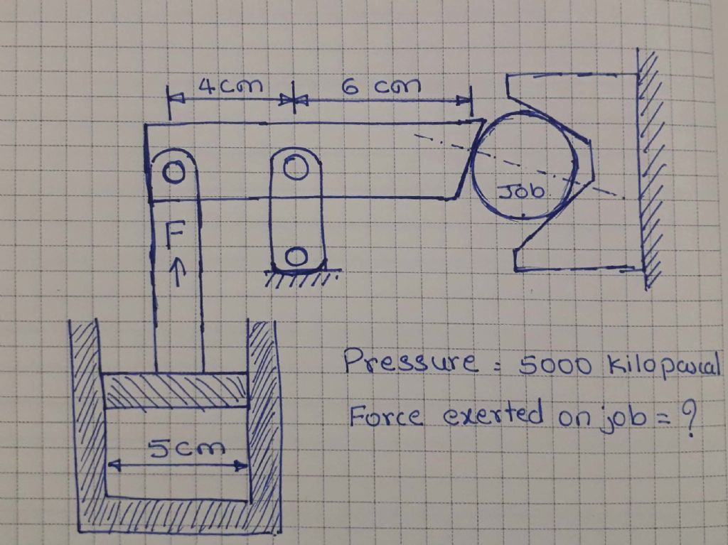

      clamping force calculation_1(2).jpgHi, I need to calculate the clamping force. Details attached.

        #468460
        Robin
          @robin
          I think we are all wondering what you are pushing against?
          The answer depends on the angle of that driving face.
          Approx 1 ton
          #468497
          RAMA HEGDE
            @ramahegde42374
            The job is circular bar and it has been pushing against V- block.

                  Since you show a pin joint at the base of the middle arm, there will be no clamping force as you have drawn a mechanism. The horizontal arm will try to move to the left due to the wedging action at the right of it and will result in the piston tilting in the cylinder and all pressure being lost.
                  To make this statically determinate, you need an encastre joint at the base of the middle leg and to specify the angle at the right hand end of the horizontal arm.

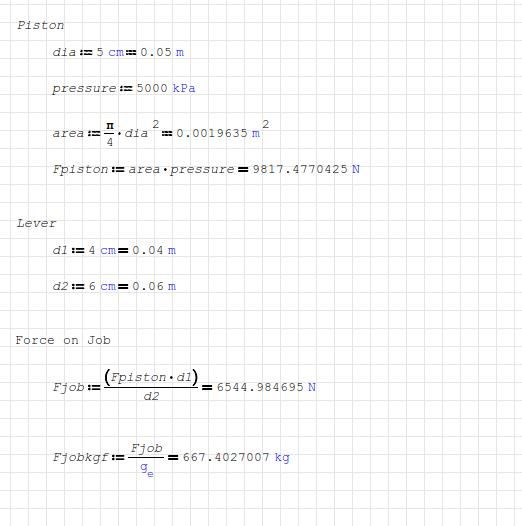

                        Here's my attempt at the calculation, done with smath studio (free software) for which I am eternally grateful to Mr Duncan Webster of this Forum. Lots of good things about smath, in this case I use it to finesse the units automatically into consistent Metres/Kilograms/Seconds, and exploit built in values for pi and the gravitational constant (approx 9.81).
                        Ought to warn I am famously bad at maths! Much prone to silly mistakes, getting the wrong end of the stick and missing bits out. Double check everything, I'm liable to do things like get the lever the wrong way round. (Here I hope the lever reduces force on the job by 4/6…)
                        My answer: about two thirds of a metric ton. Hope it's right!

                              SOD's sum gives the force acting vertically down, to get the force pushing the round bit into the vee block you have to allow for the angle of the end face. Then it gets involved in friction, which is never a known quantity, and I haven't had my weetabix yet. As Robin says, need to know the angle of the push face, and the exact relationship between the pivots and the bar, if they are not in line it changes the answer

                                +1 for DC31k's analysis.
                                The system as drawn will not act as a clamp at all.
                                The "Centre Fulcrum" at the base of the vertical lever is shown as a pivot and is not rigid at all, so as the pressure in the cylinder rises the horizontal lever will press just a little on the work and then move to the left as there is nothing to restrain it from so doing.

                                    The base of the pivot point is clearly shown as grounded (slanty lines underneath), it won't move anywhere as long as it doesn't snap. We must assume the base of the cylinder is similarly prevented from moving down, but I think that is a safe assumption.

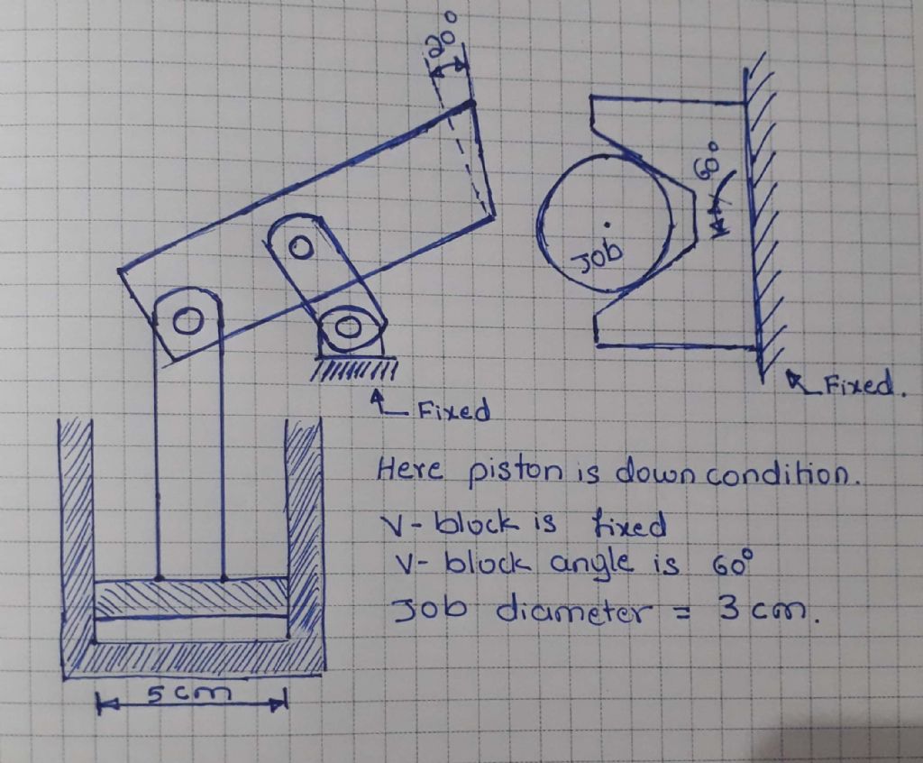

                                        RAMA HEGDE
                                          @ramahegde42374
                                          Hi,
                                          Here I am giving little more details.
                                          Please find the image. Initial condition
                                          #468616

                                            Ah just had another look at the sketch, I'm in error. Because there is a little link between the lever and the fixed pivot all the side load will be applied to the top of the piston rod, which has no sensible means of resisting it, so it won't work.
                                            Strange how you sometimes look at something and see what ought to be there, not what is there.

                                              1. the title 'Clamping force calculation' indicates the drawing is to identify dimensions rather than being an engineering design.
                                              2. The cylinder & piston is round rather than square.
                                              3. The piston can't tilt.
                                              4. All the fixed points are firmly grounded on Planet Earth. (But the answer in Newtons is OK for other planets!)
                                              5. Friction is zero, ie the piston and joints are all 100% efficient.
                                              But your other post mentions the angle of the lever on the rod as being relevant. I missed that!
                                              So, if the angle at the end of the lever is 20°, what is the force F on the job, and F1 and F2 on the V-Block?
                                              Back at school my mathematical humiliations were only in front of the whole class. Now I'm messing up on the internet!
                                              smiley
                                              PS This post crossed with Rama's clarification.  I guessed 20° correctly!  Amazing.
