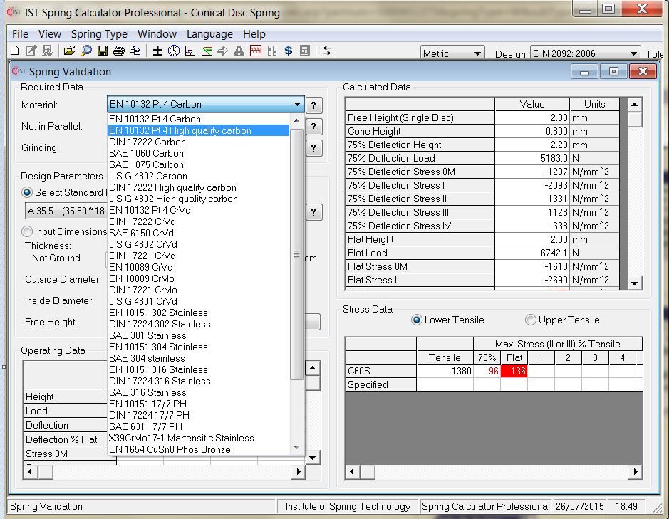

                          Muzzer
                            @muzzer
                            Neil – when you say "spring steel", bear in mind there are many suitable steels that can be used. Here's a selection:
                            spring materials
                            If you search "DIN 2093" in Google Images, you will see the standard sizes for (metric) disk springs. There are lots of tables showing them.
                            Murray
