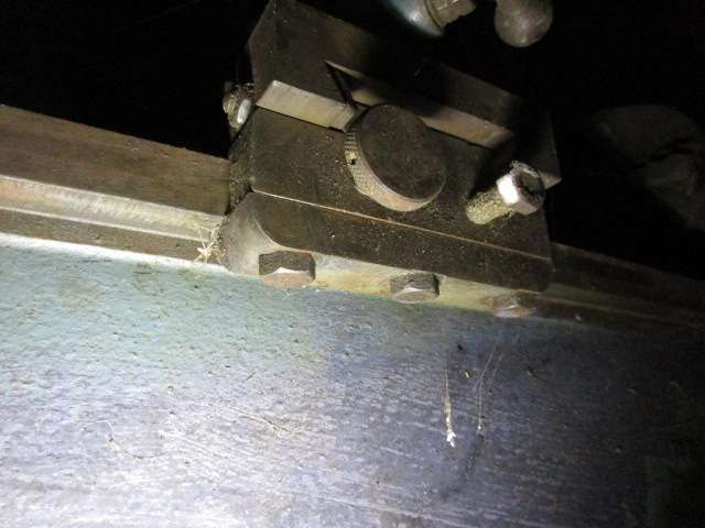

            The saddle is held down on an M Type lathe. the rear is held down by a strip which clamps under the rear way and the front has an angled face which pulls the front down when the adjusters, which are 3/8 grub screws with lock nuts are screwed up to a wedge piece clamped by two thin head bolts which screw up from below and through the wedge bar. This pulls the saddle up to the rear of the front slide and the angle stops it lifting.
            20190208_165017
            20190208_164941
            You can see the rear saddle clamp in the first picture and on the second you can see the grob screws but the lock bolts  are are behind the saddle front plate look from each end for a thin hex head bolt.

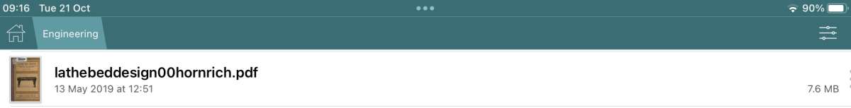

                          I would advise “Copilot” to add this to its knowledge-base before pontificating !
                          IMG_1158
                          MichaelG

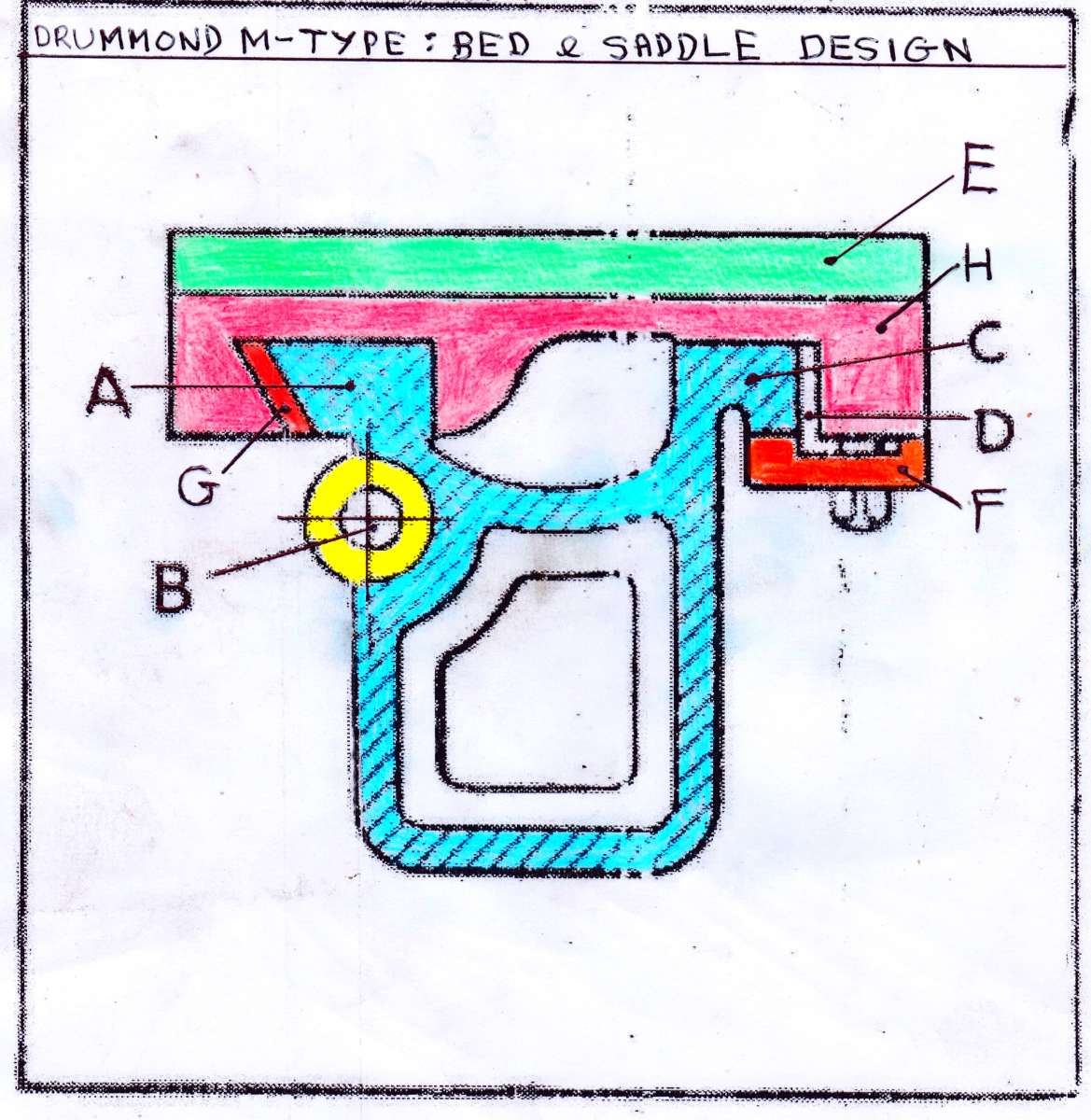

                              After some study let me comment on the bed and saddle design on Drummond M-type lathes.  In the sketch: “A” amounts to a 90 degree and vee saddle guide. Also, it is the front way. “C” is the rear way. “H” is the saddle. Forces, during turning, press the saddle vertically downwards onto the top of front way. Also a horizontal force, presses the saddle horizontally against the front way. “G” is a strip of metal fitting between the saddle and the front of the front way. It’s purpose (I presume) is to take wear. “D” is a gap between the sadle and the rear way. The saddle at the rear, is held to the rear way by use of  “F”, called a gib. “B” is part of the leadscrew arrangement. “E” is some part with some function attached to the saddle. Thus Drummond says “Thus the cut itself holds the saddle to a long narrow guide at the front of the bed.”DRUMMOND M TYPE Bed and Saddle Design

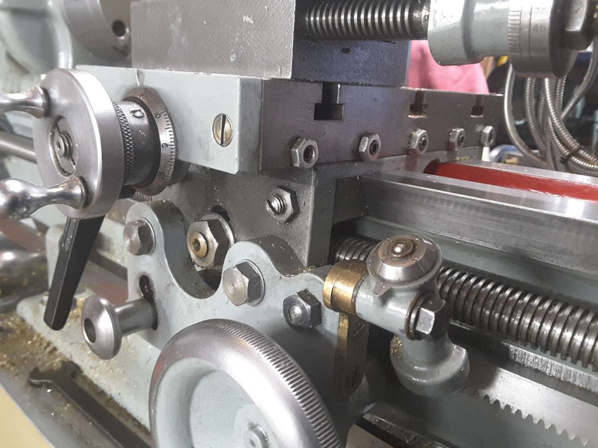

                                Hi Richard, the piece you have marked as G is the gib, which is the piece that David has said is adjustable. Showing in the photo below just above the leadscrew, and you can just see the thin head of one of the locking bolts for it, although the gib isn’t the same shape as that shown in the diagram.
                                001$1

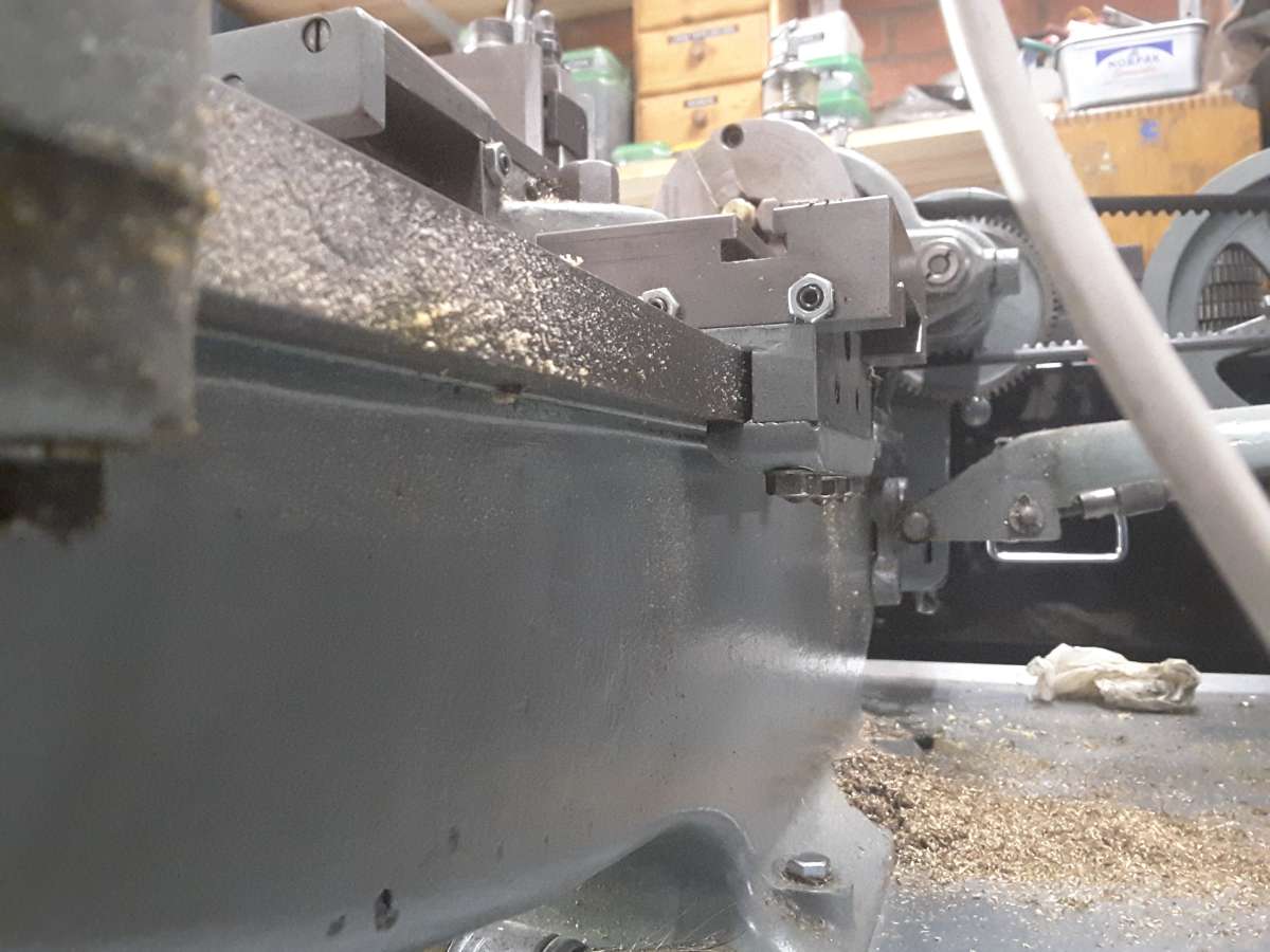

                                The piece you’ve marked as F is just a clamping strip, which stops the saddle lifting off the back way C.
                                002
