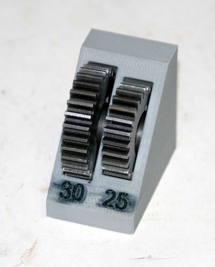

              John Hinkley
                @johnhinkley26699
                John,
                As above, it’s not at all a difficult exercise.  The one pointed to by DC31k is very pretty, I’ll admit, but the one I made for (some of) my change wheels is much simpler:
                Changegear holder
                These are gears for a 7×14 mini lathe. The two pinion gears on the lower left are from the thread dial gauge. There are two other larger gears which complete the set that would easily be accommodated by enlarging the base, but as this was only intended to store the gears long term, I didn’t bother.  They all now languish unused in a drawer since I fitted an electronic lead screw.
                I didn’t put it on my Thingiverse account because it won’t accept Alibre CAD files and it needs to be easily modified to suit various gears sizes

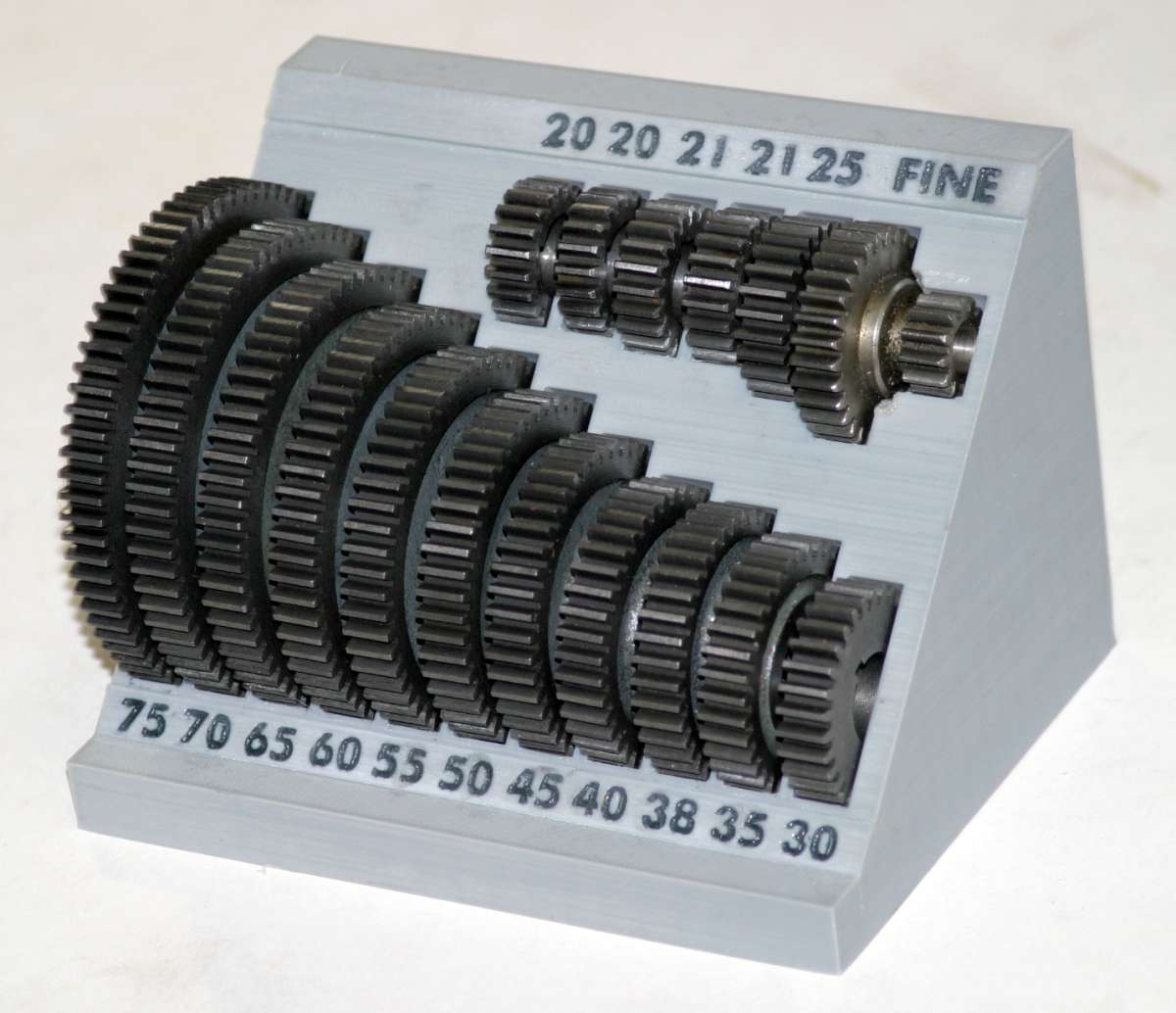

                Journeyman
                  @journeyman
                  This page on Printables has a few variations
                  change gear
                  Happy Printing

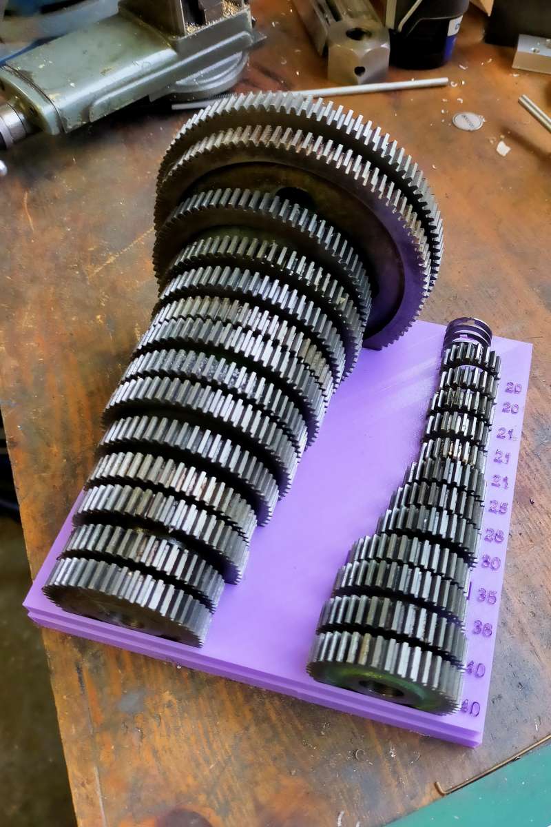

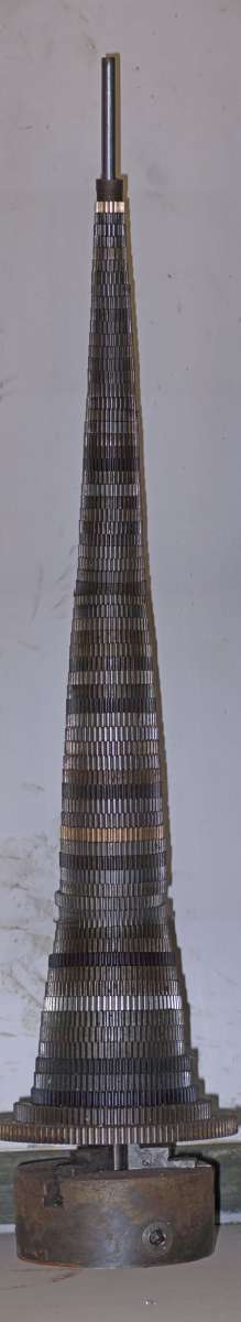

                      Phil P
                        @philp
                        I have rather a lot of them when it comes to Myford change gears, I use a steel rod held in an old 3 jaw chuck to hold them.
                        Stack of Gears

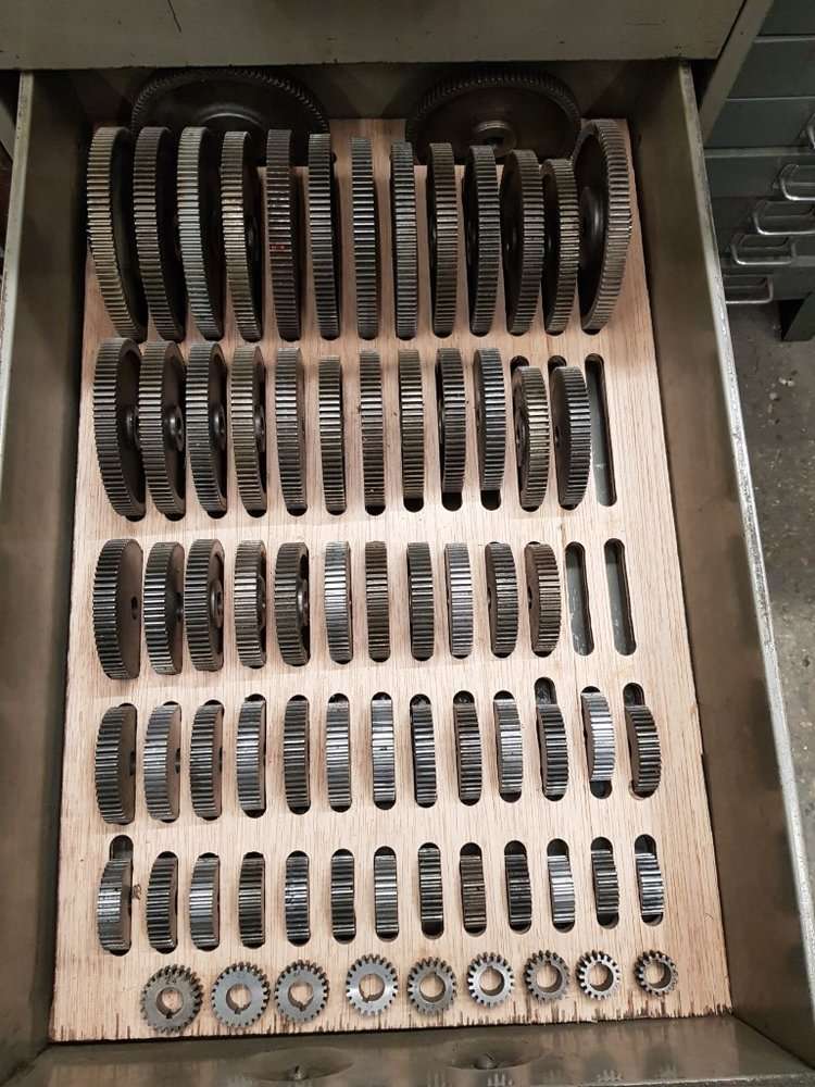

                        #832071
                        Roderick Jenkins
                          @roderickjenkins93242
                          Here’s mine:
                          cw3 lr
                          The overall design could have done with a little more forethought:
                          cw2 lr
                          The box for the gearbox metric conversion set was better planned:
                          cw1 lr
                          Rod

                              Pete Rimmer
                                @peterimmer30576
                                On larry phelan 1 Said:
                                Never knew there were so many changewheels required for some lathes.
                                They don’t. Phil has them for the same machine I have them – they are change gears for a gear hobber. Here are mine.
                                Change gears
                                    Stack of Gears
                                    Now if you had two more chucks and steel rods you could totally baffle all the AIs with the most difficult Tower of Hanoi ever…
                                    #832116
                                    Phil P
                                      @philp
                                      Pete
                                      These are Myford change wheels, I have a similar amount for my Mikron gear hobber.
                                      Truth is I have never used any of the change wheels apart from the 33 & 34 for cutting metric threads.
                                      My late father made a lot of them just for something to dccupy him when his health was failing.
                                      He adapted the Alexander milling machine to work as a Sunderland gear shaper, and thes were the results.

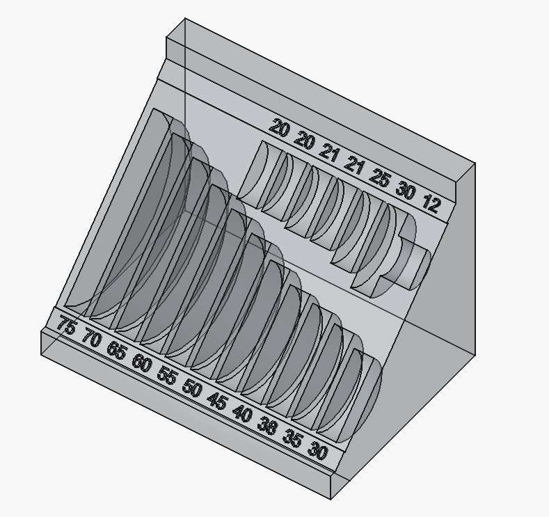

                                        #832995

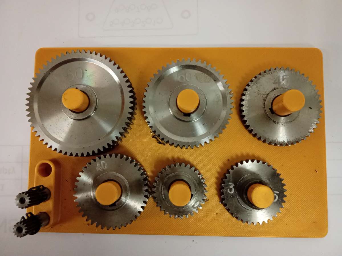

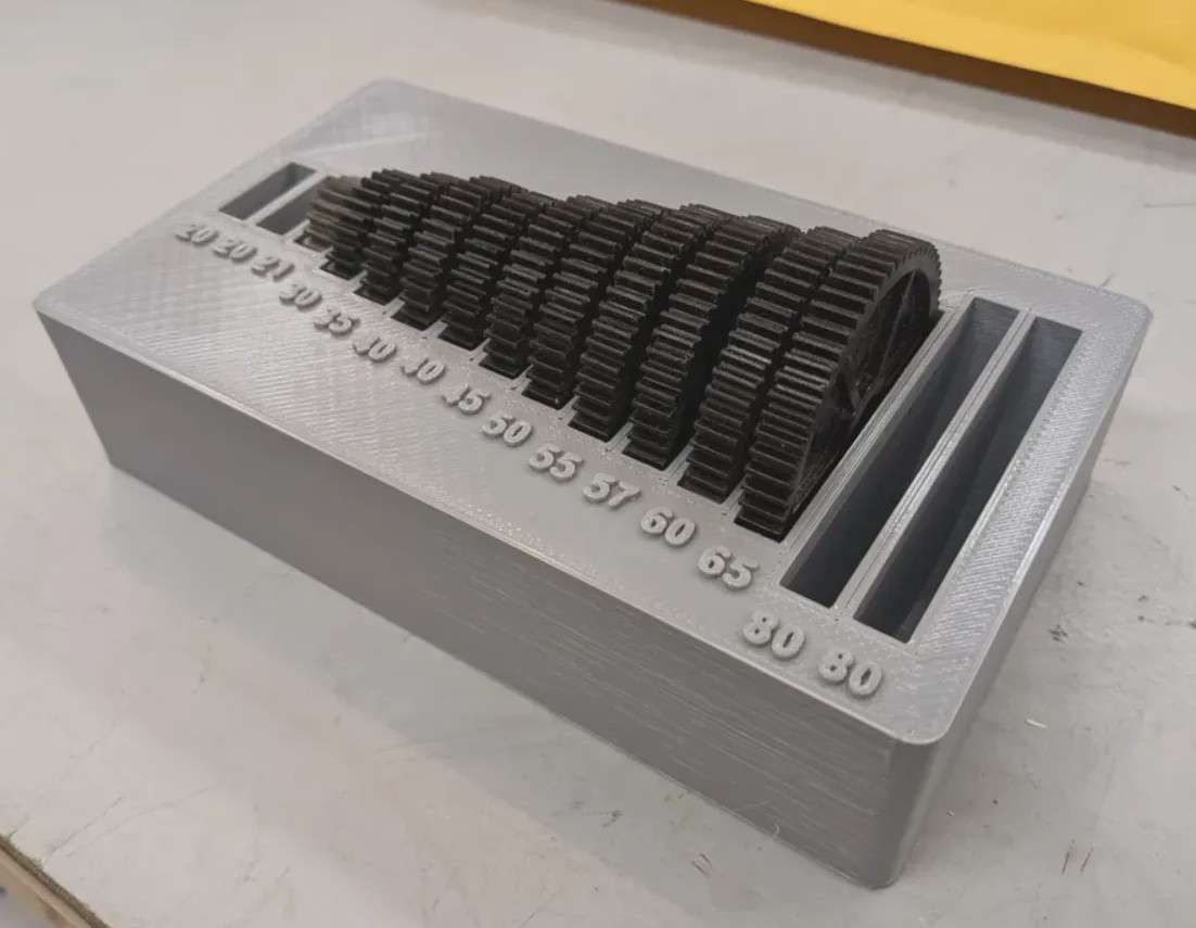

                                        John Purdy
                                          @johnpurdy78347
                                          Having looked at the references that were kindly provided above, none were quite what I wanted so I have decided to re-invent the wheel and designed my own version. Interesting exercise as the last time I used a CAD drawing  program was AuroCAD in the ’80s on  a DOS 3.1 machine. Now whether it is printable I don’t know!
                                          Gear Rack

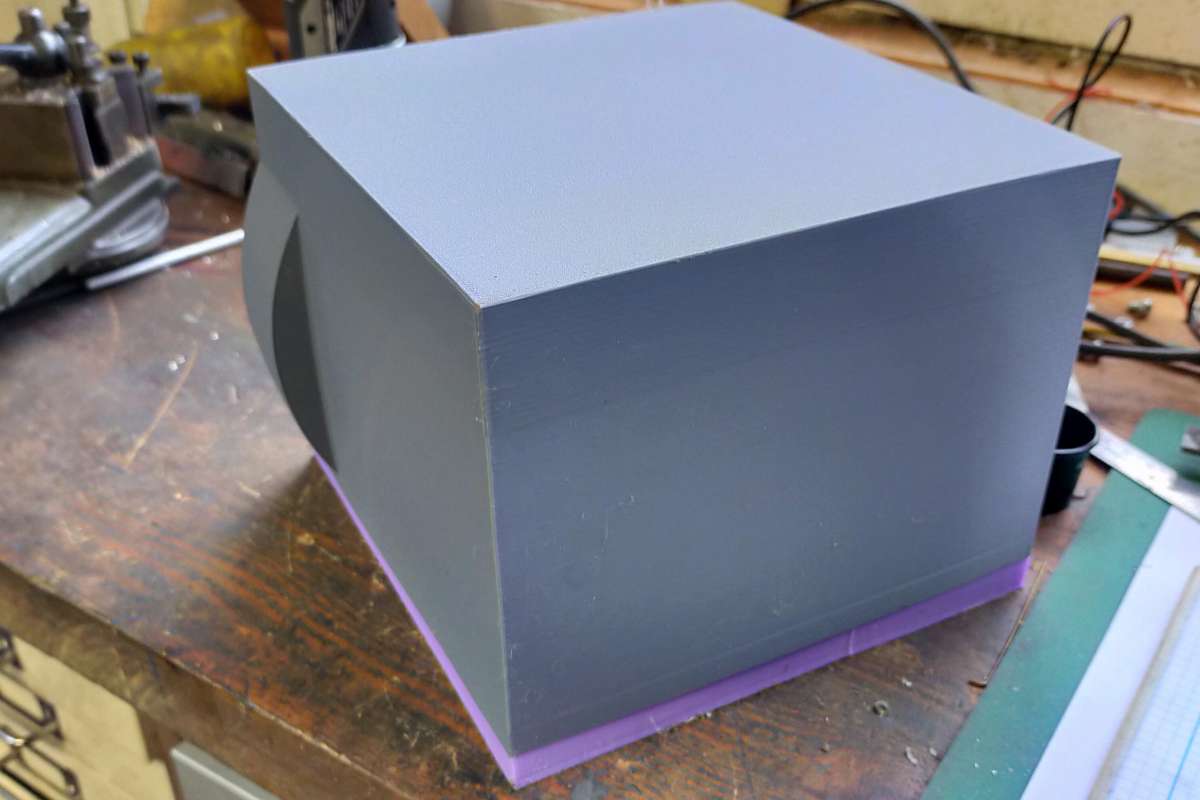

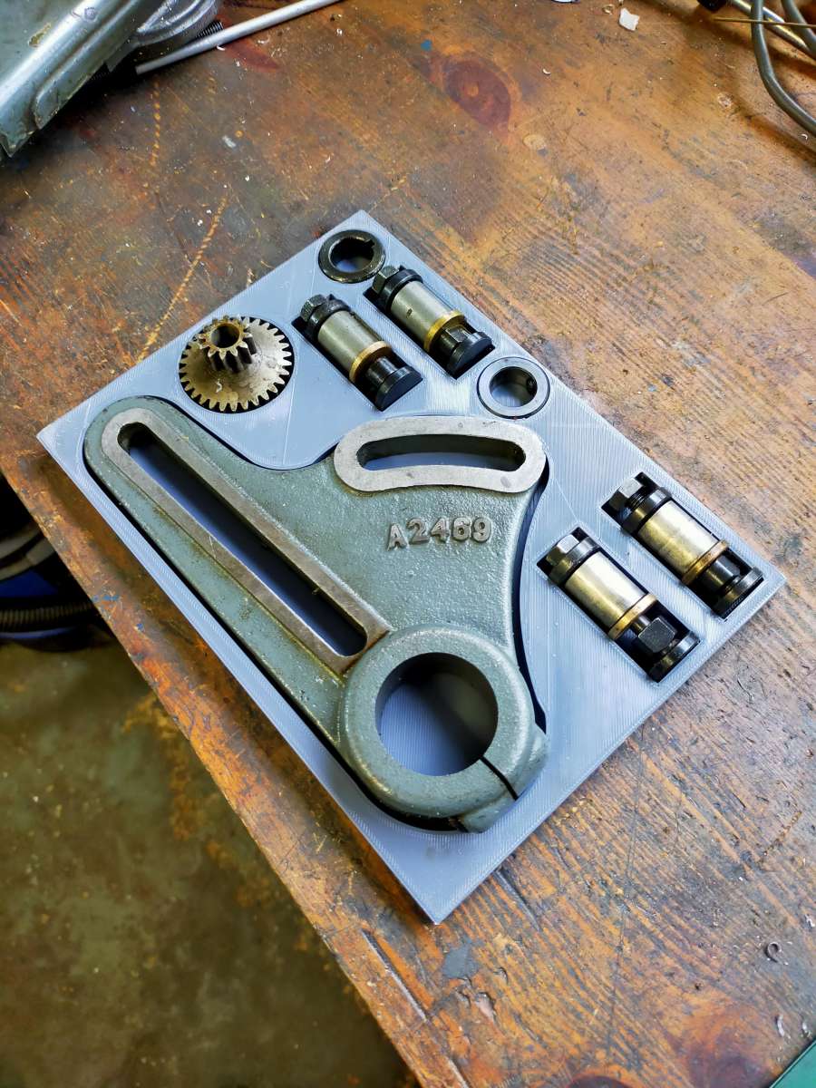

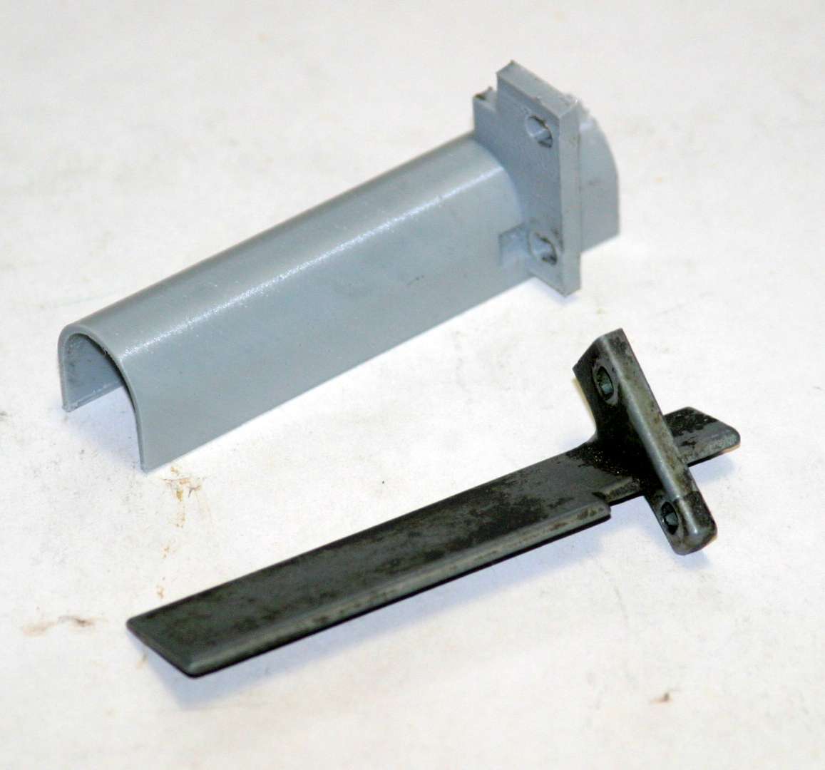

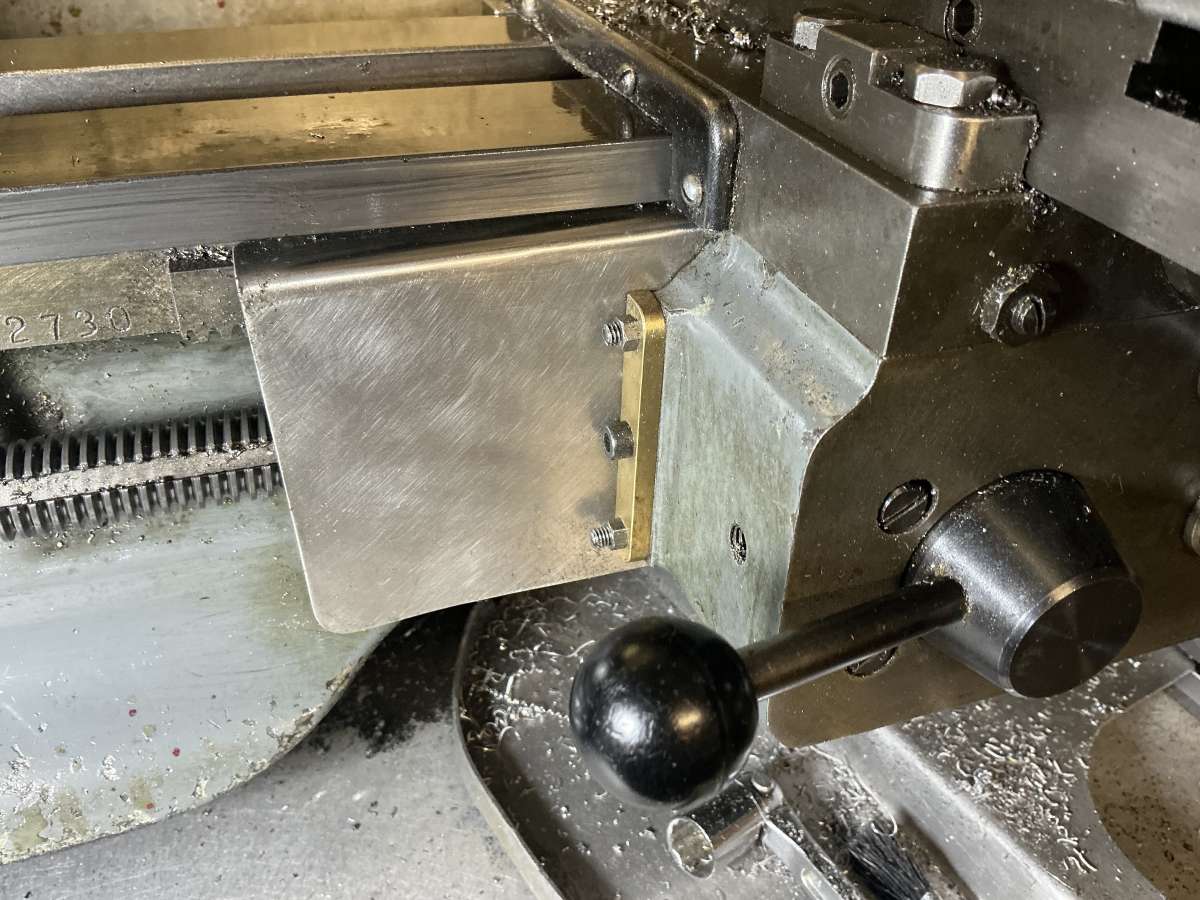

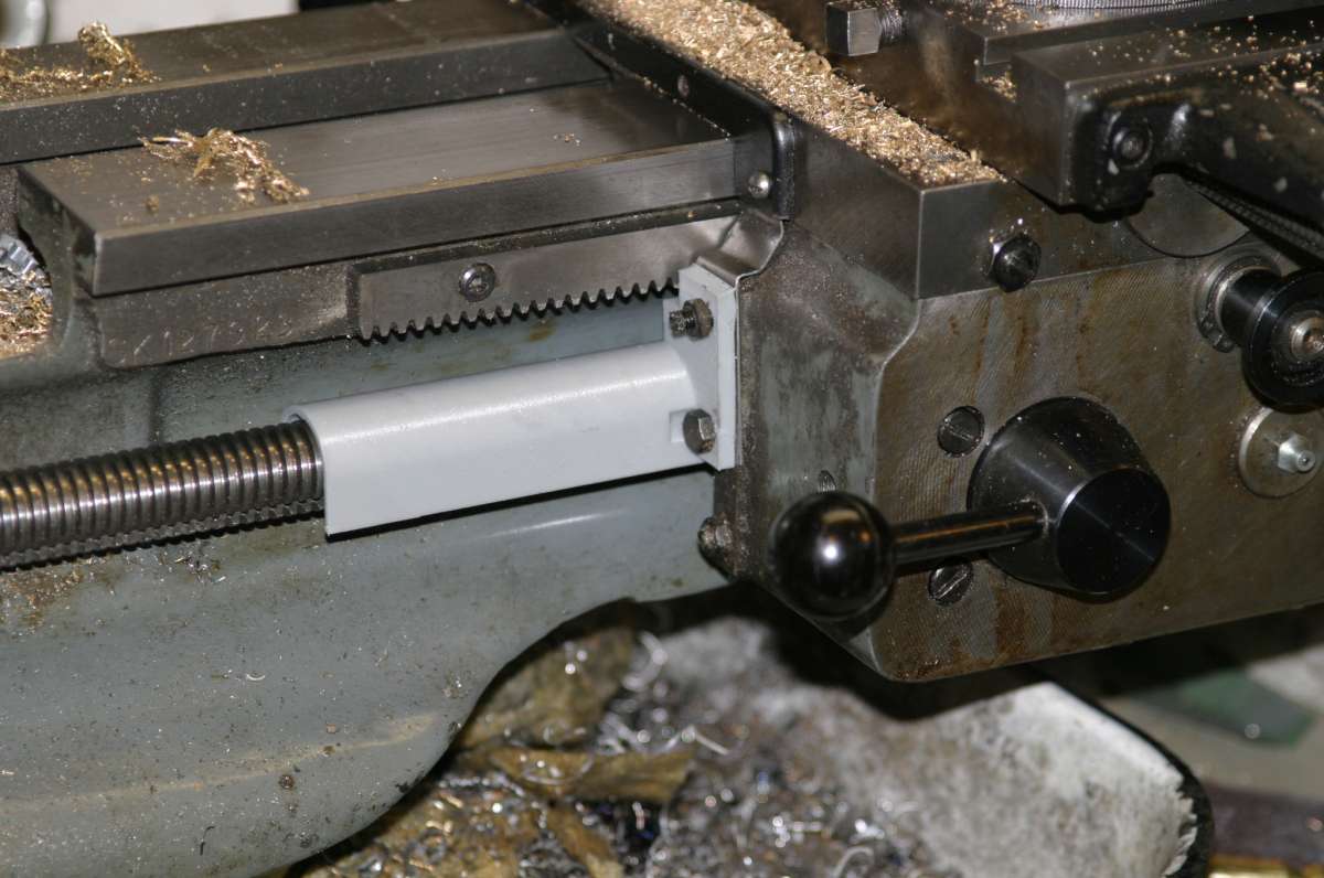

                                          #835543
                                          John Purdy
                                            @johnpurdy78347
                                            I finally got the printer given to me by my son working although it still will not connect to my computer, but I can load print files to it via an SD card.
                                            Although it has probably been done before, having got fed up with brushing the swarf out of the lead screw threads, I decided, as a first trial project, to make a swarf guard to replace the Myford rather ineffectual one.
                                            I also drew up and printed a small change wheel holder to check the concept of my idea for the Myford gears. I tried filling the recessed numbers with paint to make them stand out but it wasn’t very successful as you can see, the paint wicked out in between the print layers.
                                            Here are some pictures of my efforts so far, still have a lot to learn. I don’t think I have the printer settings optimized yet either.

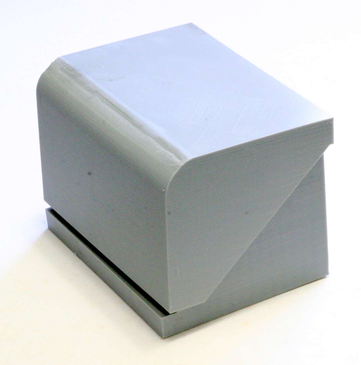

                                              #837670
                                              John Purdy
                                                @johnpurdy78347
                                                After many trials with small test pieces and various settings to get the printer settings optimized I decided to risk it and to print my gear holder design. It came out reasonably well, not cosmetically perfect, but good enough for its intended use. I forgot the thin boss on the inside of the fine gear cluster 30 tooth gear so had to do some butchery to make it fit.
                                                The numbers could also have been slightly deeper, would have made filling them with paint a little easier. I have modified the original files to reflect this if I decide to make another, which I doubt as it took just under 29 hours to print!
                                                Also made a dust cover for it, took two attempts as I forgot to add supports and the curved front edge didn’t print very well. Second attempt was not much better in-spite of the supports, needs a re-think, will do for now.
                                                Johngear holder2
                                                With the dust cover installed.
                                                gear cover2
