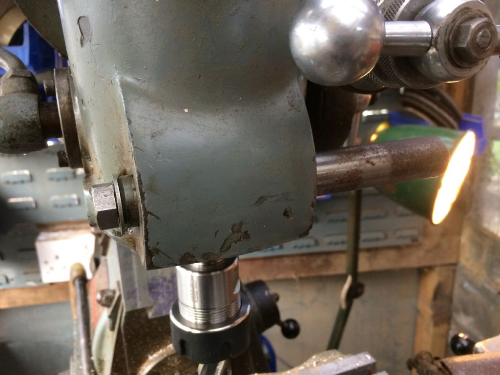

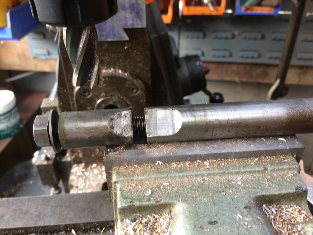

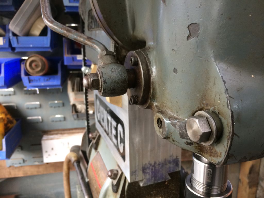

      img_1005.jpgimg_1007.jpgimg_1006.jpgany centec owners that can help with the quill lock on my new mill, all the pics i have seen show a handle and not a bolt, the right hand side sticks out about 3" in the first photo you can see the whole assembley it looks home made the long shaft is threaded the short part is a clearance hole for the bolt. when the bolt is tightened it locks the quill but does not release the quill it needs to be tapped with a mallet this can not be right any help please
      Geoff
      Edited By geoff adams on 07/12/2019 10:32:41

        geoff adams
          @geoffadams14047
          sorry it now the second photo for the assembley

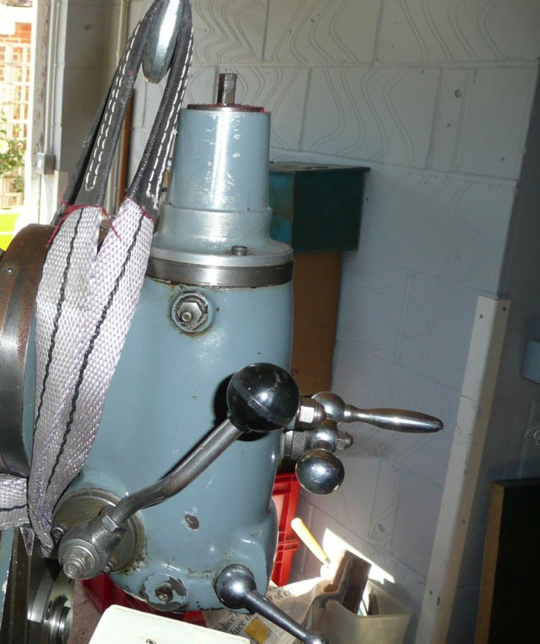

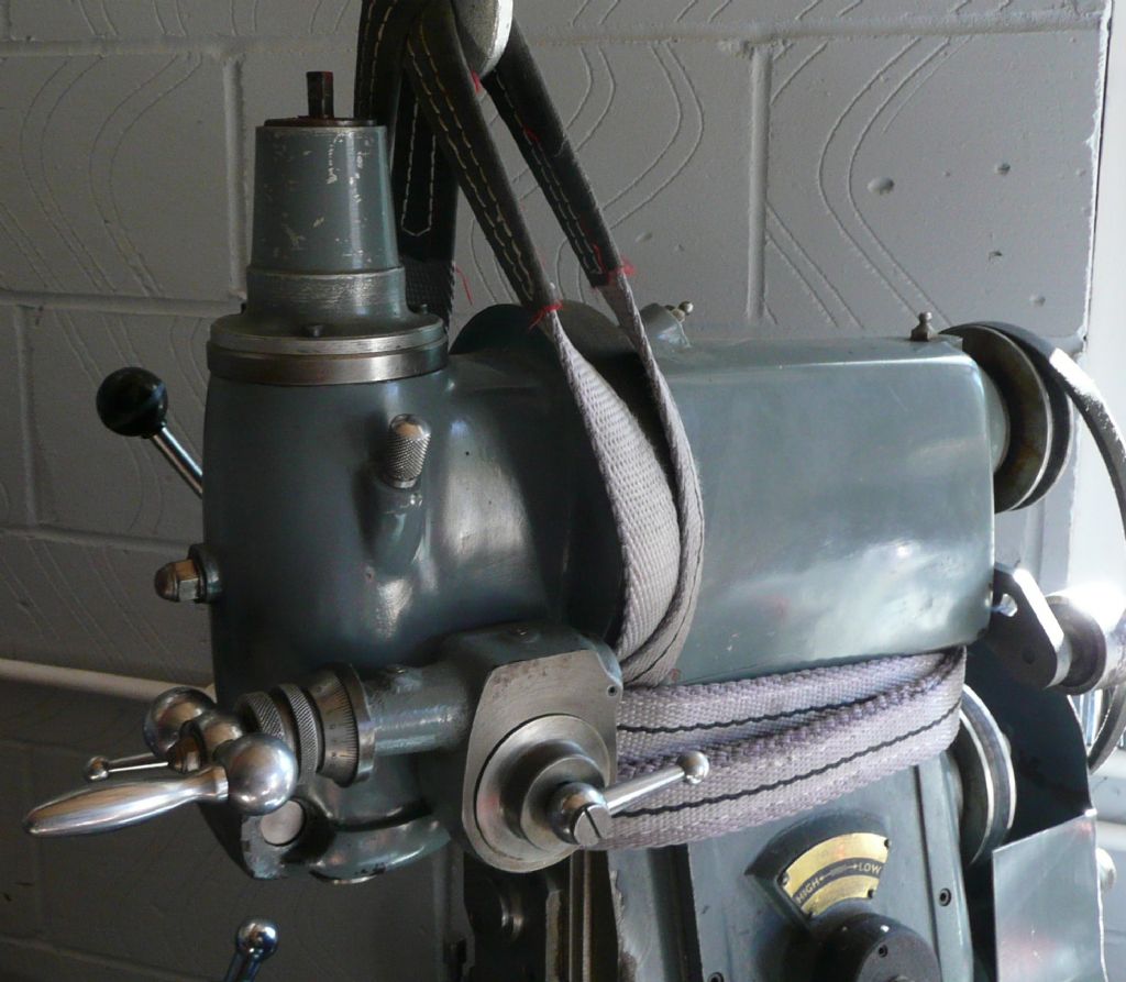

          Old Elan
            @oldelan
            vertical head 2.jpgThat's quite a bodge!
            This is how it should look. If I get a chance I will remove mine and post a picture unless someone beats me to it!

            geoff adams
              @geoffadams14047
              thanks thats what i need is some pics of what it should look like then i can make a new one
              many thanks Geoff

                We have two mills at the museum, a large Taiwanese drill mill and a Tom Senior light vertical. The both use the same style of quill lock as your Centec, the D M one works perfectly and the T S one tends to jam and need hitting lightly to free it. It must be the way the pinch clamps fit the quill. I must look at the way they fit the quill.

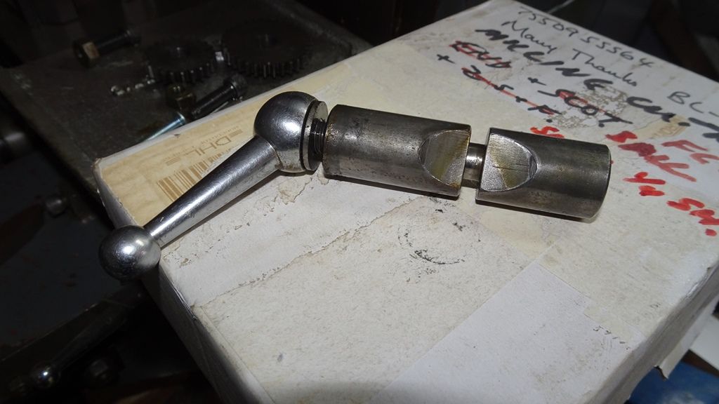

                Old Elan
                  @oldelan
                  Geoff,
                  Just for you I have been out in the cold! wink
                  Body dia. 0.748; right clamp 'bit' 1.144 long; Total length 3.136; smaller threaded bit of right 'bit' 0.378; All one piece; left 'bit' of clamp; 1.438 long, same 0.748 but clean bored of course.
                  The diameter of the lock 'wedge' you can get from the quill of course…. Good choice of mill, BTW.
                  ATB, Roy

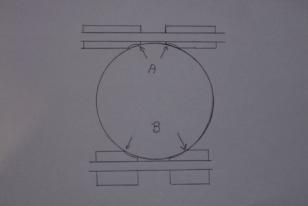

                  old mart
                    @oldmart
                    This is what I think would be the best profile for the locks. First get the diameter of the lock wedges the same as the quill. Then relieve the inboard ends a bit so the outside clamps first. The angle of contact is slightly greater and hopefully less likely to jam in place when the tension is removed. Touching at B would be preferred._igp2513.jpg
