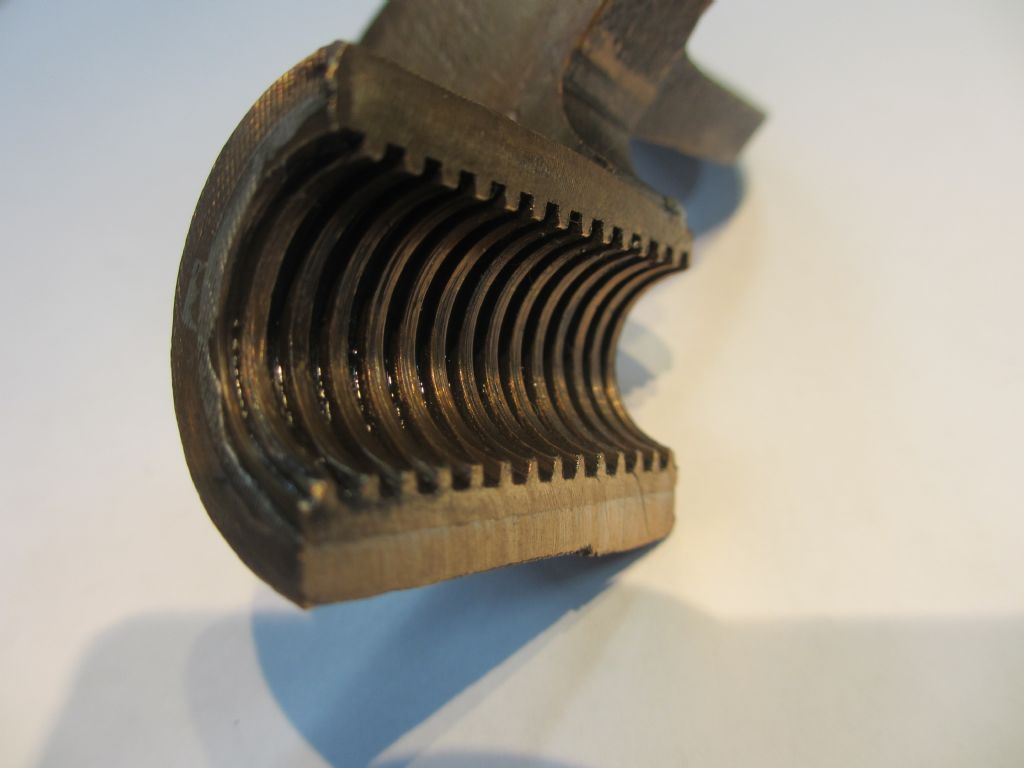

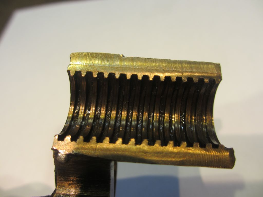

                        T.B
                          @t-b-2
                          Hi
                          I don't know what facilities you have but if you have a lathe and a mill then its very viable to refurbish a worn Centec half nut.
                          I have done it a few times by plunging an endmill down the length of the threaded part of the nut taking off just enough material to remove the worn threads. i think i used a 20mm cutter.
                          Then turn and bore a bronze cylinder the same O/D as the end mill you used and screw cut the I/D to the same thread as your centec feedscrew, probably 10tpi acme or square form.
                          This cylinder can then be soldered into your old half nut and the top half machined off.
                          You can see the excess solder and seam between the old nut and new threads in these pics.

                            T.B
                              @t-b-2
                              The nut shown was done with an old ML7 and the centec that needed the nut !
                              If the screw cutting is daunting you can buy acme taps from the usual model engineering suppliers for not too much money , although square form maybe harder to find.
                              It wasn't even silver soldered , my old plumbers blow torch and solder , not text book i'm sure but it works just fine !

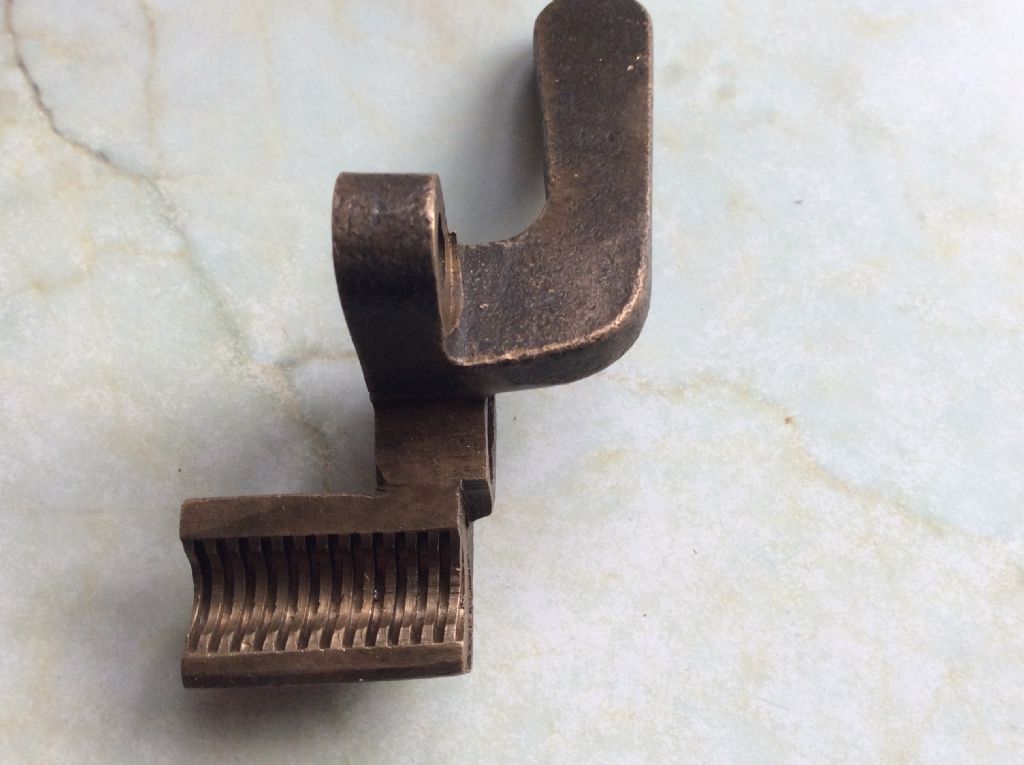

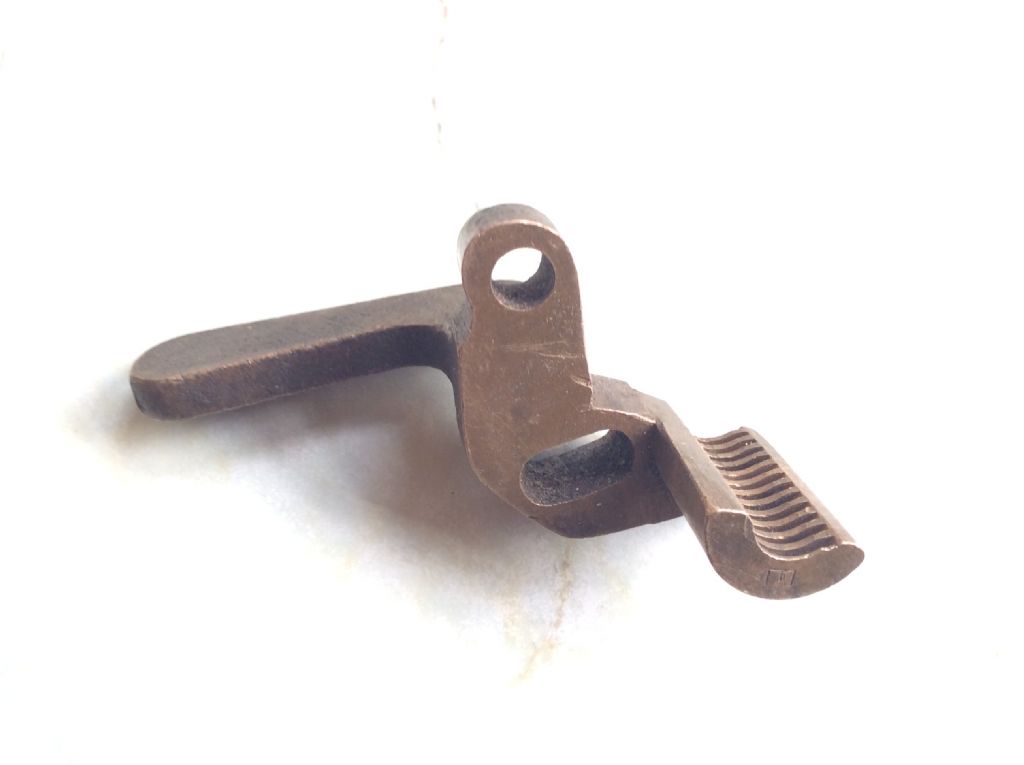

                                                D.A.Godley
                                                  @d-a-godley
                                                  John ,
                                                  Is this of interest ? I believe it’s from a 2a , it is certainly not from my 2b .
                                                  Edited By D.A.G. on 26/03/2019 16:58:41

                                                  #402404
                                                  john anderson 5
                                                    @johnanderson5
                                                    hi dag it looks simillar i ,m thinking of making a new solid nut perminently engaged and taking of the fast travers thanks very much for your help cheers john
