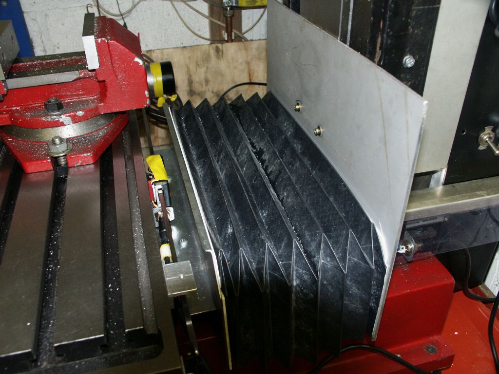

      Hi I am in the process of rebuilding a Ajax AJT1 milling machine and I am after some bellows to cover the slides, the machine is similar to a Bridgeport just bit larger. I was wondering if anyone can suggest a supplier for these ? I have spoken to arceuro trade who sell a few but they could not help with what I want.
      anyone got any other ideas ?
      cheers Darren.

            Les Jones 1
              @lesjones1
              Hi Darren,
              If you can't find any ready made bellows you could try making some yourself. I made some from damp proof course material for my X3 mill.
              These have been in use for a couple of years now.
              Les.

                  #110403
                  Gray62
                    @gray62
                    On My AJT4, I used a piece of butyl type pond liner between the back of the be and the top of the column ways, been there for a couple of years and still ok. I've got some left somewhere if you want a piece for the cost of postage. PM me the size and I can sort some out for you.

                          #110440
                          John Stevenson 1
                            @johnstevenson1
                            Got the big set of bellows from ARC on my bridgeport, not fitted them just dropped them over the back.
                            impressions, keeps a load of crap off the ways but because they have not been cut and fitted stuff still get in at the corners.
                            My fault needs to be fitted correctly and it would stop that.
                            They are wearing well except for steel chips sticking to the bellows, not as bad as it sounds as they do brush off and are not buring thru but I do use this machine in anger, it's a paying workhorse and big cuts with decent inserted cutters are the norm.
                            Light cuts with steel brush off as does alloy etc. In a home shop I suspect the life span is a fair few years, in my industrial shop probably two years and they will start looking tatty.
                            Hope this is a truthful answer.

                              Darren Heaver
                                @darrenheaver21118
                                I have been look at the ARC ones and I think I might go with the same idea as John suggests to use the larger ones as the AJT1 is not that much different to the Bridgeport and fix then using a custom plate to the top of the colour and top of knee, then to the back of the main saddle in the same way might order a couple to have a play cheers
