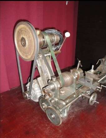

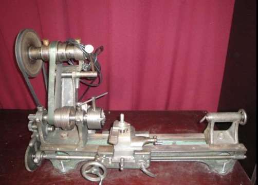

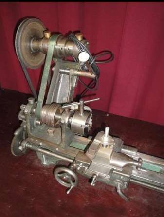

                            dcosta
                              @dcosta
                              Hello Siddley.
                              I found in an auction in a Portuguese site the following pictures of a lathe and the owner is asking as a starting value 500,00€. It will be sold for the best bid.
                              Don't know the maker but it looks to me as an English machine…
                              Don't know where in Spain you live but perhaps it's not too distant from Portugal to consider…
                              If you are interested please let me know and I'll send to you the URL address.
                              Best regards
                              Dias Costa
