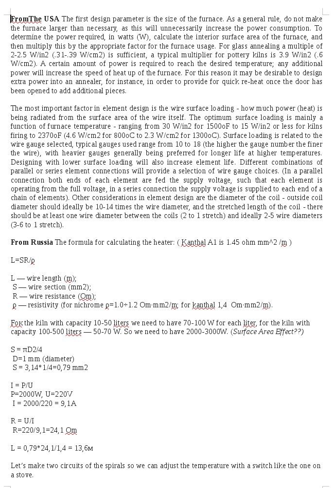

      I've been working through the design of a small electric furnace. It's looking reasonable for a chamber with an 8" square base that is circa 10" tall. The cheap kanthal wire I have found looks a bit dodgy at 1300C but should be ok a bit lower. Two questions hoping some one else has done something like this.
      I'm going to wind my own elements and intend to do it on a lathe and wonder about tensioning as it seems to be pretty springy stuff. I intend to screw cut a mandrel to the pitch I need or use all thread and then stretch as needed.
      I have 2 options on the element carrying sides. Cut up insulating bricks or make them from castable refractory. A lot of the heat up time in these is caused by the bricks so I wonder just how thin they could be if the bricks were cut down or made from the castable. I intend to use ceramic blanket for most of the insulation.
      Another option for these might be ceramic board, RFC. It's semi fluffy stuff but is seems that it can be routed or cut with a knife. I believe it can be hardened using a silicone colloid but can't really find any info on what that involves in practice. Sounds better than other options as it's thermal mass is lower. Pricey though.
      winkYeh I know propane is easier and quicker for smelting aluminium. And also that the furnace would be much easier to build.

                Ajohnw
                  @ajohnw51620
                  Myfordboy on youtube has some pretty comprehensive video's on making furnaces including oil burning. He also shows a method for vibrating the casting which the materials used need to get rid of air pockets etc and assure it's all well compacted.
                  Things may have changed in respect to small electric kilns/furnaces. There seems to be some about now that heat up very quickly. There are calculations about but they assume a certain rate of heat loss against temperature. This sets the power needed. I'd guess that the calcs are based round a single layer of ordinary insulating brick and very little else so if I add more that also has less thermal mass the elements may burn out due to overheating.
                  One person seems have got round the overheating problem by using a cheap triac controller ahead of the main temperature controller so just turns a knob to limit the max power the controller can provide. It sounds like it should work but I'm inclined to try and make it easy to fit more elements in series to reduce the max power or start with too many and remove as needed.
                  From the electric "cigarette" brigade it seems that kanthal can be annealed by heating to orange heat. There is some info about on winding furnace elements that use a turn or so round a reel to provide the tension but I suspect that will harden the stuff again. That method is a bit like wrapping a turn of electronic hook up or copper wire round a terminal screwdriver and pulling it to straighten out kinks and bends. I have wondered about winding it around a mandrel, keeping it tight and then heating the lot up with a propane torch. Tension via blocks of wood might be a decent idea.
                  As to calcs there isn't much about and zero on constructing small commercial ones that heat quickly. Potters can't be keen on saving the planet. One kiln is being sold on ebay at the moment – outside got so hot it started a fire. This is all I have managed to find on the sums for normal types. I suspect it would be a good idea to check the actual resistance of dubious kanthal wire.
                  Interesting thought at the end of the Russian offering.
                  There is plenty of talk about not using the cheap elements from China off ebay. It might be possible by buying ones that state 2 or 3 times the power needed and using them in series. The surface loadings are far to high used as they are listed.

                          Kanthal is a brand name. Most of the wire that is around seems to be described as kanthal like now. The same sort of alloy. People do phone suppliers and ask for elements to be made and they will do that but it can result in more grief when in real terms there is no easy way of determining what wattage will be needed. If I did that I would go for a lower wattage than I think I need that could be shortened to increase it if needed without upsetting the surface loading figures to an unacceptable level. Those set how long the element is likely to last.
                          Anyway i have bought the wire which cost me £11 and am thinking in terms of 2kw. The sums suggest that is around 30% more than needed. I could reduce that by extending the length of the element using the same wire. The wired came in the form of 5 10m spools and each spool should be ok for 1kw with 120v across it so 2 should be ok for 240v and plenty left to add more if needed. wink It was a buy 4 and get one free deal. I have seen the real thing at £1.79 per m but don't want to spend much until I know it will work.
                          The lower temperature range low density bricks seem to have better thermal insulation properties but kanthal needs one grade up from those really. These are usually listed as 1400 to 1500C, or grade 26
