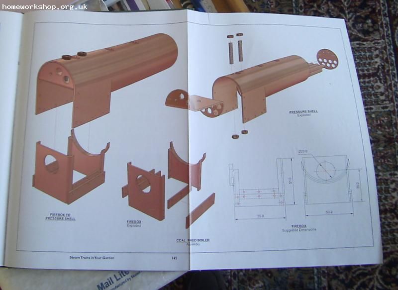

                Just saw this book for sale, something like the boiler shown would be a far better bet, about the same size at around 50mm dia.
                Edited By JasonB on 27/10/2015 15:48:51

                        Neil if that Tick were made from 3mm thick 50mm dia steel it would have a grate of 25x 50 and the amount of radiant heat from the fire if you could keep it going would be so small. The one I mentioned earlier is this.
                        #209559
                          I wasn't suggesting scaling down Tich, just that its grate was similar in size to one for a 45mm diameter boiler.
                          The one in your drawing is effectively a Briggs.
                          N.

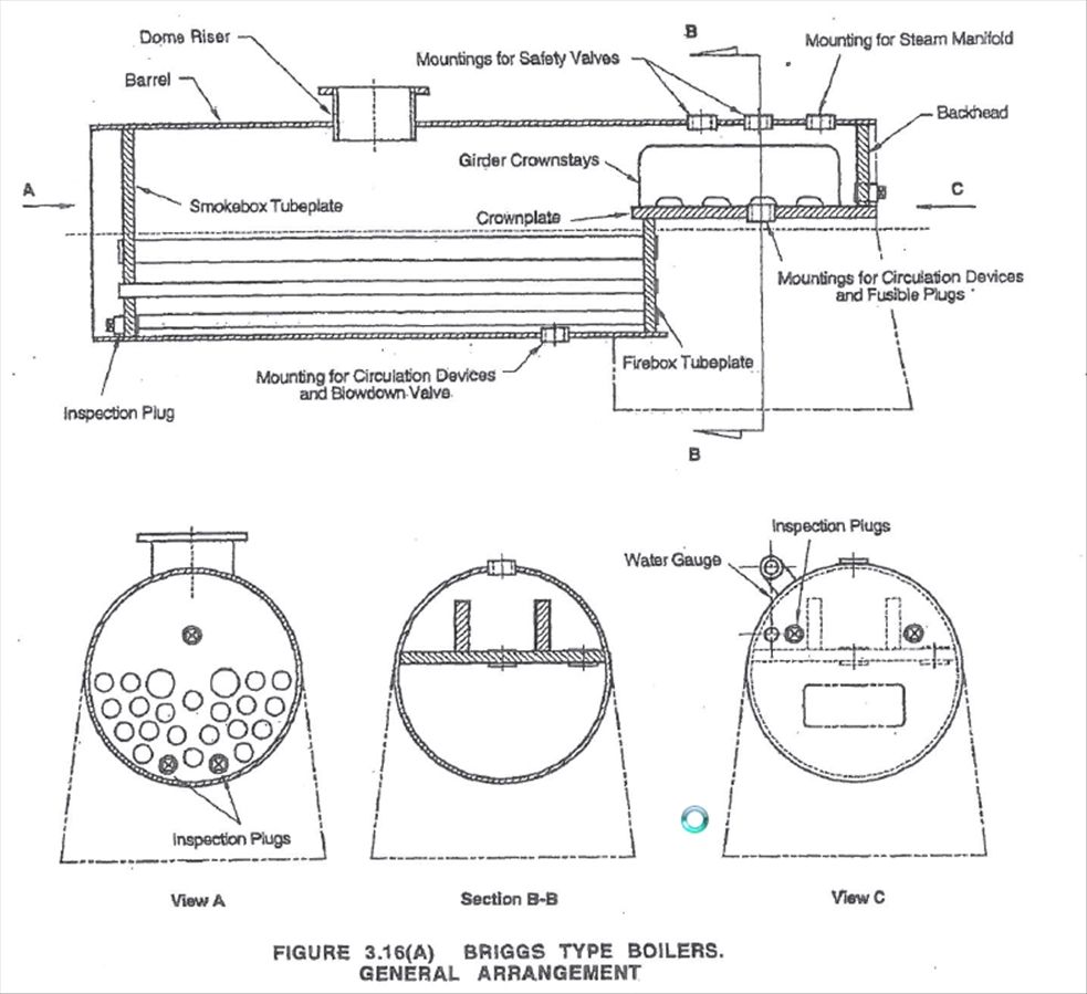

                          #209568
                          Paul Lousick
                            @paullousick59116
                            A typical Briggs boiler
                            #209586
                              Worth noting two things: the Briggs can be improved with circulation tubes in the firebox and that the firebox needs to be insulated well (including the backhead), which adds significantly to its external dimensions.
