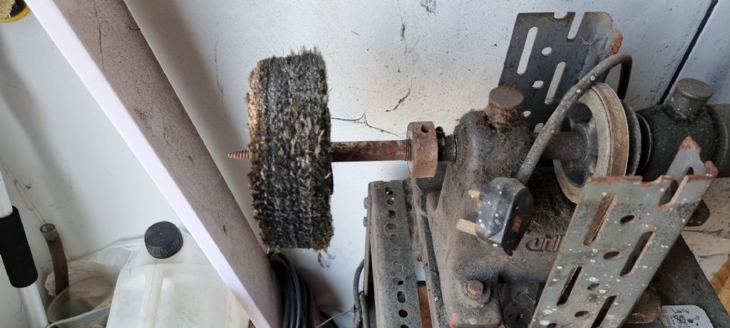

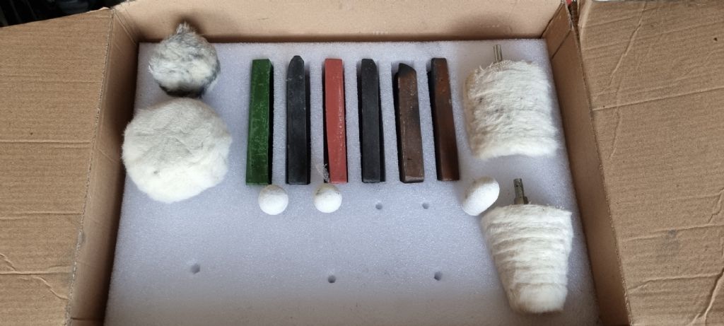

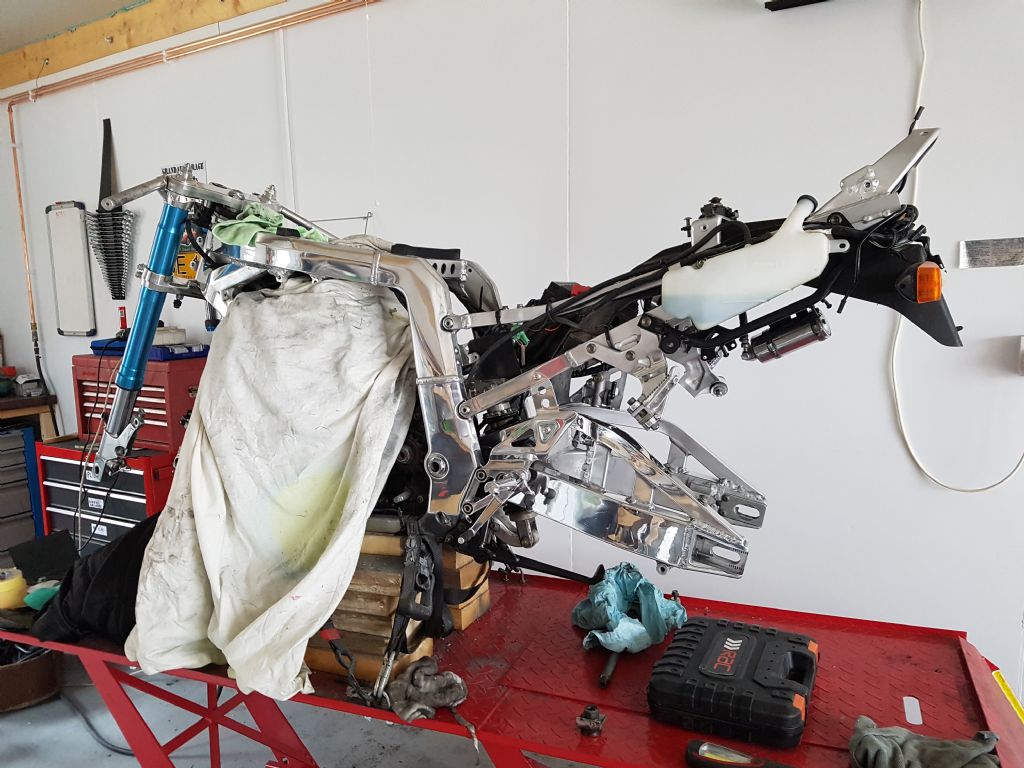

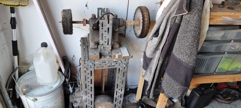

            I have this old home made buffing setup that i was given many years ago. Powerful & great to use. A must is a face screen or your mush will itch for days. See pictures, buffing medium is not expensive & bought from local car accessory shop. As above the wheels are different. My left one has nylon stitching through it , which gives it an abrasive effect. The right one is a cotton one for final polishing. Last pic is the bike i started doing & has been stood for the last 2 years. I must finish it.

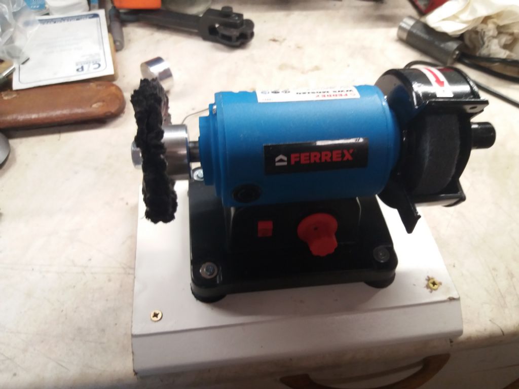

              Hi Alan I set up a small polishing machine made from a small grinder from Lidl. The mops I use are from Cromwell tools as a kit . It includes three diferent grades of buffing compound and three mops for each grade. When polishing it depends on what you are polishing and the detail etc. It is a very dusty and dirty so you should be prepared for dust extraction, goggles and catching escapee parts. I quite often Finnish with Solvol Autosol metal polish to Finnish with as well. The Lidl grinder is just big enough for me for the small parts and cutlery that I polish. I had to make a new pair of wheel washers to allow them to grip the mop correctly.20190803_081636.jpg

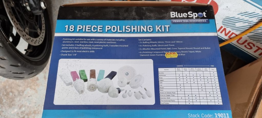

                        Posted by alan ord 2 on 30/03/2021 20:01:58:
                        Thanks all for your advice. Much appreciated. Hopper / David, I hadn't thought about the black mess etc.!!! I'm sure I would have realized as soon as I started to use it. Will use a face visor in addition to a mask and have a screen behind.
                        Steve, are the polishing compound colours standard. I did buy a small tester set from Machine Mart and they had the same colours.
                        Alan.
                        Yes different colours for different materials. If you can blow up the pic of the box, you will see a list of what the colours are for. Hang on i'll take a close up shot….
                        Steve.
