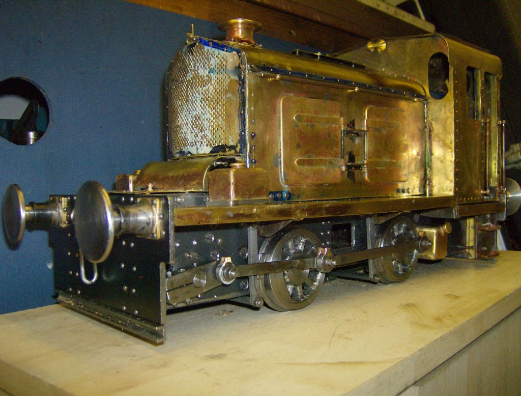

                  #96561
                  Sub Mandrel
                    @submandrel
                    I'm sure Michael W's suggestion will give excellent results
                    I just took one angled cut then blended in with a file.and got this result:
                    Getting there 1
